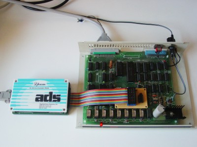

There are still commercial EPROM emulators available, but most of them seem to target the automotive market and tend to be expensive. An low-cost EPROM emulator with USB like the one presented here is a great idea.
I bought my EPROM emulator, the "DPROM 2" from Applied Data Systems, around 2002. I got it on eBay for next to nothing, back when they were somewhat common there. The device itself was made in the early 1990's. Inside, it has a PIC microcontroller and SRAM that is battery-backed. I have replaced the battery twice. It has an RS-232 interface and receives data in Intel Hex format.
In the years that I've owned it, I've made a variety of adapters for it, like the one pictured below. The target system uses two 2716s but the adapter makes it look like one 2732 for the emulator. I've used the emulator on every 6502 SBC that I've made along with various other systems.
The computer I use these days doesn't have an RS-232 port so I use an FTDI US232R-100. It takes about ten seconds to upload a 8K image (2764) into the emulator. Going from a burn/erase cycle of 5+ minutes down to 10 seconds really changed the development experience for me. I also used to have a small pile of EPROMs that I would cycle though so I wouldn't have to wait for the erase, but it was still inconvenient to have to swap the chips. I'm hooked on the emulator and don't think I could go back.
How are the rest of you programming the ROM on your machines? Are you still burning EPROMs, using a ROM emulator, or something else?
File comment: DPROM 2 Eprom Emulator

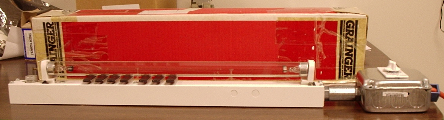

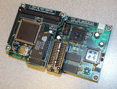

I continue to do it the old-fashioned way: 27C256 EPROMs (55ns parts), an EPROM burner, and my "state-of-the-art" EPROM eraser I hacked together some 27 years ago. The unit on which I am testing the code gets a ZIF socket plugged into the EPROM socket for quick and painless chip swaps. It takes about 10 seconds to burn and verify an EPROM and less than a minute to swap a fresh EPROM. Fifteen minutes are required in the eraser, which can erase 20 EPROMs at a time.
File comment: "State-of-the-Art" EPROM Eraser

File comment: ZIF Socket in EPROM Socket

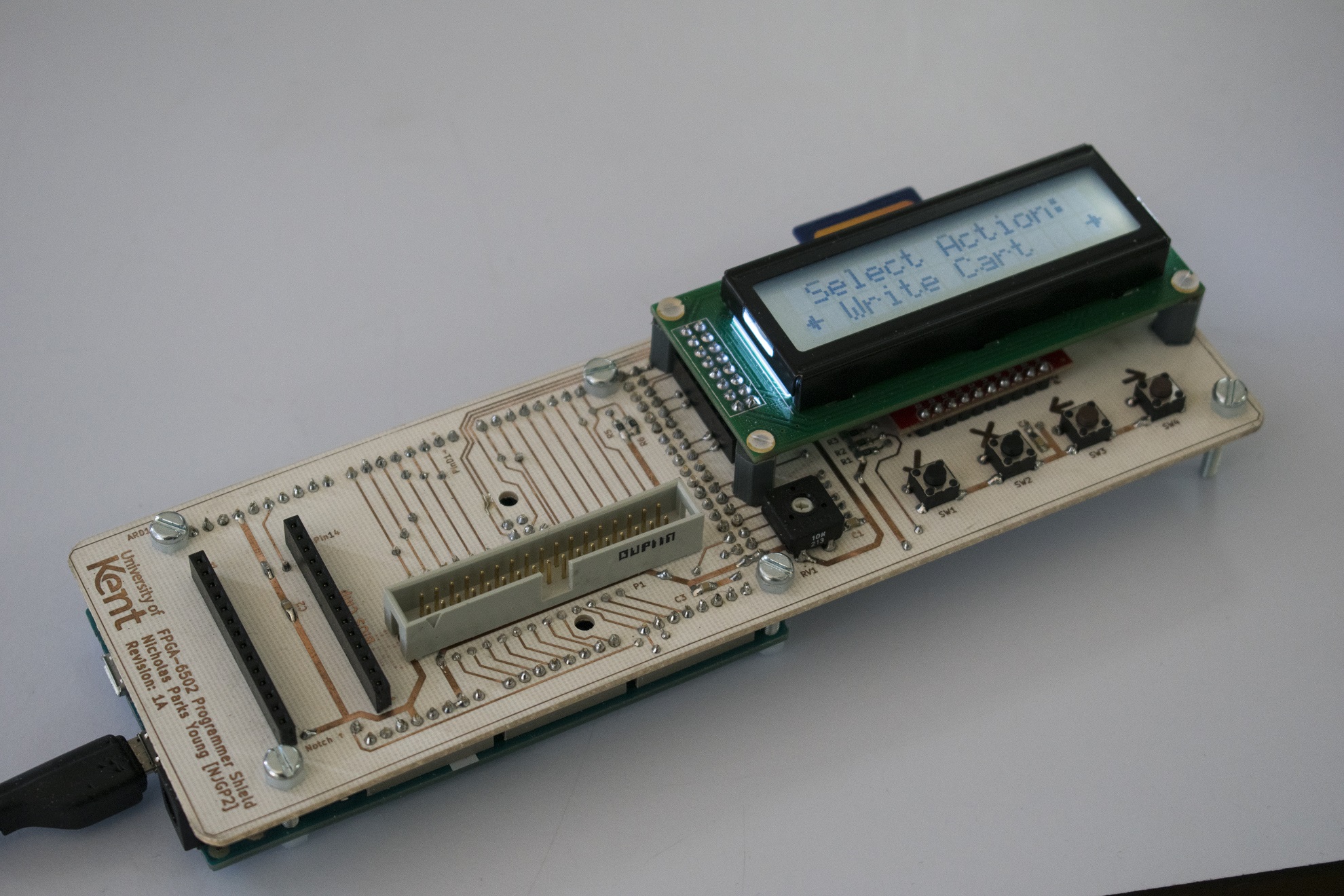

I built a custom ROM Programmer for my project, built around an Arduino Due. It can write to 28BV64 EEPROM chips, either a single one on its own (left socket) or using the "cartridge" connector (bottom middle). Source files can be plain binary or motorola S-Record, and are obtained from an SD Card you plug into the back with your files on. Because it grabs the files off SD card, it is platform indepedent. It can also erase chips or dump the contents of a chip to the SD Card.
