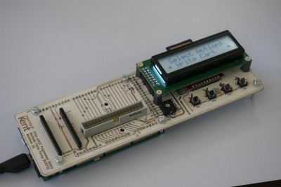

I built a custom ROM Programmer for my project, built around an Arduino Due. It can write to 28BV64 EEPROM chips, either a single one on its own (left socket) or using the "cartridge" connector (bottom middle). Source files can be plain binary or motorola S-Record, and are obtained from an SD Card you plug into the back with your files on. Because it grabs the files off SD card, it is platform indepedent. It can also erase chips or dump the contents of a chip to the SD Card.
