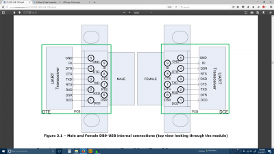

I have the male five volt version of this:
http://www.mouser.com/ds/2/163/DS_DB9-USB-15654.pdf
Page 9 shows the wiring scheme. I believe I am correct to not need a null connection.
Plus, my out going data works perfect. I do not have any serial echo enabled either.

Posts: 276
Location: Lynden, WA
Look at the datasheet I posted. I have the MALE 5v part. I really don't think I need a null modem connection. It also shows the female part, which is shown connected with opposites, a la null modem. Also, I get perfect behaviour when I send stuff to the terminal.
The thing I am doing to try and get data out of the terminal doesn't even involve the ACIA. I'm just trying to see activity on the pin of the adapter that goes to the RxD pin of the ACIA, by sending stuff from the terminal.
I can't get so much as a wiggle on the scope this way.
I have read the RS232 primer more than once. It is very helpful indeed.
Thing is, I don't even know if what I am trying SHOULD work. But I feel it should.
Here is my set up. I have my FTDI adapter hooked to the ACIA as shown in the datasheet for the MALE part. I've posted thediagram from the datasheet.
I only have the TxD, RxD, DTR, and GROUND pins hooked up. I have CTS grounded onthe ACIA. I have the CTS pin on the adapter also grounded.
I have a scope probe on the RxD pin on the adapter. As per the datasheet, this get connected directly to the RxD pin on the ACIA, so I would expect that when I sen data from the terminal, I would see activity on this pin.
When I probe the TxD pin, whilst it is hooked to the ACIA, and the ACIA is transmitting, I get good data. The serial decode on my scope, and the terminal window agree, the data is as expected. If I had my RxD and TxD reversed, I feel this would not be the case.
I have handshaking, both hardware and software, turned off on the terminal.
All I want is to get activity on that RxD pin on the adapter.

Have you tried connecting the TxD and Rxd together, (no ACIA), and see if you get an echo on your terminal program ?
 Post subject: Re: RS232 line drivers
PostPosted: Fri Mar 31, 2017 4:14 am
Posts: 276
Nothing with Rx and Tx tied.
And I would expect nothing. Like I mentioned, when I hit send on the terminal, while watching the pin on my scope, nothing happens.
Lets pretend nothing is hooked to the ACIA (as was just the case in my test).
If I have handshaking turned off in the terminal, what minimum connections do I need to see data come out of that adapter's Rx pin (the pin the datasheet says goes to the ACIA's RxD pin)?

DerTrueForce wrote:
To the first and second, the pins on his adaptor plug are named wierdly. TxD on the plug is actually the data input to the plug.
That's normal - RS232 has DTE and DCE parts, the DTE is what we're most familiar witth - most terminals *and* computers are DTE, where TX is 'transmit' in both ends. Thus the null-modem cable. Modems, on the other hand, are DCE. The signals are named so that TX connects to TX, RX to RX. Think of the DCE naming as "The place where it says 'TX' is where you connect your TX signal.".

If the device fails the RxD-TxD loopback test (with flow control disabled), there's really no need to check baud rates, ground connections, the ACIA/6502, or anything else.
Either the device it's broken, or there's something not right with the PC software/driver.
