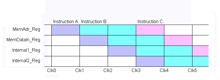

I admit I don't understand your diagram (above). Can you choose a typical instruction (such as LDA abs, perhaps) and describe how it would execute? (Your English is just fine, BTW! :) )
I know that there are several pipeline stages, of course. I guess what I'm missing is exactly how the instructions overlap.
I took the diagram below from another thread, so it's not 100% appropriate. But it does show four pipeline stages, with multiple instructions making their way through. Do your plans specify this kind of detail -- how instructions will overlap -- or is that part yet to be determined?
