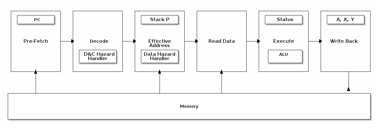

Hello guys, it's me again :mrgreen:
This is a big day for me, because I'm releasing a source code of mine in public place. I hope you guys forgive me for the delay between the opening time of the topic and the release time of the code. This is pipelined 6502 source code.
Well ... good news first:
1. The code is completely synthesizable (I did post-synthesis simulation with Vivado toolsets successfully. But I did not have any FPGAs to test the code.)
2. I did some comparison with the native 6502 model (I took Arlet's model as a reference), it seems that the new processor can outperform up to 40% sometimes. (But still I need to study much much much more about this claim)
Now bad news:
1. I had to change the architecture so I just got rid of caches.
2. I did not pass any testing suits yet, so please help me to do so. :oops: :(
3. The memory which is working with this CPU is very special. It has 4 Async read ports and 1 sync write port. I think this will make the processor very slow (what do you think guys?)
BTW you can think of this code as a working MODEL not as a REAL 6502 (not yet!!!).
Looking forward to read your comments.
thank you all for encouraging me to finish this hard project.
M. A. Nili
P.S. I have written the Verilog HDL code in TextWrangler editor on macOS. So I don't know what would happen if you open the source code in other editors!
P.S. Again sorry for my bad english! :mrgreen:

hi, manili. Nice to see you're persevering with this very challenging project.
I admit I don't understand your diagram (above). Can you choose a typical instruction (such as LDA abs, perhaps) and describe how it would execute? (Your English is just fine, BTW! :) )
I know that there are several pipeline stages, of course. I guess what I'm missing is exactly how the instructions overlap.
I took the diagram below from another thread, so it's not 100% appropriate. But it does show four pipeline stages, with multiple instructions making their way through. Do your plans specify this kind of detail -- how instructions will overlap -- or is that part yet to be determined?

The 6502 address space is small enough that it doesn’t really need caches, the ram in a PLD can be used directly. But if using external ram resources retaining the caches would be a good idea. The long term goals for the project might dictate inclusion / exclusion of caches.
On a clock by clock comparison the core may be faster but there is also likely a lower fmax for the more complex core. Does the 40% faster take into consideration fmax comparisons ?
I think you are correct with bad news #3 point. Having five port ram to interface to along with bypassing logic is bound to make the design larger and slower. Even if it were possible to use asynch ram directly some loss in the fmax is to be expected compared to a simpler design.
Real memory resource in many PLD’s (FPGA) is synchronous hence more pipelining complexity must be added to make use of it in a single cycle. Using two clock cycles to access the RAM would defeat the purpose of an overlapped-pipelined design.

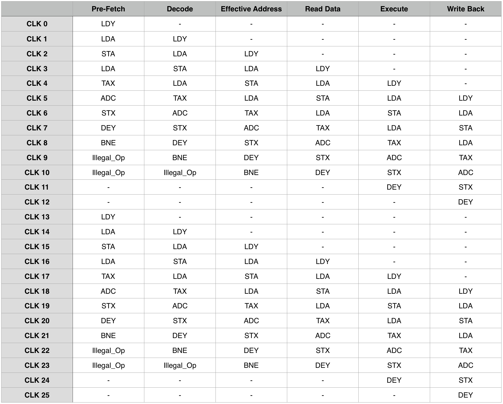

@Dr Jefyll
Thanks for your reply. I didn't understand your problem. Do the following example help you?
One of my tests during this project was Fibonacci series generation test. So here is the Verilog code:
      MEM[32814] = `LDY_IME;
      MEM[32815] = 8'h07;
      MEM[32816] = `LDA_IME;
      MEM[32817] = 8'h00;
      MEM[32818] = `STA_ABS;
      MEM[32819] = 8'h03;
      MEM[32820] = 8'h00;
      MEM[32821] = `LDA_IME;
      MEM[32822] = 8'h01;
      MEM[32823] = `TAX;
      MEM[32824] = `ADC_ABS;
      MEM[32825] = 8'h03;
      MEM[32826] = 8'h00;
      MEM[32827] = `STX_ABS;
      MEM[32828] = 8'h03;
      MEM[32829] = 8'h00;
      MEM[32830] = `DEY;
      MEM[32831] = `BNE;
      MEM[32832] = 8'hF6;
Now this is how the processor behave during the execution of the program.
Remember I used the assembly symbol inside the picture (not the Verilog macros).
