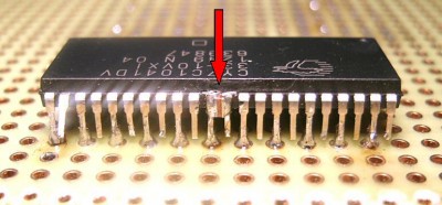

I did have some thoughts about AC performance issues, though. If someday you're gonna do another batch of RAMs -- or if anyone reading this faces a similar wiring challenge -- then you might want to consider the oft-heard advice about keeping capacitor leads as short as possible. The ultimate is to use surface-mount caps instead.
With that other cap of yours removed we see two places where a surface-mount cap could reside.
For mounting right against the IC it's best choose caps that are wider than they are long.

Hey, thanks for the idea. I should have ordered the surface mount caps when I did these.
I shall do that on the next batch of 25 I will need for the hand wired version.
Cheers!
Brad
PostPosted: Mon Mar 13, 2017 7:15 pm
Glad you like the idea. I admit that, in a breadboard context, keeping capacitor leads that short probably doesn't yield any significant AC performance advantage. But it might reduce crowding, and will probably save assembly time, too.
As you may guess, of the two options I suggested, mounting the cap right against the IC is more finicky. In comparison, it's a slam dunk to plop an SMD between two pins on a .1" grid! :D

Ironically, I just looked in my .1uF cap drawer, and there is a roll of 1000 SMDs sitting right there!
.... next time for sure.
Brad
