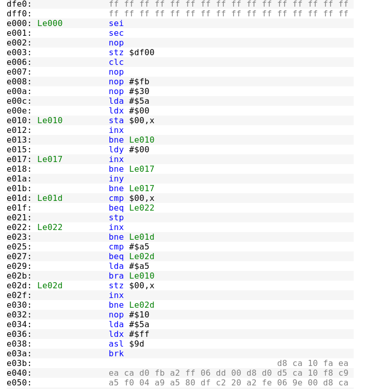

I got the NOPs in, and disassembled that 65816 binary as below. I was a little taken aback that disassembly didn't stop at the STP instruction, but the control flow does branch around it. It doesn't take too long to wharrgarbl across multi-byte NOPs into a BRK, which stops that asm trace.

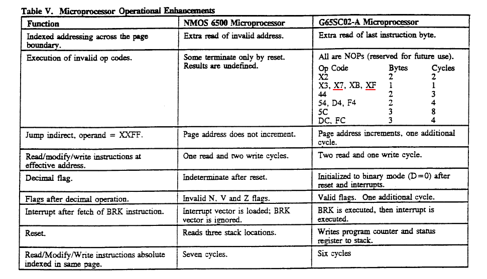

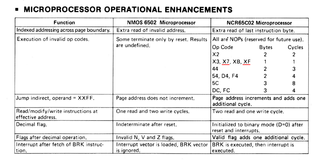

White Flame wrote:
In the 65SC02, are the addressing mode & timings for $x7 and $xF the same as the bit operations of the full 65C02, or are they 1-byte, 1-cycle NOPs? I suspect the latter
Oops -- I overlooked the newest posts when preparing this. But FWIW here's confirmation re CMD's G65c02-a and for NCR's NCR NCR65c02.

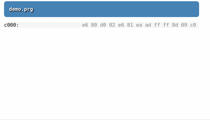

I have been making steady progress on the project. The main reason I'm pinging this thread is that a stray .htaccess setting partially broke access to the files so it wasn't being served right. That's been fixed now, if you happened to hit that issue.

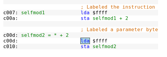

I'm happy to have "embedded" labels working now, which are rendered as offsets to a base label.
In the example, I create placeholder bytes for a zeropage vector at $80, and after labeling it any reference to $81 turns into "vector + 1" because it's contained in that labeled element. I also assign a label to the high byte of an absolute address parameter, by following the link from the STA and assigning the label there, and it displays a separate relative label.
(600KB gif)
Having added URL loading support, you can play with the same file here: http://www.white-flame.com/wfdis/#!load=demo.prg I beat this thing into submission with all the many edge cases, but feel free to flush out any more! ;)
You should be able to put a label either at the beginning or in the middle of an element, and it'll show "the right thing" both for the label and for any references to the data.

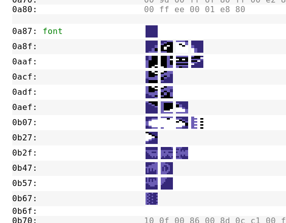

There can now be multiple graphics characters/sprites per line, though it's still a little unwieldy. There's an example with a custom font from one of my minigames at the bottom of this disassembly: http://www.white-flame.com/wfdis/#!load=invasion-full.prg.wfdis
