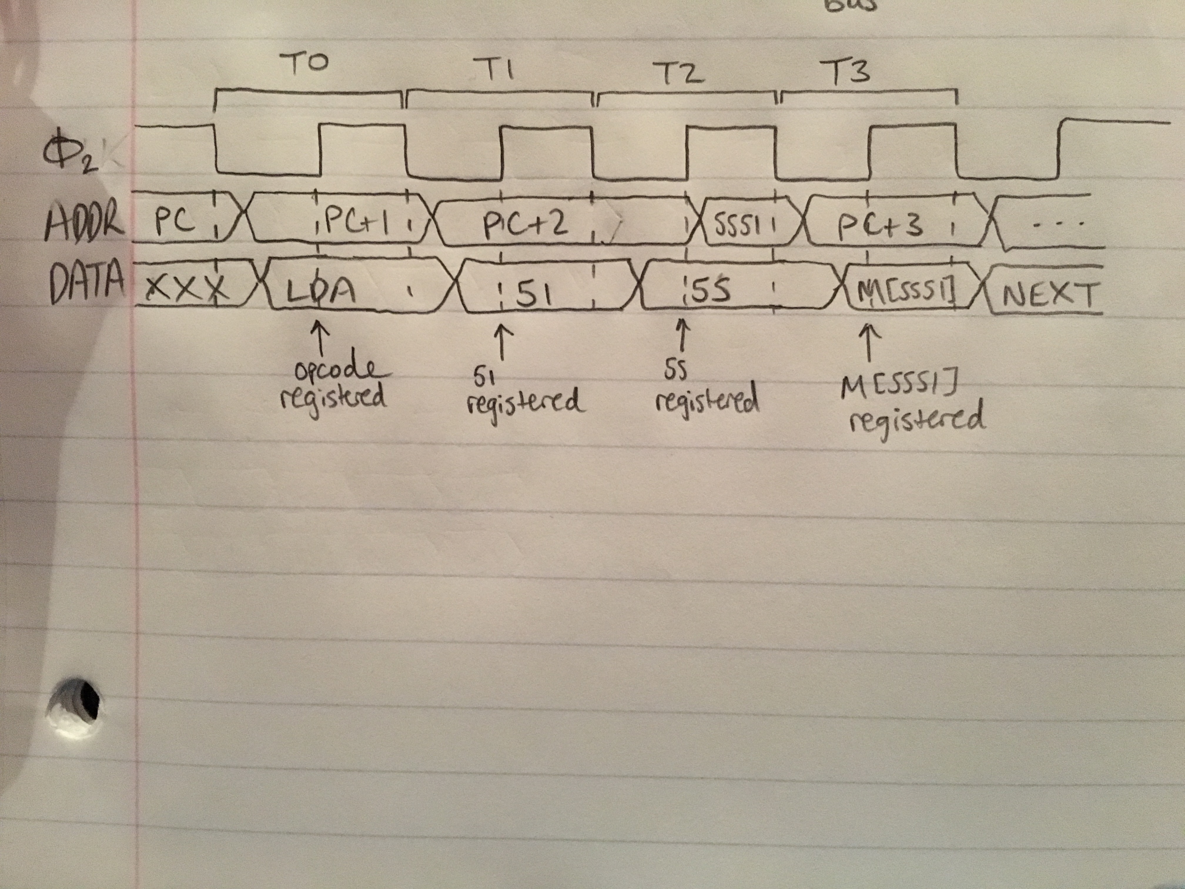

Greetings,
I'm currently working on implementing my own 6502 in a Xilinx Spartan 6 LX9 FPGA. I've been studying the hardware manual and various other resources online, but one thing I'm struggling with is the timing for instructions. For instance, I'm looking at the timing for absolute addressing in the A-3 of the hardware manual. I don't understand how data from a corresponding address is coming back from memory in the same clock cycle that that address is put on the address bus (hope that makes sense). Isn't there a 1-cycle read latency? If so, shouldn't an operation like LDA with absolute addressing take 5 cycles, not 4? I've attached an image of a timing diagram showing how I think it should work, which should hopefully help anyone reading this diagnose my misunderstanding.
On a related note, I'm wondering if there will be any game-breaking discrepancies in my design and the timing diagrams found in the appendix A of the hardware manual due to the fact that I'm using edge-triggered D flip-flops and a single clock, as opposed to latches and a two-phase clock, as is used in the original 6502 design.
Thanks in advance for any help you can provide!

LDA abs takes four cycles. The memory typically used is asynchronous (and also truly random-access). It has no clock input. As long as you meet the timing requirements for address, chip select, and output enable (and write enable, if you're writing), it doesn't care what you want to call a cycle. 10ns memory can deliver the data 10ns after the address and select are valid, regardless of your clock speed. On reads especially, the memory is basically combinatorial logic; so it's just a matter of how fast things can ripple through, with no clock.
In your diagram, also flip the clock shown. Your rising edges should be falling edges, and vice-versa. The first half of the cycle is when Φ2 is low, and the second half is when it's high. Right after it falls, the next address is put on the bus.

In regard to your last point, if CLK were Φ1, it would then be correct to show the address changing on rising edges of CLK, right? Since the two clocks are essentially complements of each other (with some additional wiggle room, I've gathered from reading, to ensure no overlapping). I'm curious about this since I'm modifying the design to use one clock instead of two, and I'm wondering if I can get away with this.

Welcome! You've got a good example there of the 6502's design style - it does indeed get more performance than you'd expect, in that data arriving on the data bus towards the end of one cycle can be output on the address bus early in the next cycle. You can do that on FPGA but you will have to pay attention to where you put your clock boundaries. Arlet's core manages to keep 6502 cycle counts, I think, even using synchronous memory. See
viewtopic.php?f=10&t=3453
You surely can clock a 6502 design on a single clock. By convention, we always use phi2 in 6502 land, and so you would be clocking on the falling edge. (Indeed, it's common to clock on a falling edge anyway, as pulldowns are stronger and falling edges are better defined.) In your diagram, you're using phi1, which is as you say logically equivalent, but is unconventional.

For the 6502 there isn’t a read latency because as Garth says the memory used is asynchronously accessed. That means data coming in from the ram can be latched as the next address for the next clock cycle because the RAM isn’t waiting for a clock. The 6502 designers choose to use a longer clock cycle time in order to do things like this to reduce the clock cycle count for instructions. The 6502 is a little unusual in that it latches data on the negative clock edge rather than the positive edge. The 6502 has a slower clock than some other eight bit micros, but it does more work per clock cycle.
There are a few different ways to work around the asynchronous vs synchronous ram issue. One would be to use two clock cycles for every equivalent 6502 clock in order to read the ram. There’s one 6502 emulator that uses four clock cycles per 6502 clock for instance. As long as the multiple is fixed, cycle counted games should still work.
If using the block ram in an FPGA asynchronous memory can be simulated by using the opposite (negative edge) of the clock while reading. Dual port rams would allow writing at the positive edge while reading at the negative edge. Another option is to use a board with external asynchronous ram available. Using external asynchronous ram is bound to be slower than using block ram.

I've attached a new timing diagram to this post. Now, CLK is labeled Φ2, and I'm changing the address on falling edges. As suggested, I'm showing how I might use a synchronous FPGA block RAM as a pseudo-asynchronous RAM by clocking data out of the synchronous RAM on falling edges and capturing that data in a register on rising edges.
I have to break convention to perform the LDA instruction in 4 cycles because, as shown in the diagram, I change the address during T2 after a rising edge as opposed to a falling edge. This allows me to capture the data from the appropriate memory location in a register during T3.
Does this seem like a reasonable approach to keeping the cycle count the same between my FPGA design and an actual 6502 IC?
