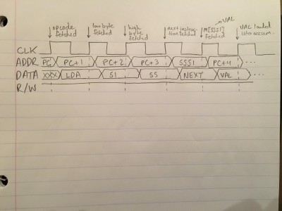

Greetings,
I'm currently working on implementing my own 6502 in a Xilinx Spartan 6 LX9 FPGA. I've been studying the hardware manual and various other resources online, but one thing I'm struggling with is the timing for instructions. For instance, I'm looking at the timing for absolute addressing in the A-3 of the hardware manual. I don't understand how data from a corresponding address is coming back from memory in the same clock cycle that that address is put on the address bus (hope that makes sense). Isn't there a 1-cycle read latency? If so, shouldn't an operation like LDA with absolute addressing take 5 cycles, not 4? I've attached an image of a timing diagram showing how I think it should work, which should hopefully help anyone reading this diagnose my misunderstanding.
On a related note, I'm wondering if there will be any game-breaking discrepancies in my design and the timing diagrams found in the appendix A of the hardware manual due to the fact that I'm using edge-triggered D flip-flops and a single clock, as opposed to latches and a two-phase clock, as is used in the original 6502 design.
Thanks in advance for any help you can provide!

LDA abs takes four cycles. The memory typically used is asynchronous (and also truly random-access). It has no clock input. As long as you meet the timing requirements for address, chip select, and output enable (and write enable, if you're writing), it doesn't care what you want to call a cycle. 10ns memory can deliver the data 10ns after the address and select are valid, regardless of your clock speed. On reads especially, the memory is basically combinatorial logic; so it's just a matter of how fast things can ripple through, with no clock.
In your diagram, also flip the clock shown. Your rising edges should be falling edges, and vice-versa. The first half of the cycle is when Φ2 is low, and the second half is when it's high. Right after it falls, the next address is put on the bus.

In regard to your last point, if CLK were Φ1, it would then be correct to show the address changing on rising edges of CLK, right? Since the two clocks are essentially complements of each other (with some additional wiggle room, I've gathered from reading, to ensure no overlapping). I'm curious about this since I'm modifying the design to use one clock instead of two, and I'm wondering if I can get away with this.

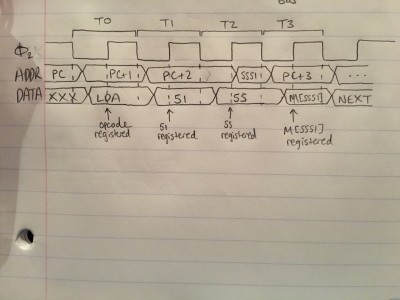

You surely can clock a 6502 design on a single clock. By convention, we always use phi2 in 6502 land, and so you would be clocking on the falling edge. (Indeed, it's common to clock on a falling edge anyway, as pulldowns are stronger and falling edges are better defined.) In your diagram, you're using phi1, which is as you say logically equivalent, but is unconventional.

For the 6502 there isn’t a read latency because as Garth says the memory used is asynchronously accessed. That means data coming in from the ram can be latched as the next address for the next clock cycle because the RAM isn’t waiting for a clock. The 6502 designers choose to use a longer clock cycle time in order to do things like this to reduce the clock cycle count for instructions. The 6502 is a little unusual in that it latches data on the negative clock edge rather than the positive edge. The 6502 has a slower clock than some other eight bit micros, but it does more work per clock cycle.
There are a few different ways to work around the asynchronous vs synchronous ram issue. One would be to use two clock cycles for every equivalent 6502 clock in order to read the ram. There’s one 6502 emulator that uses four clock cycles per 6502 clock for instance. As long as the multiple is fixed, cycle counted games should still work.
If using the block ram in an FPGA asynchronous memory can be simulated by using the opposite (negative edge) of the clock while reading. Dual port rams would allow writing at the positive edge while reading at the negative edge. Another option is to use a board with external asynchronous ram available. Using external asynchronous ram is bound to be slower than using block ram.

Yes, Φ2 is the reference for the system. 65xx I/O ICs use a Φ2-input pin and a R/W pin (rather than a RD\ pin and a WR\ pin). At least some of them also need the chip selects, register selects, and R/W to be valid some amount of setup time before Φ2 rises.

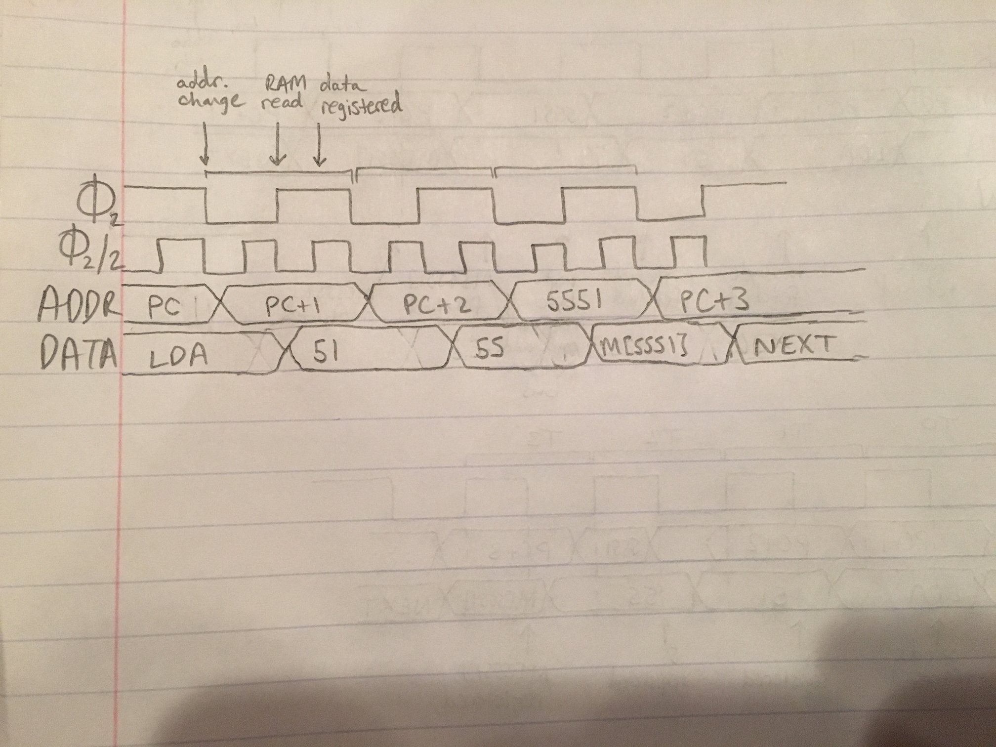

I've attached a new timing diagram to this post. Now, CLK is labeled Φ2, and I'm changing the address on falling edges. As suggested, I'm showing how I might use a synchronous FPGA block RAM as a pseudo-asynchronous RAM by clocking data out of the synchronous RAM on falling edges and capturing that data in a register on rising edges.
I have to break convention to perform the LDA instruction in 4 cycles because, as shown in the diagram, I change the address during T2 after a rising edge as opposed to a falling edge. This allows me to capture the data from the appropriate memory location in a register during T3.
Does this seem like a reasonable approach to keeping the cycle count the same between my FPGA design and an actual 6502 IC?

If you need it to be compatible with normal 6502 boards and support ICs, note that although some of those parts need the address and control lines to be valid and stable before the rise of Φ2, they will not have dished up the info you want to read until some number of nanoseconds after that edge; and when you're pushing their speed limits, that time will be not long before the fall of Φ2. WDC's 14MHz W65C22 VIA (Versatile Interface Adapter) I/O IC for example may take up to 20ns (according to the data sheet) tCDR after the rise of Φ2 to get valid data on the bus to read. The processor has a setup time tDSR (like 10ns, but it depends on the speed rating), meaning the data have to be there that amount of time before the fall of Φ2 which is the point in time where they get latched. (It can probably get a valid read with less setup time than that—it's just that it's not guaranteed for less.) Then there's a hold time tDHR of usually 10ns where the processor wants the data to remain valid after the fall of Φ2. (Again, it can probably get along ok with somewhat less, but it's not guaranteed to.) (Note that if nothing else goes to driving the bus, bus capacitance will hold the data much longer, so there's usually nothing to worry about as far as hold time goes.)
These things are of course in the data sheets' timing diagrams and charts. Jeff Laughton has some excellent to-scale animated timing diagrams showing the effects of changing the speed, at http://laughtonelectronics.com/Arcana/V ... iming.html .

I will be using exclusively block RAM for memory, internal to the FPGA, so I think this timing scheme should at least work for that application. I plan to build the whole system in the fabric of the FPGA (i.e. no external ICs). Given that, I think what I've got in the latest diagram should work, but if someone sees any holes in it, that would be great to know.

If you're going to do all your own I/O onboard as well, then you can of course do it any way you like. The 6502 uses memory-mapped I/O, so it reads and writes to I/O in exactly the same way it does to memory, with the same instructions, addressing modes, etc..

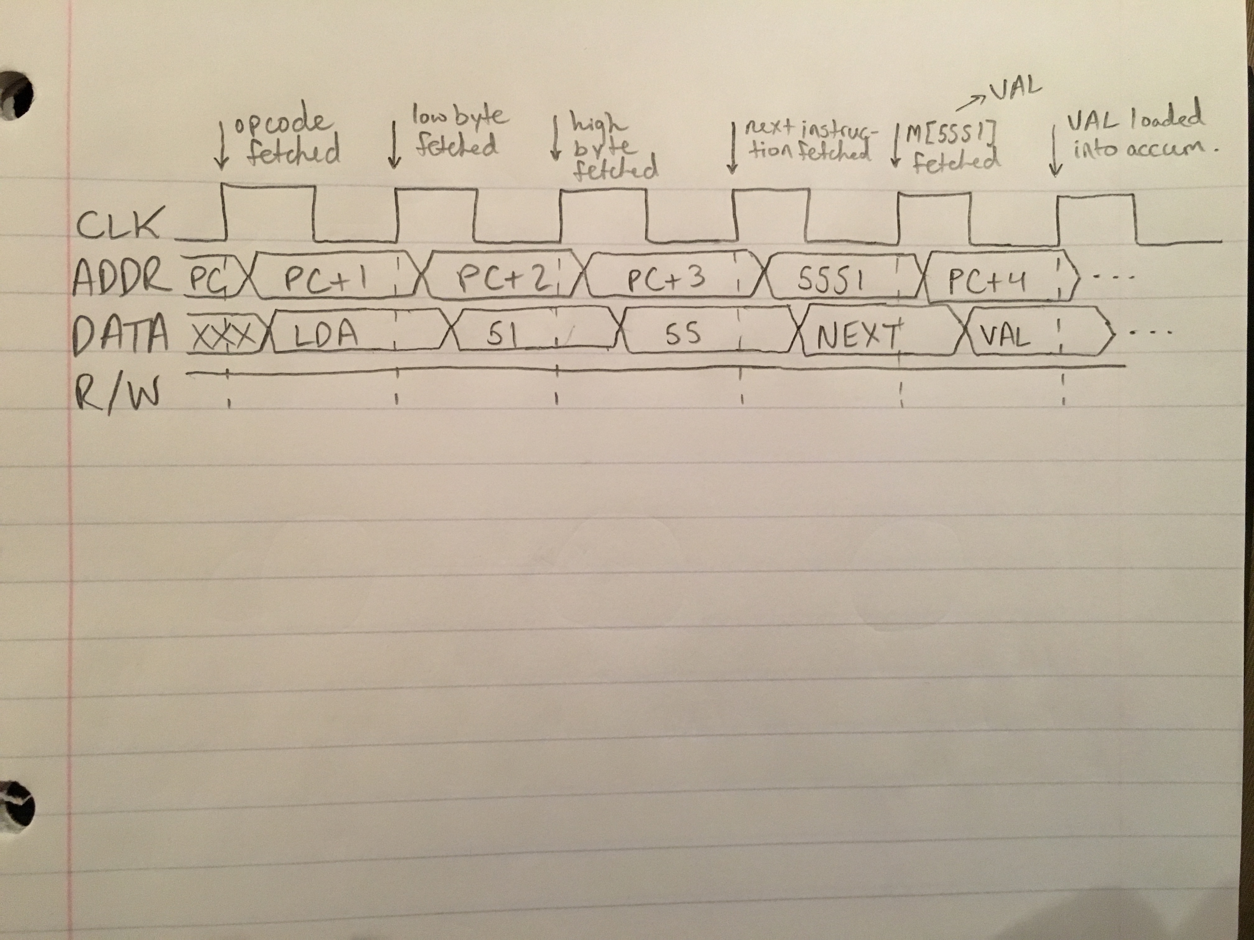

In an effort to stay as true to the original bus timing as possible, I think I've come up with a better design yet. I realize this is probably overkill at this point, since, as Garth pointed out, some of the design constraints I was concerned with are loosened (or null) because I'm doing this entirely in the FPGA. According to the hardware manual, "A Phase One clock pulse is the positive pulse during which the address lines change and a Phase Two clock pulse is the positive pulse during which the data is transferred." With this in mind, I've come up with the attached timing diagram. The address changes on falling edges of Φ2, reads from the synchronous block RAM occur on rising edges of Φ2, and data is registered from the data bus after a read midway through the positive Φ2 pulse. This is done by using a (Φ2)/2 clock that is phase aligned with the falling edges of Φ2. One of the rising edges of this clock occurs during the middle of the Φ2 pulse, and it's on that edge that data is captured in a register. This scheme 1) changes the address during the low pulse of Φ2 (AKA the high pulse of Φ1), 2) transfers data during the high pulse of Φ2, and 3) captures data a quarter of a cycle after the start of the high pulse of Φ2. The first two points are notable since they agree with the hardware manual specification, and the third point addresses Garth's note:
By waiting a quarter cycle after the rising edge to capture data, I'm simulating the wait time that would be needed for an external IC to dish up info.
Does this seem reasonable? Thanks again for all the input.
