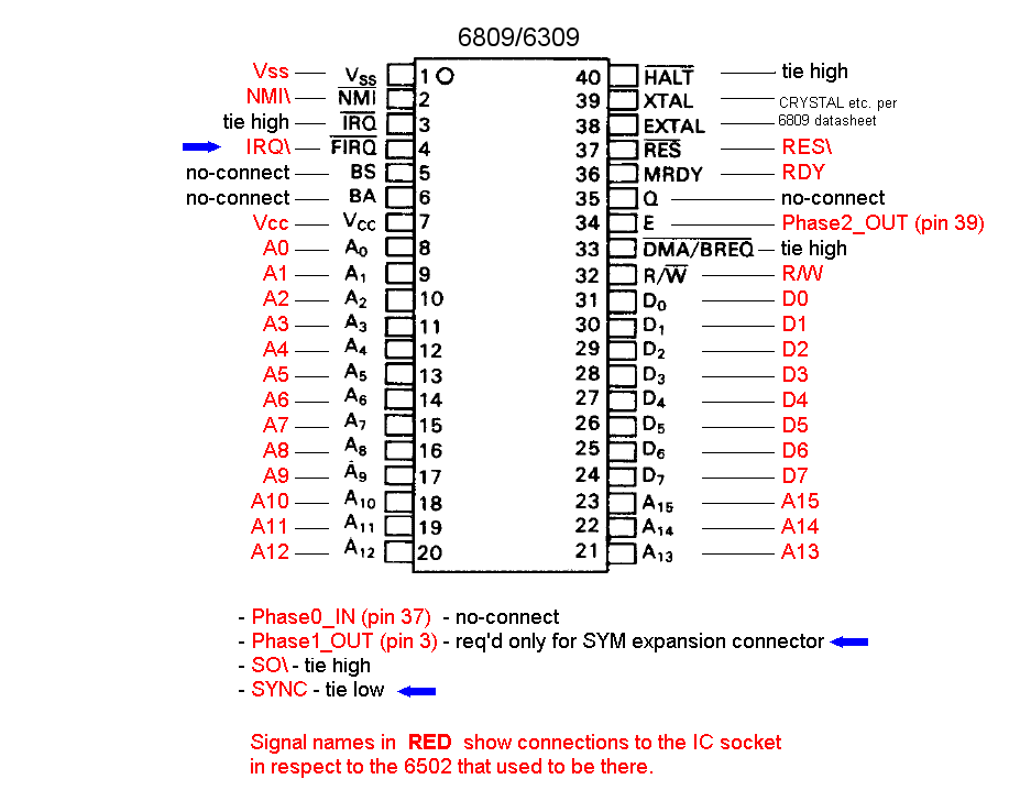

Question should have been : how to replace a 6502 by a 6809 the simplest and the easiest way ???

Alright, I can't resist looking into this! :) And the simplest and easiest path to a 6809 adapter for a 6502 computer is to omit the SYNC pin. SYM-1 makes no use of SYNC except (as with the KIM-1) for the single-instruction step function. If you're willing to do without single-step then the challenge is quite manageable. Does that seem acceptable, esarintulo? (SYNC, too, could be provided, but it'll require quite a lot more research.)
I've chosen to attach 6502 IRQ\ to 6809 FIRQ\ (which IMO is more useful than 6809 IRQ\), but the latter is also a valid choice. You'll need to remove the crystal from your SYM when the 6809 adapter is in place. The SYM-1 control section is show below (from 14MB pdf here).

The tricky part seems to be the two different clocks. They are phase shifted.
Dwight
 Post subject: Re: Sym-1/69
PostPosted: Thu Jan 05, 2017 4:13 am
Yes, a 6809 crystal runs at four times the operating frequency, and the Q clock is phase shifted as you say. But we only need E -- which my falling-to-pieces Motorola manual describes as "similar to the MC6800 bus timing signal Φ2". Moreover, I've successfully used E as Φ2 in a homebrew 6809 computer of my own. (It makes sense that they'd provide such a signal, given that 6800-family peripherals require it.)
SYNC really gives me pause, though. I'm assuming SYNC is what the extra logic (in the photo above) is for. If so, I don't know how they did it -- it's a total head-scratcher (so far). :?: :?: :)
The other stuff is quite straightforward, I'd say. (Extra pairs of eyes are always welcome, of course.)
