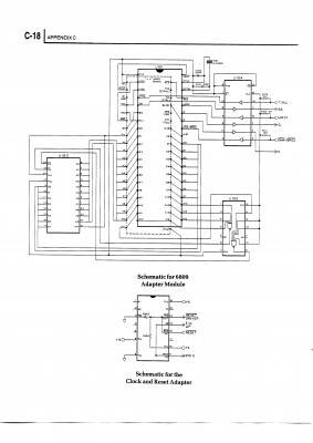

Heathkit ET-3400 had also a 6809 adapter.Looking at the Yahoo ET-3400 group,there are 3 files pertaining to
Heathkit EE-3404 6809 course.The 3rd one shows a schematic (no decoding rom there) but without identifying
the "glue" IC's.
U102 is the monitor rom and its listing is also done in the book.U101 is the 680x chip.
Someone more fluent in electronics than i am could maybe have a look there and identify for sure U103 and U104.
I own 3 of those trainers and that would be a good starting point before translating the Sym-1 6502 monitor into a 6809 one.

although i skimmed the whole web for ages,only the SYM-1 6809 adapter picture as above did surface,NO schematics and NO monitor listing AT ALL. (and,of course,nothing technical about the Sym-1/69) .
BUT the Heathkit ET-3400 (A) trainer ,powered by a 6800/6808 (rats!), had also a 6809 adapter well described in the EE-3404 course,monitor assembly beeing provided too.
In a previous life,i was an IBM software engineer with a very thin background in electronics , so ,sometimes,some circuits are beyond my understanding.
I'll try to attach the Heathkit schematics,should be not too difficult to adapt to the Sym-1. (Or ist it ?)
From what i have found,U102 is a 2716 containing the Monitor (original monitor was on a Moto 1K prom),U104 is a 74ls367 buffer and U103 is a 74ls20 to decode the 2k Eprom.The last small picture is specific to the ET3400 trainer (6800),to replace the 6875 clock generator,and not used on the ET-3400A (6808).Not needed on the Sym-1 !!
I intent to start from that schematic and adapt a minimum monitor from the Heathkit one to the Sym,as a proof of concept.
If that goes well, it then will be a piece of cake to translate the SYM-1 6502 monitor into a 6809 one.(a bit optimistic,eh (but i tourned 72,so....))
Now,from the attached schematic,if someone could provide me with a simple AND easy adapter schematic for the Sym.....
No need for the eprom decoder,i guess.
Have a nice day/evening.
Rene'.

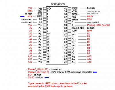

Question should have been : how to replace a 6502 by a 6809 the simplest and the easiest way ???
I'm a noob,really !!!! :shock:
Mfg , Rene'.
Posts: 3526
Re: Sym-1/69

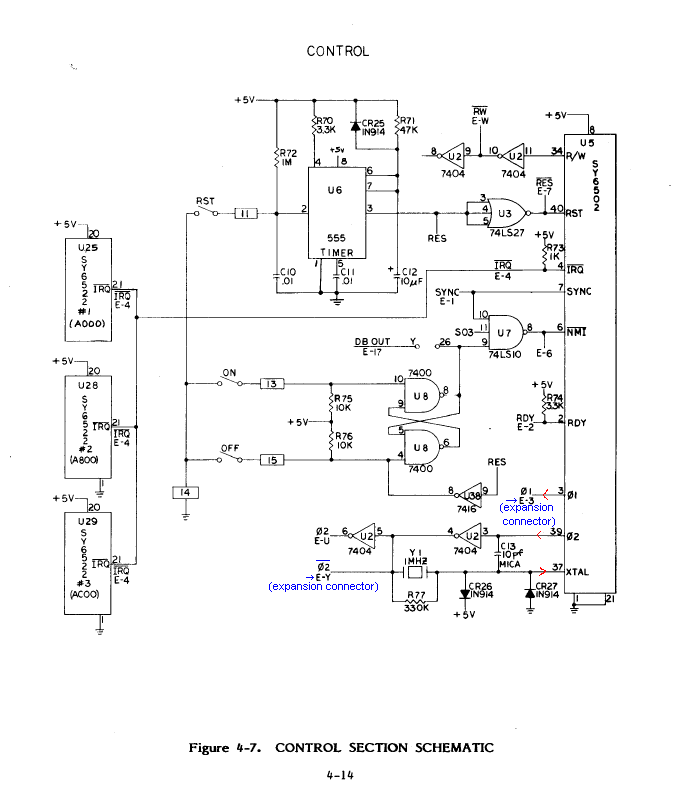

Alright, I can't resist looking into this! :) And the simplest and easiest path to a 6809 adapter for a 6502 computer is to omit the SYNC pin. SYM-1 makes no use of SYNC except (as with the KIM-1) for the single-instruction step function. If you're willing to do without single-step then the challenge is quite manageable. Does that seem acceptable, esarintulo? (SYNC, too, could be provided, but it'll require quite a lot more research.)
I've chosen to attach 6502 IRQ\ to 6809 FIRQ\ (which IMO is more useful than 6809 IRQ\), but the latter is also a valid choice. You'll need to remove the crystal from your SYM when the 6809 adapter is in place. The SYM-1 control section is show below (from 14MB pdf here).
cheers,

The tricky part seems to be the two different clocks. They are phase shifted.
Dwight
Posts: 3526
Re: Sym-1/69
Yes, a 6809 crystal runs at four times the operating frequency, and the Q clock is phase shifted as you say. But we only need E -- which my falling-to-pieces Motorola manual describes as "similar to the MC6800 bus timing signal Φ2". Moreover, I've successfully used E as Φ2 in a homebrew 6809 computer of my own. (It makes sense that they'd provide such a signal, given that 6800-family peripherals require it.)
SYNC really gives me pause, though. I'm assuming SYNC is what the extra logic (in the photo above) is for. If so, I don't know how they did it -- it's a total head-scratcher (so far). :?: :?: :)
The other stuff is quite straightforward, I'd say. (Extra pairs of eyes are always welcome, of course.)
