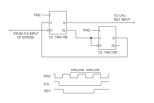

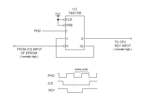

The problem is speed. The sid afaik tops out at 1mhz so im looking for a wait state circuit. I saw a circuit on here using and gate and 74 flippyflop and i simulated it ok but i really need 2 wait states but i dont want to go through the gal route. Want to use standard logic.
Im planning to use a 7.2738 xtal divided by 2 for cpu speed at 3.6mhz. 1 wait state for 1.8432mhz for I/O and 2 wait states for 0.9 mhz for SID.
Does anyone have a circuit i could use ??
Many thanks . Lee
PostPosted: Tue Nov 01, 2016 10:14 pm
Welcome! Here are circuits for one wait-state and for two. If you're the cautious type you may wish to avoid connecting the FF output directly to the RDY input of a WDC CPU. Instead, make the connection using a resistor with a capacitor in parallel to it. But some people consider a direct connection (no RC) to be satisfactory. See here for more discussion.
To use these circuits your decoding circuit must be one which causes the chip-select to go low prior to the rise of PHI2. Not shown: the /SET and /CLR inputs of the FF are unused, and must be tied high.
For initial debugging it's maybe best to have no wait-states at all (tie RDY high), and simply use a crystal that's sufficiently slow. *After* you've gotten that working you can can add the wait states and the faster crystal.
Have fun!

One 74109 appears pretty good, if the device needing wait states is the only one. But it seems, there is the need for two generators with collecting logic on inputs and outputs, i.e. 3 or 4 IC's finally.
May be you should not be so resolutely refusing GAL's?
Vladimir

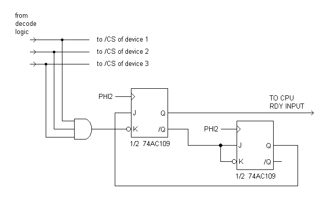

PostPosted: Wed Nov 02, 2016 2:47 pm
Hello again :)
Here's an update to the diagram, showing how multiple devices can be connected. The AND gate collects the inputs, which I think is what Vladimir was talking about.
One thing this circuit doesn't offer is various numbers of wait-states. Each I/O device that's connected will get 2 wait-states, and of course any I/O devices not connected will get none. That's not such a bad solution. Maybe 2 wait-states is more than the 68B50's require, but only a small performance loss will result. What's probably more important is having a simple circuit that's easy to understand and build.
BTW, at some time in future you may wish to install 65C22's from WDC, which are rated to be as fast as the CPU and will require no wait-states at all.
Looks like i need to investigate how to ensure CS goes low before PHI2.
I didn't mean to make it sound complicated. It's actually easier to make a decoder that meets this requirement than to make one that doesn't.
But I'm sorry to say some of your devices will require something more complex than just wait-states. I'm sorry this didn't occur to me sooner. :oops:
Using the 6522 as an example, that chip uses the PHI2 signal internally as a timebase -- to operate the timers, for instance. Although wait-states will stretch the bus accesses from the CPU, thus making them longer, that doesn't change the fact that at all times PHI2 is running faster than specified. The timers and any other internal functions using PHI2 may fail to work. This issue will affect most or all of the I/O chips on your list. (Sorry -- I'm not familiar with all of them.) It's possible you might get away with the violation of spec's, but of course that's not guaranteed.
The problem can be overcome -- the extra logic isn't horribly complex. IIRC some of the BBC computers from Acorn manage it.
I need to cut this short. Bye for now,
