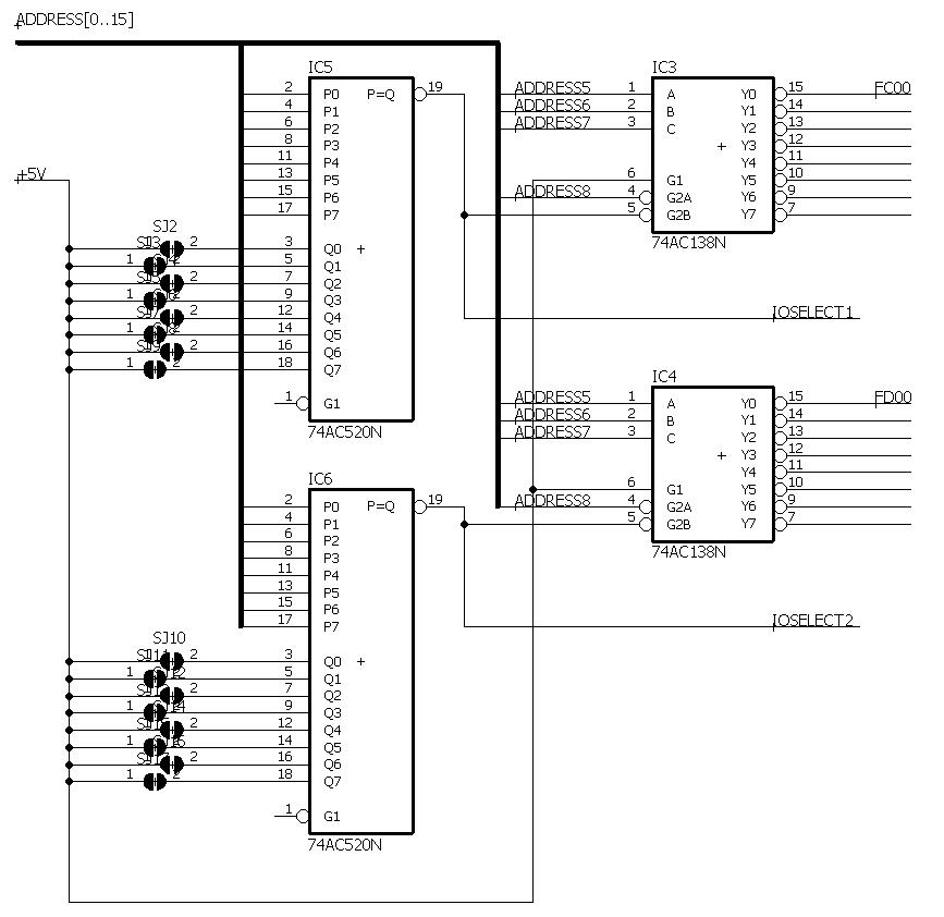

Re: Wait state for 3.6mhz
Hello again
Here's an update to the diagram, showing how multiple devices can be connected. The AND gate collects the inputs, which I think is what Vladimir was talking about.One thing this circuit doesn't offer is various numbers of wait-states. Each I/O device that's connected will get 2 wait-states, and of course any I/O devices not connected will get none. That's not such a bad solution. Maybe 2 wait-states is more than the 68B50's require, but only a small performance loss will result. What's probably more important is having a simple circuit that's easy to understand and build.
BTW, at some time in future you may wish to install 65C22's from WDC, which are rated to be as fast as the CPU and will require no wait-states at all.
I didn't mean to make it sound complicated. It's actually easier to make a decoder that meets this requirement than to make one that doesn't.
But I'm sorry to say some of your devices will require something more complex than just wait-states. I'm sorry this didn't occur to me sooner.
Using the 6522 as an example, that chip uses the PHI2 signal internally as a timebase -- to operate the timers, for instance. Although wait-states will stretch the bus accesses from the CPU, thus making them longer, that doesn't change the fact that at all times PHI2 is running faster than specified. The timers and any other internal functions using PHI2 may fail to work. This issue will affect most or all of the I/O chips on your list. (Sorry -- I'm not familiar with all of them.) It's possible you might get away with the violation of spec's, but of course that's not guaranteed.
The problem can be overcome -- the extra logic isn't horribly complex. IIRC some of the BBC computers from Acorn manage it.
Braincell1973 wrote:
Maybe i should start at 0.9mhz to ensure things start well.
Looks like i need to investigate how to ensure CS goes low before PHI2.
...Im not especially against GALs ...
BTW, wait states is a thing not to focus initially. Most of the work can be done at a low clock frequency, w/o wait states.
Concerning memory map, you might think of right now.
Vladimir

Braincell1973
- Posts: 14
- Joined: 01 Nov 2016
Thanks for the great replies.
I have been giving this lots of thought over the last few days before posting on here.
Excellent point about the clock stretching Jeff as that hadnt occurred to me, So now im wondering if the IO chips need the main clock or can i supply a secondary clock to them ???
So, If i had a7.2mhz crystal and used a ripple counter (hef4040b? good to 20mhz @5v) i could generate the other freqs at the same time as the main clock, i could also set up a jumper to set system speed for testing and too bypass wait states.
I really want to get the most from making the PCB's as i dont want have to remake any (4 week delay :/ ) also i want the most ,bang for buck out of them for future.
As soon as i can get the CPU/RAM/ROM board made i can improvise rest on perf while im designing other boards,
As for Memory map.....
16 or 32k for ROM selectable on jumper
32 or 48k for RAM selectable on jumper
IO page 1 at FC00 thru an ac138 for 8 IO's - 0 or 2 WS (again jumpered)
IO page 2 at FD00 thru an ac138 for 8 IO's - 0 or 1 WS (again jumpered)
Should be plenty for just about anything.
Using a modular design is 3.6mhz even attainable ?? Guess if its on a jumper it should be easy to find out
For storage i am waiting for a ch376 to arrive, (8Bit bus, Fat decoding on board......Nice )
The V9958 may be a bit of a problem as i cant find all info yet but will make a separate video board, Idea is i can use serial through 6850 as a start until i can get video board made.
Going to slightly adjust the basic rom on Grant Searle's webpage to get me up and running while i learn 6502 assembler
Im hoping to get some schematics done over the next few days if possible.
The propellors sound interesting and will have a look into those.

Hi All,
Knocked up the memory map decoding schematic, What do you all think ?
Using the 521 not the 520 in the schematic......
The jumper is obviously to select 16 or 32k ROM ...
Welcome your comments
Lee
Lee
