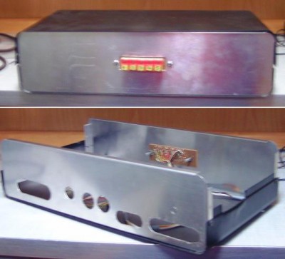

Drass seems to be away for the moment, so I'm adding a bit "historical" info.
Back in 2002, there had been a TTL CPU running 6502 machine code:
http://6502.org/users/dieter/m02/m02.htm
This probably explains, why OurCPU appears to be a "sandwich" built from two PCBs. ;)
The old CPU from 2002 lacked BCD mode, and it wasn't cycle compatible or timing compatible to the 6502
...you recognize the pioneer by the arrows in his back... but it already had a 24 Bit address bus.

After digging through the basement at the weekend, all I found was the casing:
35 years of hobby computing... and only one of my projects had a casing. :lol:
Five buttons, every button had a LED to indicate which 64kB page was active.
I remember that I tried to push the envelope back then:
Pressing a button twice made a program in a 64kB page running in the background,
what was indicated by a blinking LED.
Pressing the same button twice stopped the program running in the background again.
Buttons and LEDs were tied to a 6522, which also generated a NMI required for the
"multitasking" between different 64kB pages.
Making sure that programs running in the background won't modify the VIC2 registers
or use the disk drive was in the responsibility of the "end user", of course.
But the contraption crashed when sprites were enabled, I think there was a timing problem...
I just was unable to complete the project because at some point the C64 power supply
suddenly died with giving out over_voltage, schematics were a mess of hand drawn papers,
hardware was a lump of PCBs, components and wires... so it all went scrapped.
But enough of those old stories: Looking forward to see, what Drass could make out of this stuff.
There: "virtual consoles" and "multitasking" on a C64. ;)
LOL!! -- too funny, Dieter! I'm sure this remark will resonate with many forum members. You're not the only one whose creations go "au naturel"... :roll: Nice to hear about your project.

Thanks, Jeff. :)
See, for many years I had wondered why electronics gizmos need a casing at all,
because this only slows you down when you have to repair or to modify something.
Back in 2009, another hobbyist eventually had explained it to me:
If your creations have casings, piling them up in your workshop is less fuss...
Nevertheless, I still wonder what a casing for a TTL based "C64 compatible" computer may look like.
I still vote for a "tiled stove". ;)
