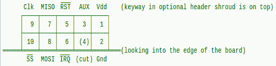

So here's the re-done pinout. These are looking into the pins on a 90° header, looking at the controller board from the edge, not down from the top.
First, here's the pinout for an actual UEXT master, showing four of the pins having their functions changed (all within the normal capabilities of the hardware likely to be doing the controlling) to accommodate a 3.3V SPI-10 module:
      Clk  MISO RST\  AUX  Vdd
     │  9 │  7 │  5 │  3 │  1 │
     │ 10 │  8 │  6 │ (4)│  2 │
═════╧════╧════╧════╧════╧════╧═══(looking into the edge of the board)
      CS\  MOSI IRQ\  NU   Gnd
("NU" = not used by SPI-10; but a 3.3V SPI-10 module can be used plugged into a UEXT master without modifying the master's hardware)
and then for a 3.3V SPI-10 controller port. It's the same except that pin 4 is actually cut or removed so that a 3.3V SPI-10 module that's keyed only by plugging that hole in the socket cannot be plugged in backwards:
      CS\  MOSI IRQ\ (cut) Gnd

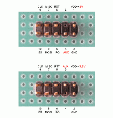

An SPI-10 module with position #4 plugged would not be able to plug into a UEXT controller.
Now for a 5V SPI-10-only master where you wouldn't want to be able to accidentally plug in a 3.3V-only part into it:
      Clk  MISO RST\ (cut) Vdd
     │  9 │  7 │  5 │ (3)│  1 │
     │ 10 │  8 │  6 │  4 │  2 │
      CS\  MOSI IRQ\  AUX  Gnd
and again a module with position #3 plugged would not be able to plug into a UEXT controller (where it wouldn't work anyway). 5V versus 3.3V ports have different pins cut (#3 versus #4). There is probably no danger of damaging anything by plugging a 5V module into a 3.3V port; but the vice-versa is not true.
Again, we're trying to avoid the complexities of voltage translation, especially on the modules, many if not most of which will be very small and simple. Also, we want to use common connectors, and the housings of board-mount sockets with the key on the side are rather rare, unlike those without. I buy long dual-row socket strips and cut off the number of pins I need, which is what I did for the module shown in the head post.

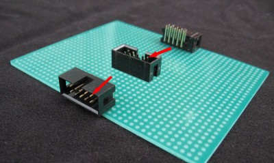

I found there is a keyed board-mount socket too, Omron part number XG4H-1031, Digi-Key stock number Z5647-ND, shown here:
(It's the first keyed one I've found for mounting on a board.) Note the pin-1 marking (the white triangle).
Since the orientation could be a big source of confusion, I'll try to express it a few different ways.
Pin 1 is on the same side with the key, which agrees with my earlier post showing the front edge of the 3U VME board, as well as with all the suppliers' related pictures I could find. So again, the component side of an SPI-10 module has the odd-numbered pins. Make sure you always start numbering from the correct corner for pin header versus socket. (The photo of the board-mount socket above could be turned upside down to match the picture farther down that shows the pin-numbering direction of the IDC with rainbow ribbon cable mounted.) This picture in the UEXT Wikipedia article
shows the connector upside down if it were a 90° one mounted at the edge of a board. So turn it over, rotating 180°. Again, the odd-numbered pins, and the keyway, will be on top, on the component side of the board.
If you need to connect with a ribbon cable, this picture shows conductor #1 of the ribbons at the left, and the IDC's key in the center. Hopefully it adds more help to get the orientation.
I can't believe how much time I've spent on this one little spec. Please check everything for me, and comment. Thanks.

Good plan swapping 5 and 6. I didn't know that SCL could be PP.
I like that the proposed SPI-10 key pins are in the RXD and TXD positions of UEXT.
Going through the possibilities:
  • SPI-10 module inserted in to UEXT host. Not possible because of the key pin
  • UEXT module inserted in to 3V3 SPI-10 host:
    • Supported as long as only SPI is in use
    • If the UEXT module uses RXD and TXD then nothing bad will happen since RXD is NC and AUX drives TXD, which should be RX on the UEXT module, thus high-impedance. Driving AUX could even be used for (one-way) communications. Driving AUX expecting a different module might cause nothing worse than framing errors on the UEXT module
    • If the UEXT module uses I2C then invalid I2C transactions will occur as RST\ and IRQ\ change level. Such transactions should be rejected by the I2C peripheral on the UEXT module
  • UEXT module inserted in to 5V SPI-10 host. The magic smoke comes out. This is unavoidable and no different than inserting any other electrically incompatible device in to the port (such as a 10-pin AVR ISP IDC cable with +5V on pin 2). I suspect that most users of SPI-10 check voltages and pin semantics carefully before connecting new hardware

  • (plus one for keying)
Here's the pinout for a 3.3V SPI-10 controller port, looking into the pins.  Pin 4 is actually cut or removed so that a 3.3V SPI-10 module that's keyed only by plugging that hole in the socket (as opposed to having a key on the outside of the socket) cannot be plugged in backwards.
An SPI-10 module with hole #4 plugged would not be able to plug into a UEXT controller.
Now for a 5V SPI-10-only port where you wouldn't want to be able to accidentally plug a 3.3V-only part into it:
and again a module with hole #3 plugged would not be able to plug into a UEXT controller (where it wouldn't work anyway).  5V versus 3.3V ports have different pins cut (#3 versus #4, respectively).  There is probably no danger of damaging anything by plugging a 5V module into a 3.3V port; but the vice-versa is not true.
SS\ above stands for "slave-select not."  You might also see CS\ for "chip-select not," and individual ICs may have a pin called CE\ for "chip-enable not."  (My apologies—I don't think there's any way to do the overbar in forum posts.)
Pin 1 is on the same side with the keyway in the optional shroud, agreeing with an earlier post showing the front edge of the 3U VME board, as well as with all the suppliers' related pictures I could find.  The component side of an SPI-10 module has the odd-numbered pins, and this keyway.  If the controller board has a 90° pin header at the edge of the board, the components on the controller board and the module will face the same way.  Make sure you always start numbering from the correct corner for pin header versus socket.  90° sockets for the module (as opposed to IDCs), especially sockets with the key on the outside, seem to be rare; and it takes less board space anyway to use straight soldertail pins on the socket, putting the PCB between the soldertails and soldering the row of odd numbers to pads on the component side, and the row of even numbers to pads on the opposite side.
If you opt for a 90° shrouded, keyed header (which goes on the controller, not the module), it will look something like this (except that you'll remove one of the pins, either #3 or #4):
Two practical header orientations for the controller board are the lower two in this picture (thanks to Dr Jefyll for the next three pictures):
Take care to number the pins correctly.  Pin 1 is indicated here with the arrow.  Pin 2 is below it.
The pinout, shown photographically for a vertical, unshrouded pin header, is as follows:
Headers and sockets both can be purchased in longer strips, up to 100 positions, and you can cut off however many you need to use at a time.  This may come out cheaper; and if you unexpectedly need different lengths for other projects, you have stock.
