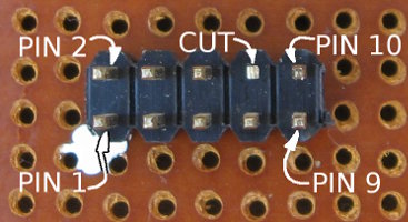

Here's a view looking down on a straight (vertical) 10-pin SPI-10 header. The pin header goes on the controller (master), while the module (slave) gets the socket, since the modules might be too vulnerable to mechanical damage if they had the pins. Pin 8 is cut as a keyway, and the corresponding hole in the module's socket is blocked to prevent inserting the module backwards or offset. Mark pin 1 in the PCB's silkscreened legend, or with white-out or a permanent marker if by hand.
If you want a little more protection for the pins on the controller board, there's no reason you couldn't use a shrouded pin header like this one:
The picture is from a distributor's site and does not have pin 8 cut off. If it's too hard to reach into the shroud with a wire cutter, you might be able to pull the pin out from the back with needle-nose pliers.

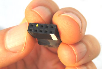

Position 8 of the module's socket is blocked, to prevent plugging it in wrong. On this one, I pulled the contact out before soldering the socket to the tiny board, and jammed a piece of wire with yellow insulation in the hole. Note the white-out marking pin 1.
You could put the pin header at the edge of the board as well, using 90° pins. You can flip it if desired. Here's the pinout:

  8. Empty. Pin 8 is cut off, and the hole in the socket is plugged, to prevent accidentally plugging the module in backwards or offset.

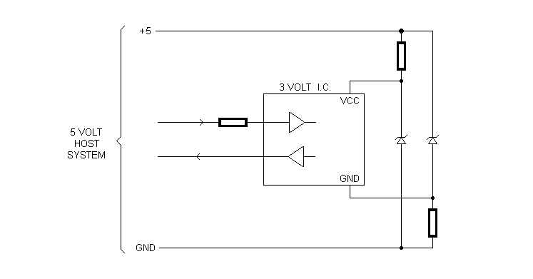

I was never fond of level shifters. I'm tempted to speculate that a quick 'n dirty shortcut like this (below) might be useful in some circumstances.
floating 3V 5V scheme.png (3.64 KiB) Viewed 11661 times
There are some obvious caveats, the main one being that the signal returned to the host system isn't TTL compatible. (The logic low seen by the host will be too high.) But if the host accepts CMOS levels it'll be fine.
I didn't bother drawing the supply bypass capacitors. The drawing is only intended to illustrate the relation between the four power rails. And zener diodes aren't the only option, or necessarily the best.
Edit: if there's concern about rise time for the input to the 3V IC then the series resistor can be shunted with a small capacitor -- eg, 5-10 pF.

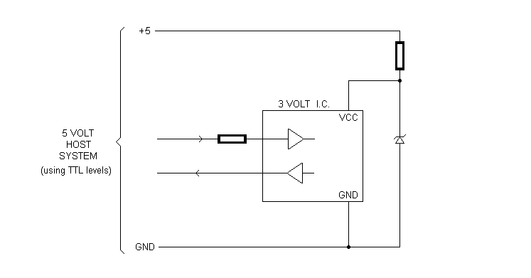

Edit: there's a more well-know variation (below) that's worth considering if the host system does use TTL levels.
3V 5V scheme (TTL).png (3.66 KiB) Viewed 11652 times

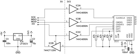

This is an active SPI to SD-card adapter. I am using it with 8 MHz SPI clock.
I would use a resistor coupled interface only for a much slower SPI clock.
