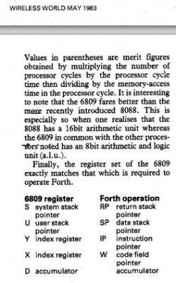

In 1983 the UK magazine Wireless World published a computer kit project followed by three articles about the Forth language. It's a 6809 machine and was intended to run Forth, although I don't suppose there's anything very Forth-specific about the hardware - it has 8k ROM and 16k to 48k of RAM. The author, Brian Woodroffe, does have a quick look at available CPUs and picks the 6809 as being a particularly good fit - it can do a fast NEXT. See the bottom of the third page of the first article and the top of the sixth. In fact, let me paste it here:

IMO, the 6809 is the Mercedes of 8-bitters. But, I prefer to drive my Toyota (6502) ... it doesn't distract me with all the complex amenities I don't really need for getting from point A to point B quickly and economically.

It's hard for Forth folk not to be tempted by a chip with four very powerful index registers (stack pointers). Also I have no objection to distractions :) such as indirect and auto-increment/decrement address modes that collapse multiple assembly-source lines into one. Sure, there are some minor warts on the 6809, such as dead cycles and the inferior-to-65xx flag behavior, but the biggest problem -- as jmp(FFFA) noted in another thread -- is simply that it's not being manufactured in a fast, modern process. :( In fact, 6809 and 6309 aren't being manufactured at all, AFAIK. Thank goodness there are some soft cores out there -- including Rob Finch's RFT6809.

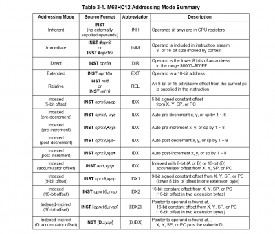

At first I had difficulty locating HCS12 doc; but, with that problem solved, I'm starting to get acquainted. It does seem that this family offers some good, Forth-y features! :D Like the 6809, it's very fluent with stack operations. The Address Modes (below) include pre- and post-increment and pre- and post-decrement modes that let you include a push or pop as part of another operation. On a slightly different topic, it's interesting that, "The CPU12 allows the index register to be incremented or decremented by any integer value in the ranges –8 through –1 or 1 through 8. The value need not be related to the size of the operand for the current instruction."
NXP offers a very wide selection of devices, most featuring a 16-bit data bus, it seems, and some with mapping logic that expands memory beyond 64K. But, as I eventually learned, HCS12 doesn't appear in the part numbers. A search on Mouser's site for HCS12 returns a bunch of MC9S12 part numbers, for example. There are lots of branches on the family tree, and I've only scratched the surface. The diagrams below came from the S12CPUV2 Reference Manual. Thanks again, nonarkitten, for the tip.

But the '12 has only one stack pointer whereas the 6809 has two. Doesn't that make a big difference, even though the rest of the registers are as for the 6809.
Edit: I see that Mike B. already mentioned the missing stack pointer.

Because auto-increment/decrement address modes are available X and Y are highly effective as stack pointers. So, one could argue that the 6809 has FOUR stack pointers (X,Y,U,S) and the HCS12 has THREE -- which is still plenty!
