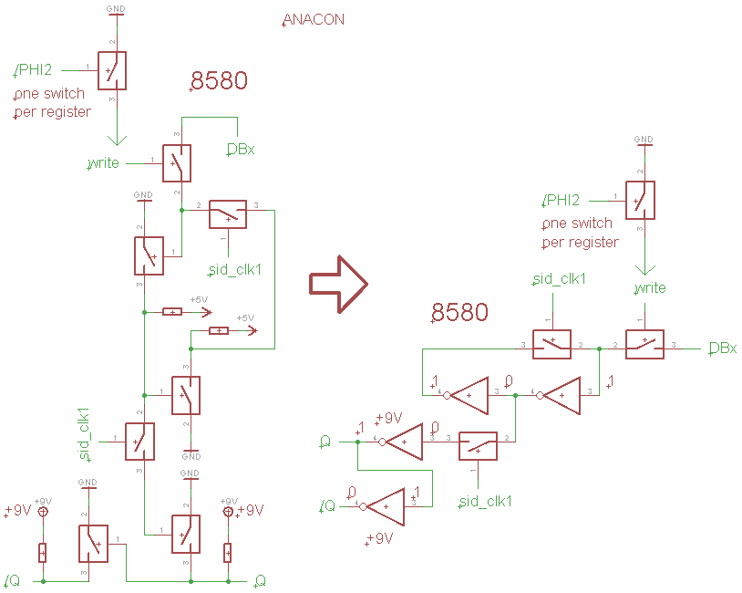

Now about the switches.
From the logic design point of view, the registers which control all the switches
and the filter frequency DAC all have identical schematics.
The layout for the register bits varies a little to make better use of the space
on the silicon, also size\geometry of the FET at the output might vary a little
depending on the load it has to drive...
Schematic for one register bit:
BTW: the PolySi write control lines are a bit long, so the designers added a FET to every 8 bit register
as a "kludge" to meet the bus hold timing that clobbers the write control signal to GND if PHI2 =0...
like with the registers in the envelope generator.

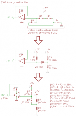

The 4.759V voltage for the virtual ground is generated by a PolySi resistor divider
north east from the LSB of the channel 3 envelope DAC.
...we'll see about that OpAmp later.

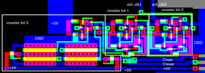

We have an asynchronous 3 bit binary counter, LSB is running at the speed of PHI2.
Every counter bit drives a R\S flipflop for making the inverted and non_inverted
output of the bit non_overlapping.
From the logic design point of view, those three bits in the counter are pretty similar...
on the silicon, the transistors in the R\S flipflop output of the MSB are just a bit bigger...
and +9V powered.

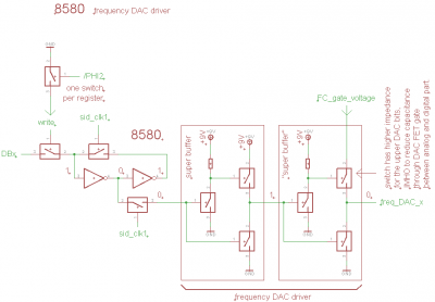

Schematic for a register bit plus frequency control DAC buffer:
Nothing special, conceptually the DAC buffer is just a super buffer... but it's +9V powered.
The output either is tied to GND, or to the gate control voltage mentioned in the previous post.

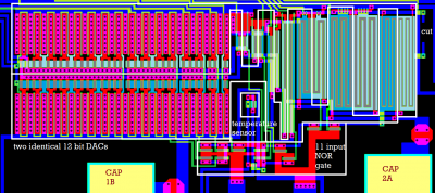

We have two identical 12 bit DACs in the 8580, which work as resistances for the filter integrators:
// sorry for those colors.
The 8580 has 11 bits for frequency control, but 12 bit DACs.
If those 11 bits would be '0', the impedance of the DACs would be "infinitely high".
To get around this, there is an 11 input NOR gate below the DACs sensing those 11 bits.
If they are 0, the NOR gate gives the gate control voltage to the 12 bit DAC LSB.
Between the DACs and the NOR gate, we have that FET which works as a temperature sensor
for the circuitry that changes the gate control voltage according to the DAC temperature.

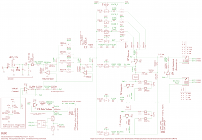

Ok, now for my interpretation of the 8580 filter:
There is a nice picture of the 8580 filter section at Tommi Lempinen's site,
but the picture is a little bit too big for directly linking to that image...
and making the image smaller would spoil the readability of it:
http://oms.wmhost.com/misc/MOS_8580_R5_filter.png
