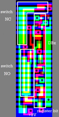

The game is similar like in the 6581... except for one thing:
each of the switches is built from two FETs instead of just one FET.
East, we have a big PolySi pad that connects to a bit on the internal data bus.
West, we have two analog switches,
one normally open (NO) // closed, if the register bit is written with 1
one normally closed (NC) // closed, if the register is written with 0
BTW: geometry\ratio of the FET that works as an analog switch gives the resistance of a closed switch.
...and in the middle, we have the register bit.
In the 6581, we had one FET working as a switch for an analog signal.
In the 8580, we have _two_ FETs working as a single switch for an analog signal:
A FET with a low impedance and a FET with a high impedance in series.
IMHO this might be a trick from the designers to reduce capacitance between both ends of a switch.
The FET with the higher impedance tends to be at the side of the switch that connects to an OP or such...
Note, that this trick is also used in the frequency control DACs...
and maybe for resistors which don't act as a switch, too.

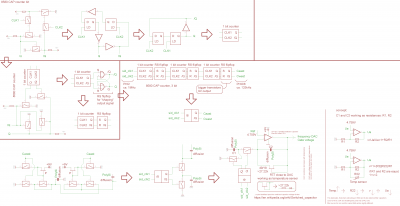

At some point, I noticed two big capacitors in the 8580 layout.
So I started to wonder, what they might be good for.
Voltage doubler charge pump ? Can't be, because all the OpAmps turned out to be +9V powered.
Switched capacitor filter ? Can't be, because of how the switches attached to those capacitors are wired up.
It turned out that the two big capacitors are part of a trick circuitry,
which changes the gate voltage of the frequency control DACs according
to the temperature of the DACs, to reduce the effects of temperature
to the filter curve.
There is a FET working as a temperature sensor close to the DACs...
but we are getting there later.

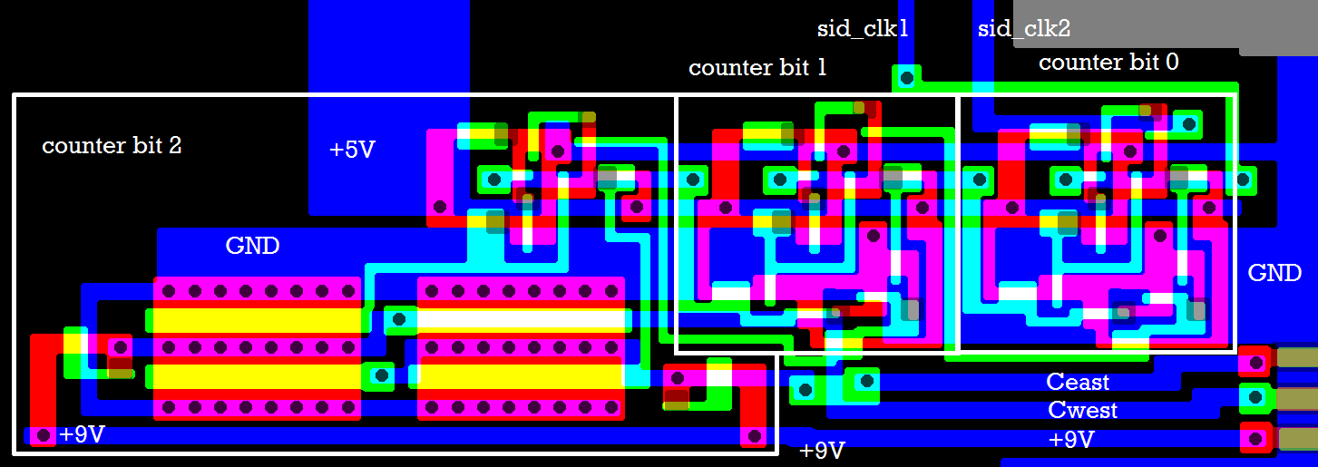

We have an asynchronous 3 bit binary counter, LSB is running at the speed of PHI2.
Every counter bit drives a R\S flipflop for making the inverted and non_inverted
output of the bit non_overlapping.
From the logic design point of view, those three bits in the counter are pretty similar...
on the silicon, the transistors in the R\S flipflop output of the MSB are just a bit bigger...
and +9V powered.
The two big capacitors and the +9V powered switches "between" them:
It's an ingenious idea to use the AC resistance of two capacitors as a voltage divider.
The AC resistance of the two capacitors depends on the PHI2 clock frequency,
while the resistance of the temperature sensor FET does not.
This implicates, that when taking a PAL C64 and modiying it into a NTSC C64,
or vice versa, this might shift the filter curve by 4% or such.
