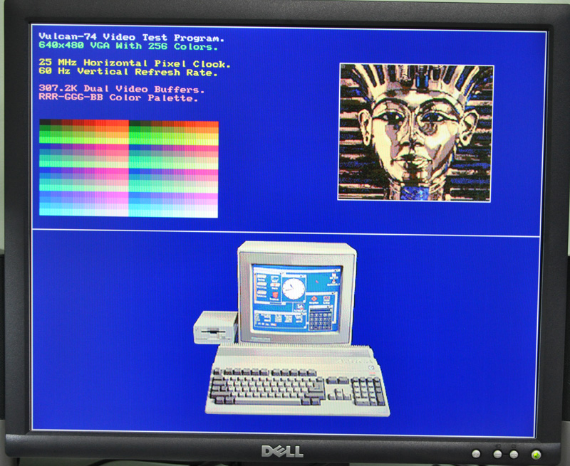

I redid most of the VGA Generator wiring today just to clean up the placement of a few components and get a break from weeding the greenhouse! At this point, I have only the bare-bones VGA Generator, which gives a clean 640x480 with 256 colors with dual Video Buffers. Each Buffer is a 512K SRAM, addressed as 10x9 bits for 640x480. Buffer switching happens automatically on the Vertical Sync so that the CPU can draw on the "Back Buffer" while the "Front Buffer" is drawn to the screen. The CPU is not aware of this, since it is all controlled by the Logic.
Before I bolt down my 6502 again, I am doing the Video Testing with an AVR, since it has plenty of room to store images.
When the 6502 takes over, all the User Interface images will be drawn programmatically.
There will be fonts and icons stored in the limited 32k ROM area, but most images will be computed.
3D buttons, gauges, sliders, and rendering of waveforms will all happen in code.
Here is the final test, showing that the Video Generator is working perfectly at 25.175MHz for a clean 640x480 display...
640x480 with 256 Colors... all done by 7400 Logic Chips!

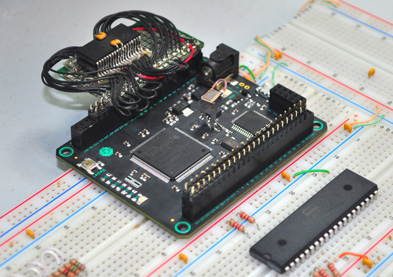

Today, I decided to revive the Video Game version of Vulcan-74, but made it "portable" so I could work on it when I am away for work on road trips.
Yeah, since I am often stuck for a day or two in some remote hotel, I wanted a project that would fit into a shoebox.
So the plan was to hack together an FPGA emulator version of the giant breadboard, and I managed to do it one one day!
Now this is cool since I am somewhat new to Verilog, but it does prove that knowing the hardware makes one into a better HDL coder.
The target is a Spartn-6 FPGA, and the "donor" board was once a Mojo-FPGA Board. I say donor because I hacked it all to hell.
I needed a meg of SRAM, so I dead-bugged a pair of 512K SRAMs to the board, and then replaced the oscillator with a 20MHz clock.
The FPGA is clocked at 40MHz, and does some real trickery when it comes to sharing the SRAM with 6502, Video, Sound, and GPU.
The 6502 thinks it is just connected to a super fast 64K SRAM, and the FPGA does all the boot load stuffing and IO magic.
I am also working on some SD Card code to load everything on startup, but for now it is all done via SB cable.
The FPGA version actually has more power than the breadboard version, since it is easy to add features in code.

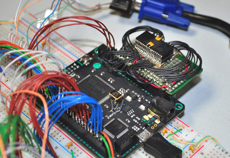

This was once a MOJO Fpga board.
To gain the required 98 IO pins, I desoldered all of the onboard LEDs and made a new IO map.
I also ripped up the oscillator and added a new 20MHz version.
This is doubled internally by the PLL to meet the 40MHz timing for 800x600 VGA.
A pair of 512K 10ns SRAMs added.
Everything is shared by the 1 meg of onboard memory, arbitrated by the FPGA.
Zero page and IO live internally in code, but everything else is in SRAM.
Graphics Data, Sound Data, 6502 Code, and dual Video Buffers all take tuns!

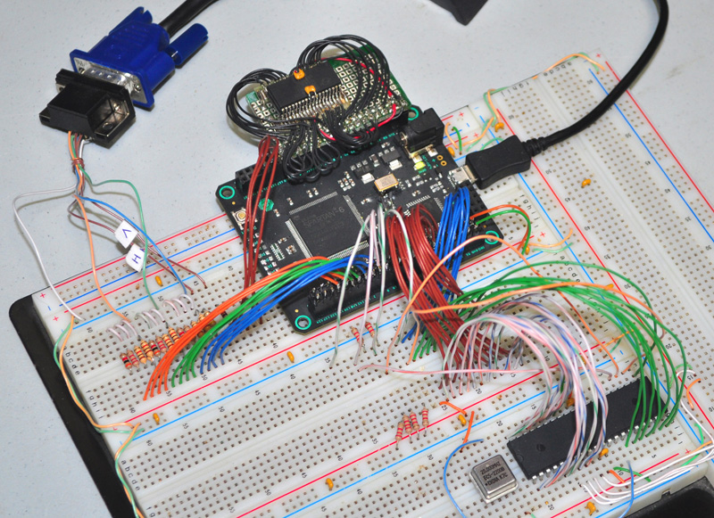

6502 and Video DAC
The 6502 has no idea that it is connected to an FPGA!
I have tested the 6502 up to 8MHz, which is the "legal" top speed for 3.3v operation.
As you can see by the resulting videos, this is plenty fast to womp an Amiga for graphics power!
The Video DAC is 12 bits, for a total of 4096 colors. Only 256 are displayed at once.
To allow for more color control, the palette is fully programmable on the fly.

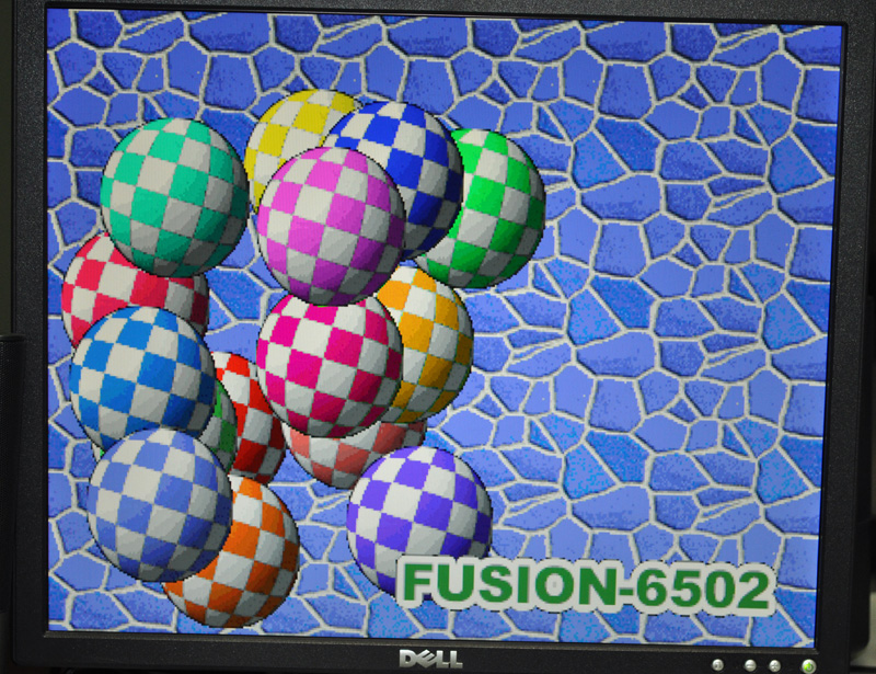

It's those damn checker balls again!!
Yeah, what can I say... I like watching those checker balls fly around the screen!
This time they are multi-colored thanks to the abilty to rotate the color palette on the fly.
I only have to store one 32 color ball sequence, and can rotate the dark panels 16 times.
These ar 80x80 sprites with 256 color depth, and one invisible "alpha" color.
Fusion-6502 can hurl over 30 of these around the screen at 60 frames per second!
For comparison "Boing" on the Amiga only did one ball, and it was only color cycled.

Yeah, I have grown to enjoy 6502 assembly so much that I really just want a fun platform to code with.
For me, it has to be a real DIP 6502 as well. Not sure why, just seems "right" somehow!
Yes, I actually use the DCM to multiply the clock internally, but things do work out well with the 20MHz input clock.
The FPGA runs at 40MHz internally, and also feeds the 6502 up to 8MHz.
The 6502 is fully controlled and even single stepped at some points in order to optimize speed and SRAM sharing.
There is even some "caching" in the works so that the 6502 memory space is buffered while the GPU does its work.
