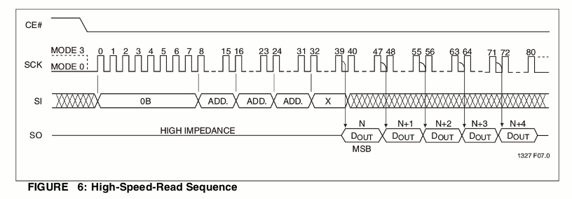

legacy wrote:
The serial flash is definitely not random-access
a flash chip is randomly-accessable ONLY in read mode
The qualifier was the word "serial." Here's the timing diagram to read from the 25VF032 4Mx8 serial (SPI) flash in an SO-8 package:
After you select the part, it takes 48 SPI clock cycles (or 40 in the non-high-speed mode, good for up to 25MHz clock) before you have the first byte of the read.

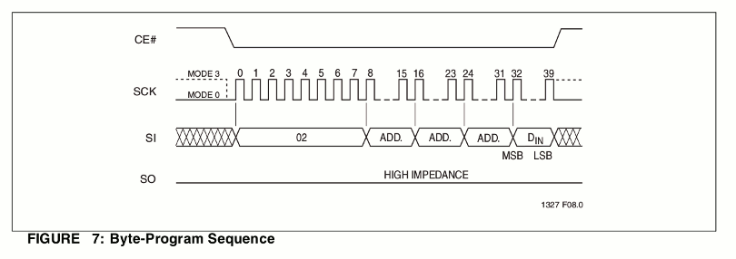

It is possible to write one byte at a time, but the byte must be erased, and you have to give it a write-enable instruction before writing. After giving it the byte-program instruction, it takes 10µs to complete it. It writes the whole page, even if you've only specified one byte. The rest of the page just gets the same data it already had. Here's the diagram for the byte-write instruction:
Minimum write endurance to a sector is 10,000 cycles. SRAM's endurance of course is infinite.
