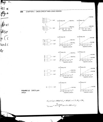

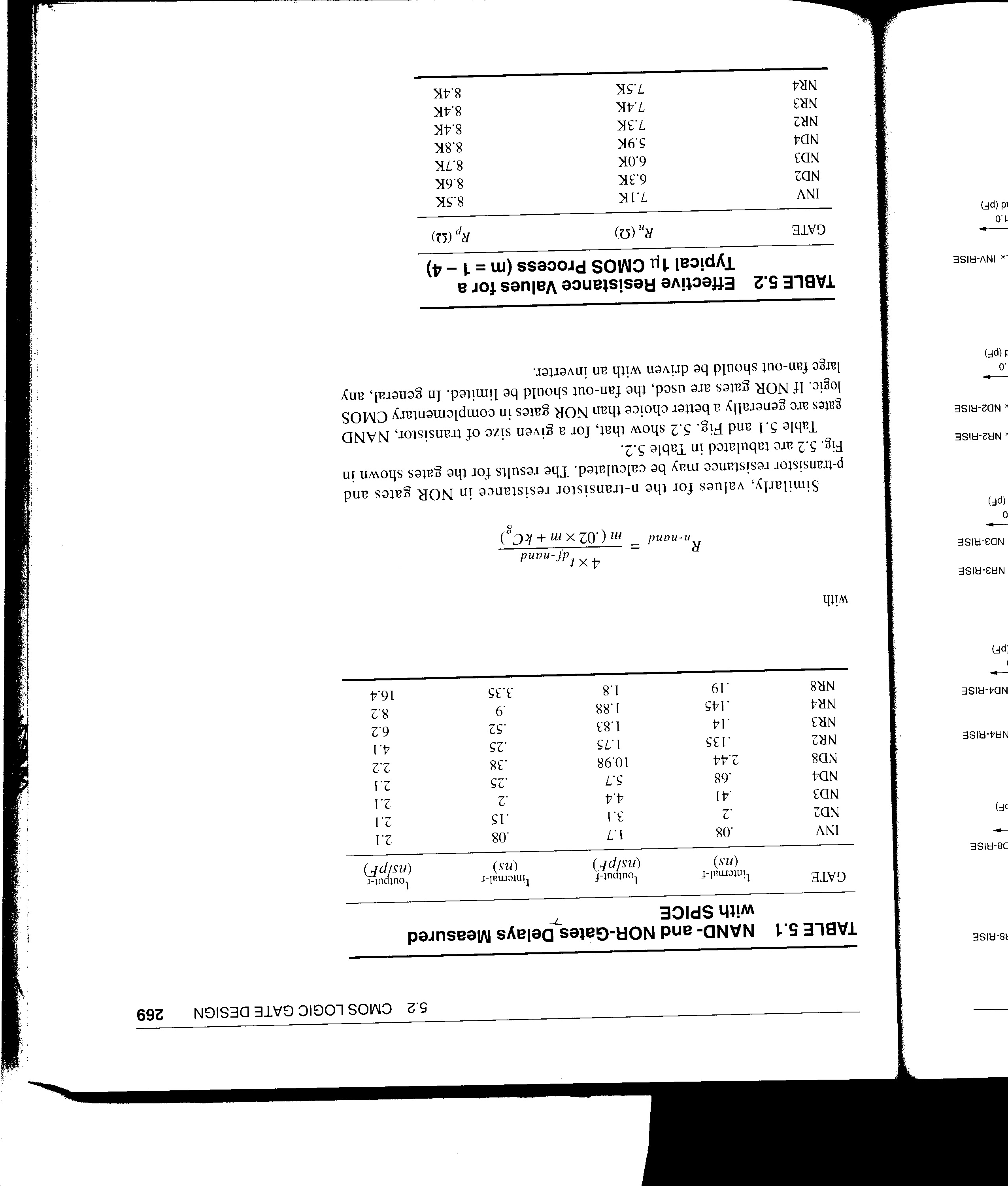

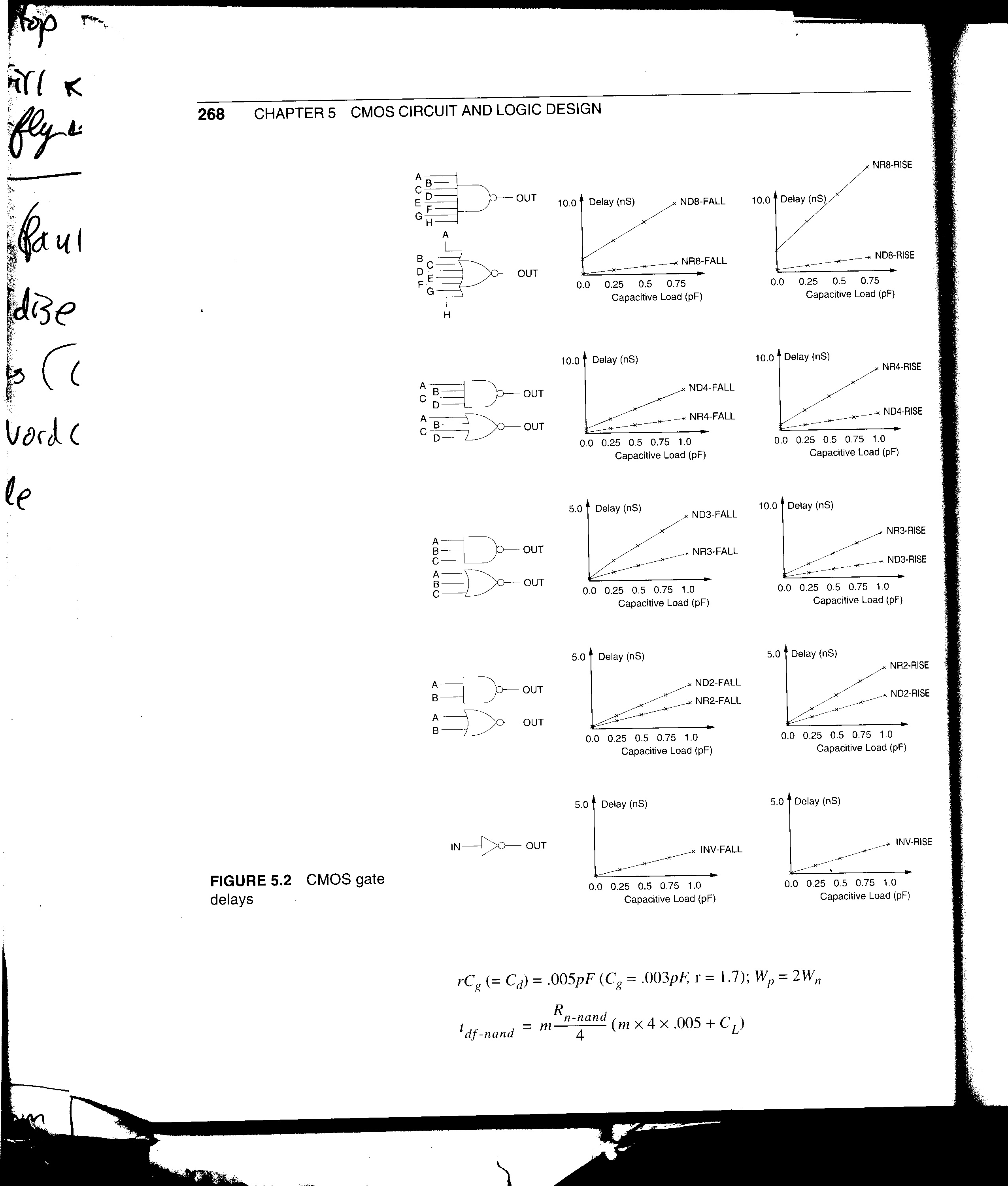

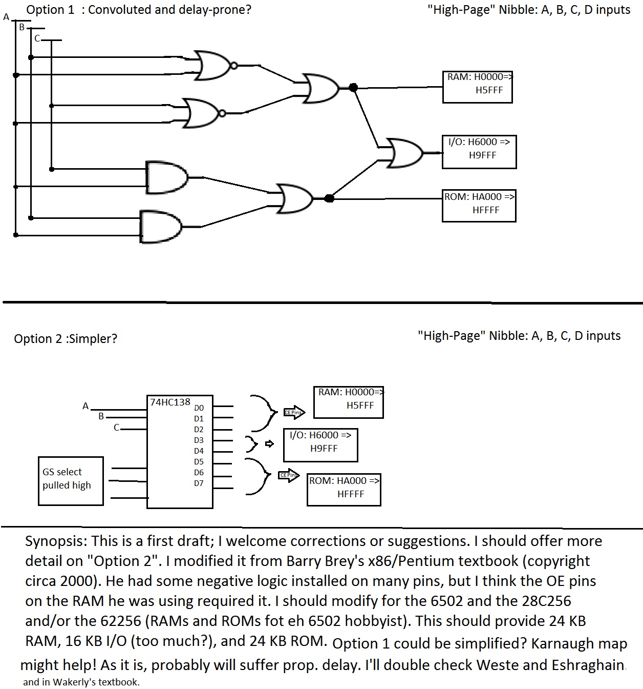

A sessions of teaching binary to a certain ten year old has got me behind in my memory decoding scheme; but, soon, he will have his own chip and it will be time us BOTH to work on it!
Here is the rough draft, as I have no time to look at it anymore today; must go home and work on my "air-gap" computer! Maybe draft 2 will post tomorrow, and maybe an inkling of a PCB pattern, too!
(I must check the actual diagrams for the 74138; Maybe Wakerly, or "Weste and Eshraghian" will tell me the propagation delays for the 74XX logic in my schematic? I can calculate those and see if it is too cumbersome.)
Scanned files are from Weste and Eshraghian, and probably somewhat out-of-date. It seems to be a standard undergrad textbook, from its wide availablity on ebay/amazon/etc. @ like 1$ price! I haave not read/fully-cogitated yet, but plan to.

- GARTHWILSON
- Forum Moderator
- Posts: 8773
- Joined: 30 Aug 2002
Re: An actual project for a newbie biologist
For each logic IC, the manufacturer's data sheet will tell the propagation delays. Use these, not some generalization from a theory book. Any given logic IC (for example, 2-input NAND '00, inverter '04, etc.) will have different times and other characteristics from one family to another, like 74HC00, 74AC00, 74AHC00, etc.. I definitely recommend using CMOS, not TTL. TTL (like 7400, 74LS00, etc.) offers virtually no benefits to outweigh its deficits. See the 6502 primer page on 74xx logic families and timing margins and the links to related ap. notes at the end.

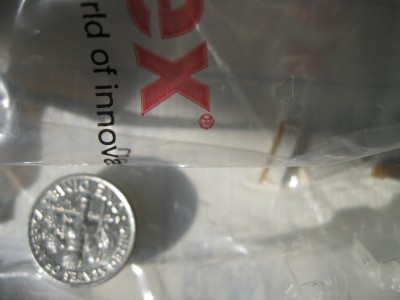

Thanks again, for all advice. Here's photos of my molex connectors; still finding the ribbons; misplaced them (I hope they are big enough conductors for my image sensor focal plane array projects "I-partial" and "II-still-a-dream"). And photos of my '816, in foam. And tomorrow have picture of latest on 6502-o-poly; will post then, but must go find lunch now.

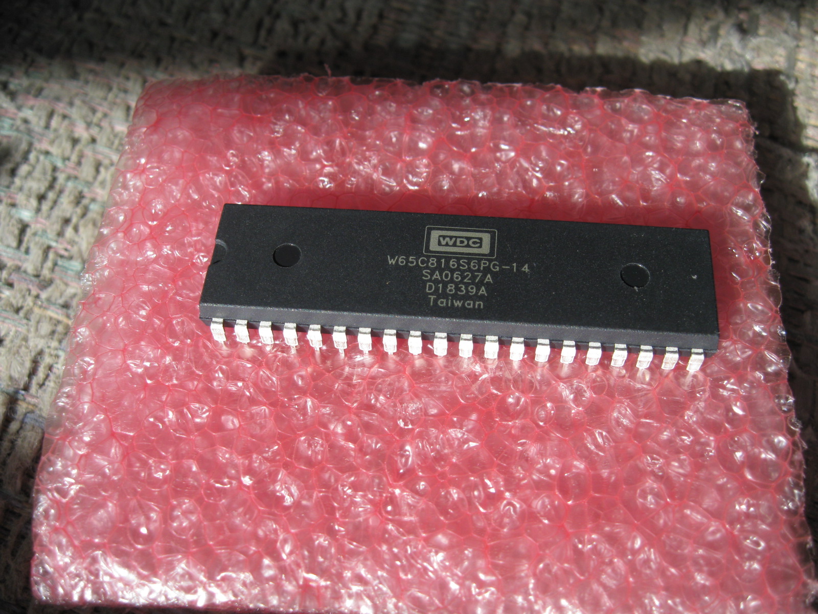

I have been trying to fit the EEPROM, RAM , '816, and the 65C22 onto the same board, with one decoder 74138 (and maybe some XNORS? I haven't worked ALL the logic out, just yet!) with a double sided, plated thru hole, model, but it has been annoying. The pins don't seem to line up very easily, and don't "want" to let me minimize the distance between them.
Anybody know, is it OK for me to put some DIPs on one side of the board, and some on the other side of the board? Does it matter which side of the pin is soldered to which side of the board? Can a pin be attached to one trace on one side of board, and another trace on the other side of the board; i.e. "common-node"? I assume this is OK, but I don't know.
You can also put ICs inside a larger socket, so smaller ICs go under bigger ones, as shown in the last picture at http://wilsonminesco.com/6502primer/MoreOnPCB.html .

Thanks a million. I have tried to make the PCB layout two or three times, but each time I sort of stall and start from scratch again. The good news is, your advice is in line with what I was thinking and where I was going. I am getting closer to actually getting a working design (i.e. one that is possible for me to implement successfully at my skill level).
Parts are ordered; in the mail as I write. I still need (1) an oscillator can (2) a reset button (though, my local radio shack will have one) (3) a 3-input And gate, (4) a pin/holder-thingy for your expansion board and (5) your expansion/memory board; ( I haven't looked at the schematic yet for the expansion, but the '816 chip suggest I should!). Oh yeah, and 6522. And power supply (which I haven't thought much about! I don't suppose a 6 VDC, wall-wart and 7805 with a few electrolytic capcitors would work fine, would it?)
I am not ready to buy, yet (broke, as always) but in a month or two I could be ready.
So, a few small question; buses, both address and data, generally "fan-out", right? I mean, the whole bus trace is "driven" but because of the chip select, only one chip is "listening" at any one moment? So, my PCB traces for each address pin, or data pin, will generally branch into 3 or 4 or 5 different locations, right?
Regarding clock, your primer didn't seem to comment much on the '816. I will read it over again, but from the '816 schematic it seems there is only one clock pin, and it is an input (called Phi-2, I think?).
My question about 2n2907 was for a slightly different project; a fiber optic, TTL signal, LED driver. I bought a discrete one at radio shack on Monday; for 1$ I couldn't say no.
I think my decoder circuitry will require a 74138 (ordered and paid for, in the mail) and a 3-input And gate. Texas instruments offers $0.50 or so chips, with something like 8 to 10 ns propagation delay, so I'll probably order that soon.
I will try to post a schematic of my memory decoding, for perusal/correction. I just thought up the answer, while waiting for the radio-shack bus on monday! (if A,B,C, of 74138 IC is A15, A14, A13 of the 65816, then, the OutPut0=>OP2 (3 pins) address the 24KB of RAM; OP3=>OP5 (2 pins) address the 16KB I/O space; and the OP6=>OP8 (3 pins) address the 24KB of ROM).
Thus, for each, when one of the first three OutPut pins goes low, a 3-input-AND will go low, to enable the RAM CE pin; for I/O a 2-input-AND can chip enable (but does 6522 work like that? is there a CE pin.... don't answer that, i'm just thinking out loud); and, finally, the last three OutPut pins of the 74138 would use a 3-input-AND gate to pull the CE low, and enable the ROM.
It will make more sense when I put it on a PCB.

One last question; possibly the most crucial (and I will read your segment on "Avoiding AC problems", rather than peruse it, as I did last time!). I should keep the clock signal far away from the address and data buses, right? I mean, its not even good to pass it over one of the A or D lines, even if they are on the other side of the board, unless its a brief pass (I mean, you wouldn't run the clock trace on one side of the board and a Data or Address trace directly oppposite it, on the underside, due to capacitive coupling, right?).
So, if a clock trace MUST pass over these other traces, it is best to (1) go right over quickly and (2) leave much room between the clock trace and other traces, regardless of what side of the board these other traces are on. Is that right? Or am I over-obsessive, at these frequencies?
Ooops, I have to go... local library is closing and computer time is over! (I "jacked" your website, and took it home to my "air gap computer". i will read the primer, again/more/thouroughly/etc.
Thanks again
Thanks again
About the clock line in your last post: Don't worry about running it close to other stuff. When it matters most, you'll use a ground plane anyway, and also observe the other things written there about groundbounce and things that are at least as much if not more of a concern.
- BigDumbDinosaur
- Posts: 9425
- Joined: 28 May 2009

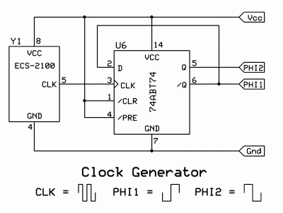

The "ideal" way to generate the Ø2 clock is with a can oscillator whose output is directed through a D-type flip-flop, such as a 74AC74 or 74ABT74.
The above circuit can be used with a 65C02 (ignore PHI1) or the 65C816. If using bank latching with the '816 the PHI1 output would be used to gate the latch. The Ø1 and Ø2 outputs lag the oscillator output by 6-10ns. For this reason, no reference should be made to the oscillator output.
The resulting output is a very sharply-defined square wave with an exact 50-50 symmetry. The oscillator frequency must be twice that of the desired Ø2 clock frequency with this arrangement.
I think my decoder circuitry will require a 74138...

Sorry, Garth, I can be a bit "informal" when talking electronics and part numbers. I have to stop doing that. I forget what I mean (I was correct when I ordered the part? 74HC138, I think? I am pretty sure. Actually, I think I even bought a 74AC138 because, upon reading your primer--as I recall--I saw I might squeeze some extra performance out of them.)
I think the TI 3-input AND gates I wanted (for decoding) were also HC. My next digikey/jameco order will be that, and a switch, and maybe an oscillator can. I know RS can gouge, a bit; but the bus is cheaper than shipping and handling. but it takes about a day drive (weird schedules; transfer), so I catch up on reading.
Thanks BDD; "clock stuff" , I need!
Garth; I read about ground planes once; misplaced all my "good info about PCB design". My library is a mess.
I'll give the primer another view (I didn't since my last post; was watching videos on microproc. history and read very little. On the upswing, I did much CAD design on my PCB-drawing, and it is close to finished. Things still not "close" or "tight" enough, but it is a pretty thing, so far. I really should have had all the power and ground stuff figured out, already, but I have sort of saved it for last. Mostly, I've just been routing the address and data and decoder and CE pins.).
