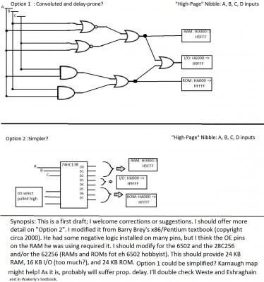

A sessions of teaching binary to a certain ten year old has got me behind in my memory decoding scheme; but, soon, he will have his own chip and it will be time us BOTH to work on it!
Here is the rough draft, as I have no time to look at it anymore today; must go home and work on my "air-gap" computer! Maybe draft 2 will post tomorrow, and maybe an inkling of a PCB pattern, too!
(I must check the actual diagrams for the 74138; Maybe Wakerly, or "Weste and Eshraghian" will tell me the propagation delays for the 74XX logic in my schematic? I can calculate those and see if it is too cumbersome.)
Scanned files are from Weste and Eshraghian, and probably somewhat out-of-date. It seems to be a standard undergrad textbook, from its wide availablity on ebay/amazon/etc. @ like 1$ price! I haave not read/fully-cogitated yet, but plan to.

PostPosted: Mon Nov 09, 2015 10:17 pm
Posts: 8510
For each logic IC, the manufacturer's data sheet will tell the propagation delays. Use these, not some generalization from a theory book. Any given logic IC (for example, 2-input NAND '00, inverter '04, etc.) will have different times and other characteristics from one family to another, like 74HC00, 74AC00, 74AHC00, etc.. I definitely recommend using CMOS, not TTL. TTL (like 7400, 74LS00, etc.) offers virtually no benefits to outweigh its deficits. See the 6502 primer page on 74xx logic families and timing margins and the links to related ap. notes at the end.
