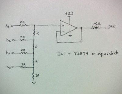

Can we put a 4-bit R-2R DAC on the board and an analog VGA connector? That's just the connector, plus 24 0402 (1K/2K works nicely) resistors. Enough to connect up to most VGA displays.

Yes, that was the plan, except instead of a R-2R ladder, I was planning to use 500-1000-2000-4000 Ohms. I don't think 1K/2K works, though. The R-2R ladder has an impedance of R, so combined with 75 Ohm impedance on the input that drops 3.3V to 230mV, which is a bit low. To avoid boutique values, I wanted to make 500 from 1K/1K parallel, the 2K from 1K/1K in series, and the 4K from 1K8+2K2 in series, for a combined 21 resistors for 4 bit RGB.
In addition to analog VGA, I wanted to add a ADV7391 PAL/NTSC encoder chip. It only needs 13 digital inputs, and produces various analog TV signals, including composite, component, rgb, and s-video. I was planning to reuse the VGA output pins on the FPGA for most of the interface.
Please have a look at the Terasic DE1 board: http://www.terasic.com.tw/cgi-bin/page/archive.pl?Language=English&CategoryNo=165&No=83 It uses the R-2R ladder with 1K/2K resistors for the VGA output. You can download the CDROM image (~90 MB) with the schematic for free if you register there. I had one of these boards in the past before replacing it with a newer one and I can tell you that the VGA output worked OK with the older VGA monitors I used it with. However, I do see your concern about the voltage divider formed. This can be resolved for the cost of a quad op-amp chip with RRIO. Board space is almost insignificant with TSSOP or QFN packaging. I'll attach a schematic when I get home this evening.
OK. What do you have in mind to switch between the two outputs? Some kind of high speed bus switch driven by a dip switch or jumper (unless you have a spare GPIO pin on the FPGA)?

Please have a look at the Terasic DE1 board: http://www.terasic.com.tw/cgi-bin/page/ ... =165&No=83 It uses the R-2R ladder with 1K/2K resistors for the VGA output.
I found the schematics. It does have 1K and 2K resistor packs, but it doesn't use them in ladder configuration. Rather, it uses 1K/1K parallel, 1K, 2K, and 2K+2K in series.

PostPosted: Wed Nov 04, 2015 10:48 pm
Posts: 171
Location: Philadelphia, PA
This is what I was thinking of (one for each color channel):
File comment: 4-bit DAC
(excuse the hastily drawn schematic)
It uses an R-2R ladder with the op-amp buffer. Gives an exact impedance match without fiddling with resistor values.
Edit: Link for the TSH74 op-amp datasheet: http://www.st.com/web/en/resource/technical/document/datasheet/CD00002283.pdf

PostPosted: Wed Nov 04, 2015 11:01 pm
Posts: 171
Damn, not sure how I missed that, but you are absolutely right.
