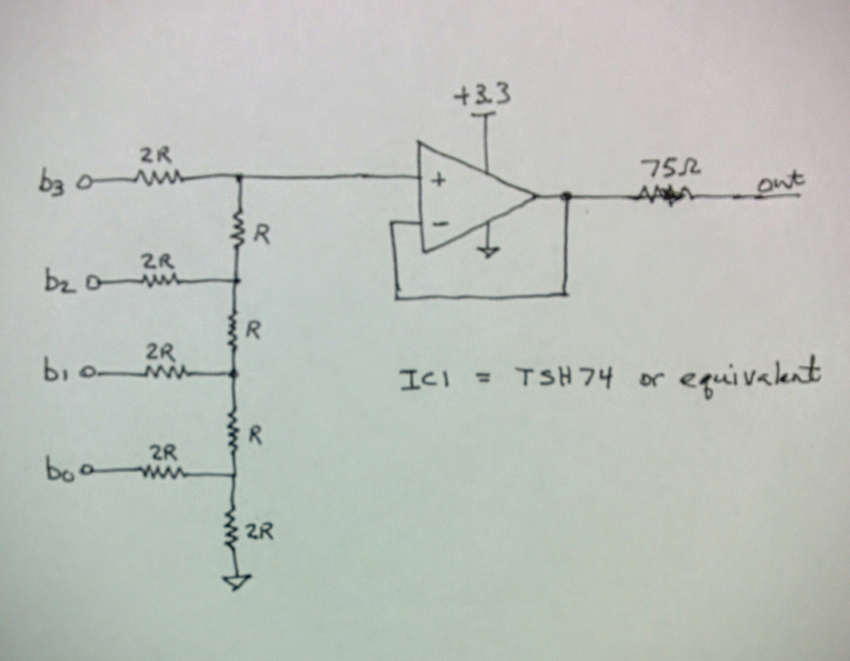

Can we put a 4-bit R-2R DAC on the board and an analog VGA connector? That's just the connector, plus 24 0402 (1K/2K works nicely) resistors. Enough to connect up to most VGA displays.

Yes, that was the plan, except instead of a R-2R ladder, I was planning to use 500-1000-2000-4000 Ohms. I don't think 1K/2K works, though. The R-2R ladder has an impedance of R, so combined with 75 Ohm impedance on the input that drops 3.3V to 230mV, which is a bit low. To avoid boutique values, I wanted to make 500 from 1K/1K parallel, the 2K from 1K/1K in series, and the 4K from 1K8+2K2 in series, for a combined 21 resistors for 4 bit RGB.

I found the schematics. It does have 1K and 2K resistor packs, but it doesn't use them in ladder configuration. Rather, it uses 1K/1K parallel, 1K, 2K, and 2K+2K in series.

PostPosted: Wed Nov 04, 2015 10:48 pm
Posts: 171
Location: Philadelphia, PA
This is what I was thinking of (one for each color channel):
File comment: 4-bit DAC
(excuse the hastily drawn schematic)
It uses an R-2R ladder with the op-amp buffer. Gives an exact impedance match without fiddling with resistor values.
Edit: Link for the TSH74 op-amp datasheet: http://www.st.com/web/en/resource/technical/document/datasheet/CD00002283.pdf
Damn, not sure how I missed that, but you are absolutely right.
