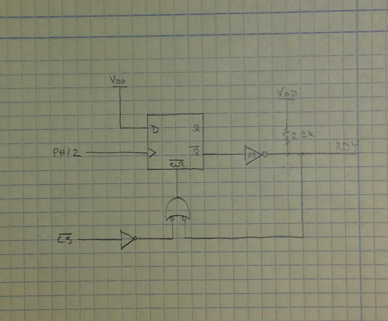

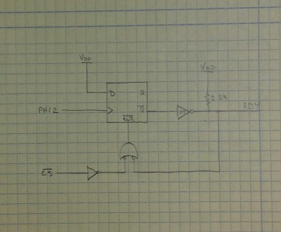

For anyone who has implemented wait state logic on the 65c02 before, is this a reasonable way to generate a 1-cycle wait state on the 65c02? I don't have much room left on my breadboard and would like to keep the gate count as low as is practicable.
The "rdy" logic output will be open drain in order to drive the 65c02 RDY line.
The circuit described by the Verilog code below should be adequately approximated with a 74HC74, and a 74HC03 with suitable pull-ups depending on the clock frequency being used. I have half a 74HC74 already available, so I would just need to add the 74HC03 to complete the circuit below.
Here is the schematic I was trying to describe in Verilog above:
It doesn't work because cs_uart is never de-asserted while RDY is low. I'm going to need another flip flop to make it work, or maybe a counter. Very little room left on the breadboard at the moment, but hopefully I'll figure something out that will avoid any major rearranging of parts.

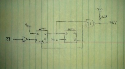

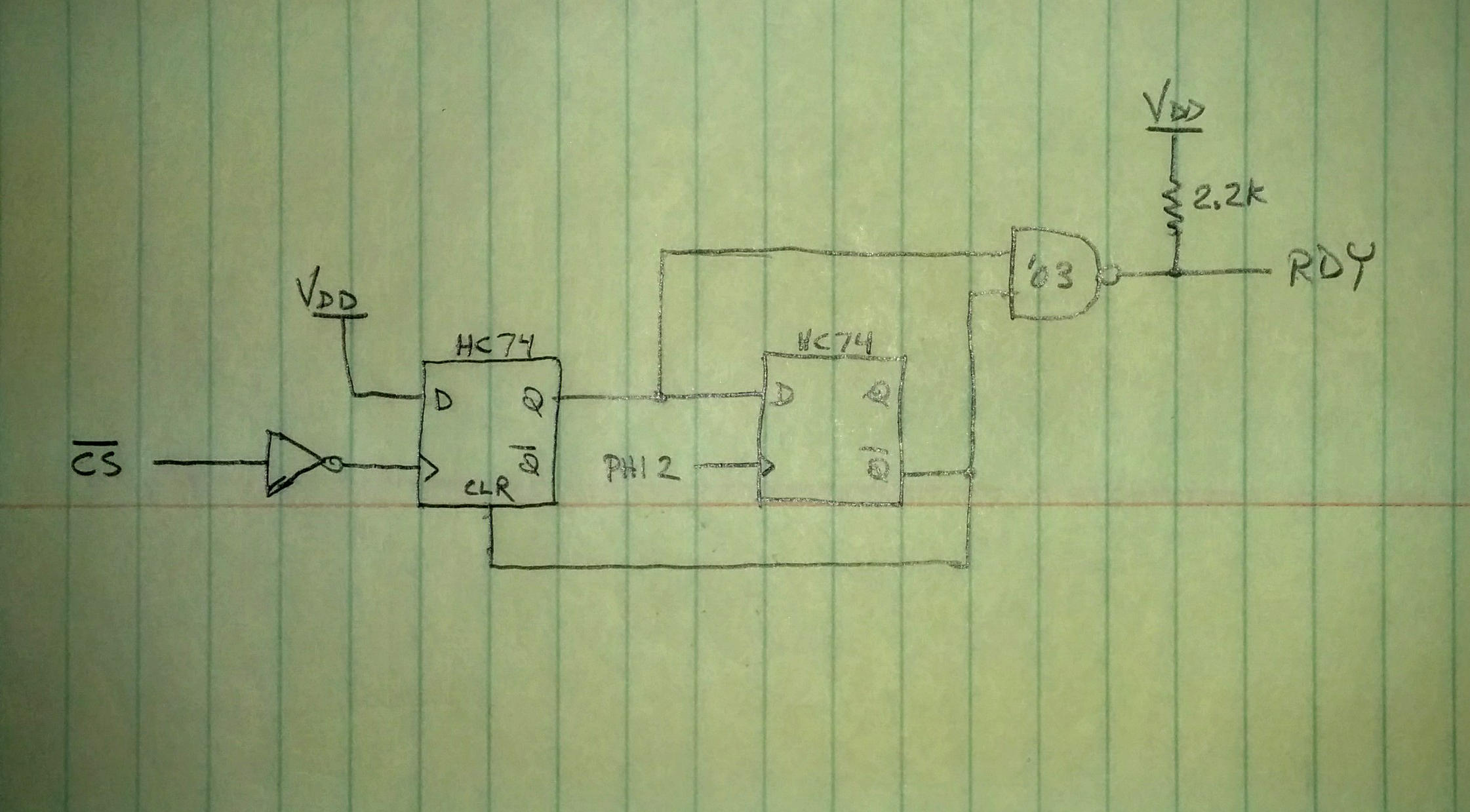

OK, a little further thought and I came up with this circuit to generate a 1-wait-state delay when CS is asserted on a slow device:
There are probably more clever ways to do it as well, probably using a counter instead of the second FF which would have the added benefit of allowing you to select more than one wait state. Since I only need one at the moment, this should do. Unfortunately, I need to find room for another HC74 on the breadboard since I need separate asynchronous clears.

Maybe you'll find this useful. Michael collected my circuits for a single wait-state and for dual wait-states here. (Thanks, Michael!)
Note that, for a system running close to specified limits, a single wait-state roughly triples the time available for the slow device (eg EPROM) to respond -- details here.

Edit: I see another flaw in my second circuit above that will prevent it from working properly. It will asynchronously lower RDY until the next rising edge of PHI2 which will happen during the same cycle -- not the next cycle as I intended. So I need to modify it again by either adding another FF or replacing the second FF with a counter.
I see that Jeff's circuit is 100% synchronous to the PHI2 clock -- A close examination of the 65c02 timing diagrams suggests that this approach should work fine and will greatly simplify the logic required.

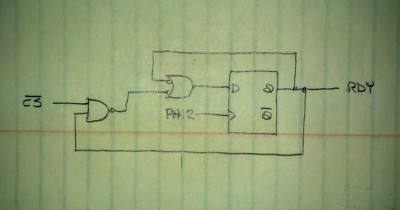

The essential innovation I was missing is that the wait state generator can be synchronous with the rising edge of PHI2. Here is Jeff's circuit converted to work with a standard DFF. The JKFF version is still better because the logic paths are shorter, but since I already have 1/2 a spare 74HC74 on the board and a couple of spare NAND gates, this should be equivalent:

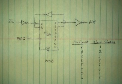

OK, since I've spent so much time thinking about generating wait states recently, I figured I'd wrap things up with this circuit which will generate anywhere from 1 to 8 wait states depending on how you hook it up:
Thanks to Jeff for putting me on the right track with his two existing wait state circuits.
And Jeff is right that RDY is open-drain on the 65c02 so I would be using a 74HC03 for the inverter between the HC164 A output and the RDY line with a suitable pullup resistor on it (see my earlier circuits for examples). 2.2k is probably reasonable for lower speeds, but 1k or even lower if you're running 10 MHz+. The exact value depends on speed and loading and your best bet is to hook an oscilloscope up and make sure the slew rate is reasonable when RDY is pulled high. I would be uncomfortable just using a serial resistor here unless this was the only circuit connected to the RDY line in which case it should be OK so long as it was large enough to prevent more than a few milliamps through it and small enough to raise the signal quickly after the 65c02 is done holding it low (e.g. after a WAI instruction).

Just put a 22pF capacitor across the resistor and you'll be fine for any speed, even with a much higher resistance.
There may be some undesirable effects (e.g. droop) in cases where you are rapidly switching between logic states if your series capacitor holds too much charge, but that just means you'd need to switch to a smaller valued capacitor.
Thanks for pointing this out. I still like the wire-OR arrangement as it's a more general solution, but direct drive via a parallel RC combination is useful especially for those cases where you only have one slow peripheral on your bus.

The tiny input capacitance of the RDY input, combined with the resistor by itself, form a pole. Putting the capacitor across the resistor cancels that pole. The two capacitances do form an AC voltage divider, but if the RDY input has 5 or 10pF, the voltage swing will still be enough with the 22pF across the resistor. As long as there's no pull-up or pull-down resistance (and the input DC current is negligible), there will be no overshoot or droop problems. Do a LaPlace transform on it if you like; but an oscilloscope probe will have enough capacitance to change the circuit and misrepresent what's going on there when the probe is not connected.
