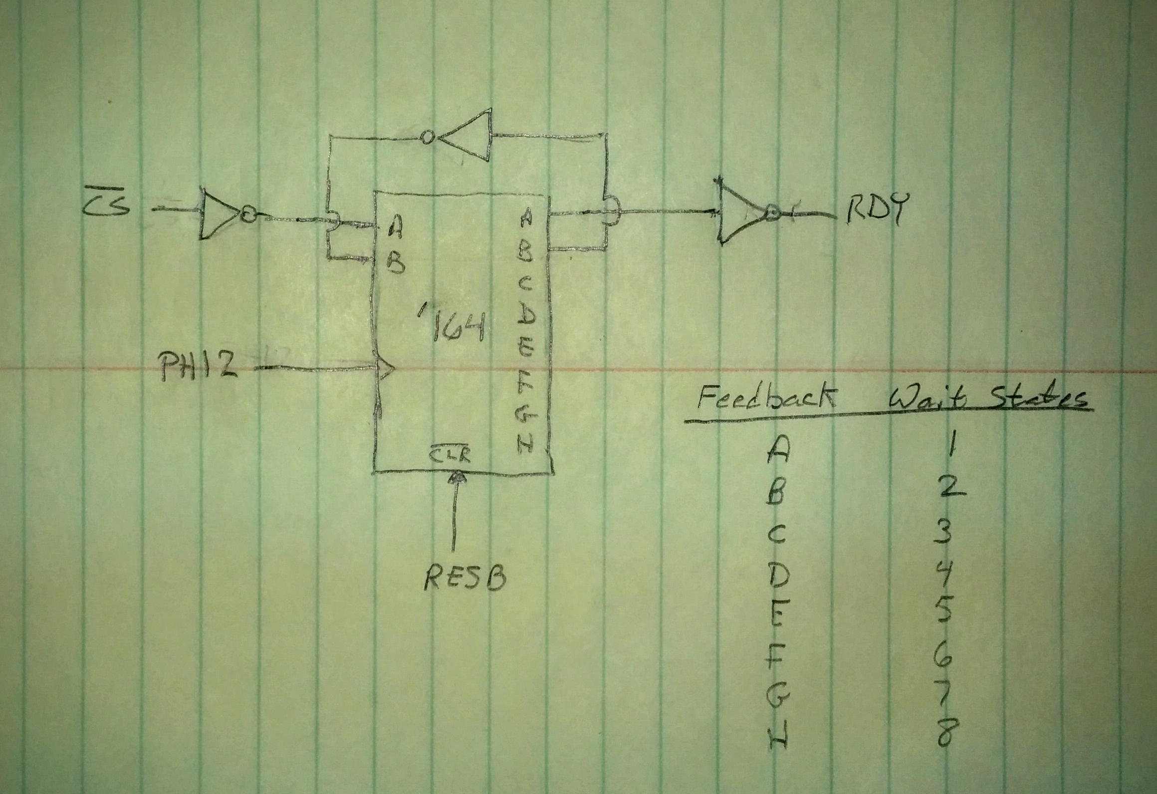

OK, since I've spent so much time thinking about generating wait states recently, I figured I'd wrap things up with this circuit which will generate anywhere from 1 to 8 wait states depending on how you hook it up:
File comment: 1-8 wait state generator
Thanks to Jeff for putting me on the right track with his two existing wait state circuits.
And Jeff is right that RDY is open-drain on the 65c02 so I would be using a 74HC03 for the inverter between the HC164 A output and the RDY line with a suitable pullup resistor on it (see my earlier circuits for examples). 2.2k is probably reasonable for lower speeds, but 1k or even lower if you're running 10 MHz+. The exact value depends on speed and loading and your best bet is to hook an oscilloscope up and make sure the slew rate is reasonable when RDY is pulled high. I would be uncomfortable just using a serial resistor here unless this was the only circuit connected to the RDY line in which case it should be OK so long as it was large enough to prevent more than a few milliamps through it and small enough to raise the signal quickly after the 65c02 is done holding it low (e.g. after a WAI instruction).
PostPosted: Fri Oct 16, 2015 8:31 pm
Just put a 22pF capacitor across the resistor between the totem-pole gate and RDY (and don't use a pull-up resistor) and you'll be fine for any speed, even with a much higher resistance.

PostPosted: Fri Oct 16, 2015 9:11 pm
Posts: 171
Location: Philadelphia, PA
Just put a 22pF capacitor across the resistor and you'll be fine for any speed, even with a much higher resistance.
OK, I see that. The capacitor would help because the parallel RC combination acts like a high pass filter and there is a lot of high frequency energy in the step function (approximated by a logic transition). That energy will be rapidly transferred by the capacitor and if large enough would be sufficient to change the output voltage enough to switch states by itself. The resistor, in this case, only need be large enough to overcome any leakage resistance, which should be negligible for CMOS logic.
There may be some undesirable effects (e.g. droop) in cases where you are rapidly switching between logic states if your series capacitor holds too much charge, but that just means you'd need to switch to a smaller valued capacitor.
Thanks for pointing this out. I still like the wire-OR arrangement as it's a more general solution, but direct drive via a parallel RC combination is useful especially for those cases where you only have one slow peripheral on your bus.
PostPosted: Fri Oct 16, 2015 9:48 pm
The tiny input capacitance of the RDY input, combined with the resistor by itself, form a pole. Putting the capacitor across the resistor cancels that pole. The two capacitances do form an AC voltage divider, but if the RDY input has 5 or 10pF, the voltage swing will still be enough with the 22pF across the resistor. As long as there's no pull-up or pull-down resistance (and the input DC current is negligible), there will be no overshoot or droop problems. Do a LaPlace transform on it if you like; but an oscilloscope probe will have enough capacitance to change the circuit and misrepresent what's going on there when the probe is not connected.
