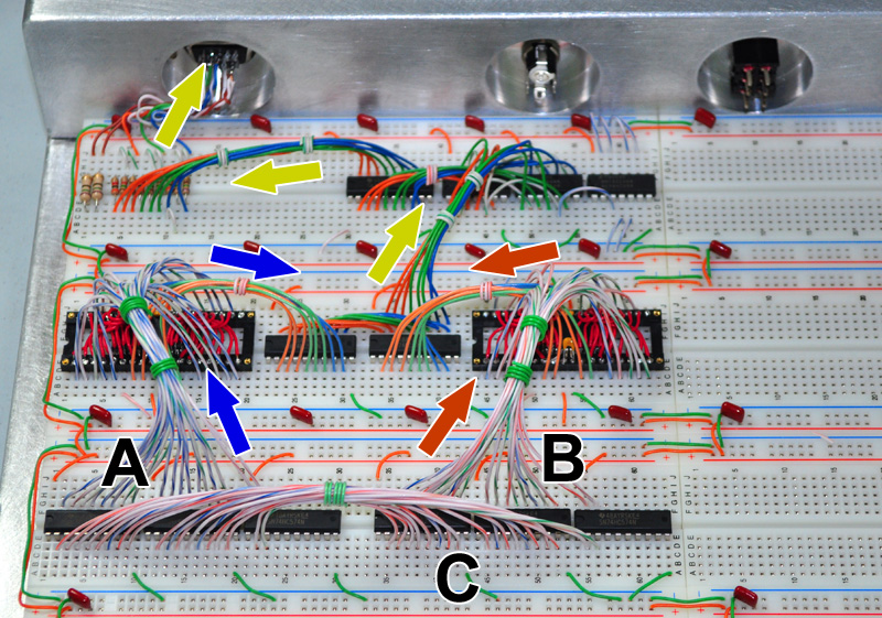

Finished the wiring for the output section of the double buffered video subsystem.
Address and Data switching from both Video Memories.
The CPU or GPU has full access to one bank of video memory while the other is being driven to the monitor by the frame generator subsystem.
Address paths A and B are connected to a set of switched 74HC245s (not connected yet), allowing the CPU and GPU access to whichever SRAM is not being fed from path C by the frame generator logic. Path C is switched by the 74HC574's with their inputs connected together. The data paths are similar, and switching is accomplished by a single IO line that switches everything on the low edge of the vertical sync pulse.
Any path that exceeds 40 nanoseconds is buffered by a 74HC574 synced by the main 20MHz clock, so typically no path exceeds 2 ICs.
Red and blue are the 2 possible pathways through either SRAM, and yellow is the data path from whichever SRAM is "Live" to the DAC feeding the VGA monitor.

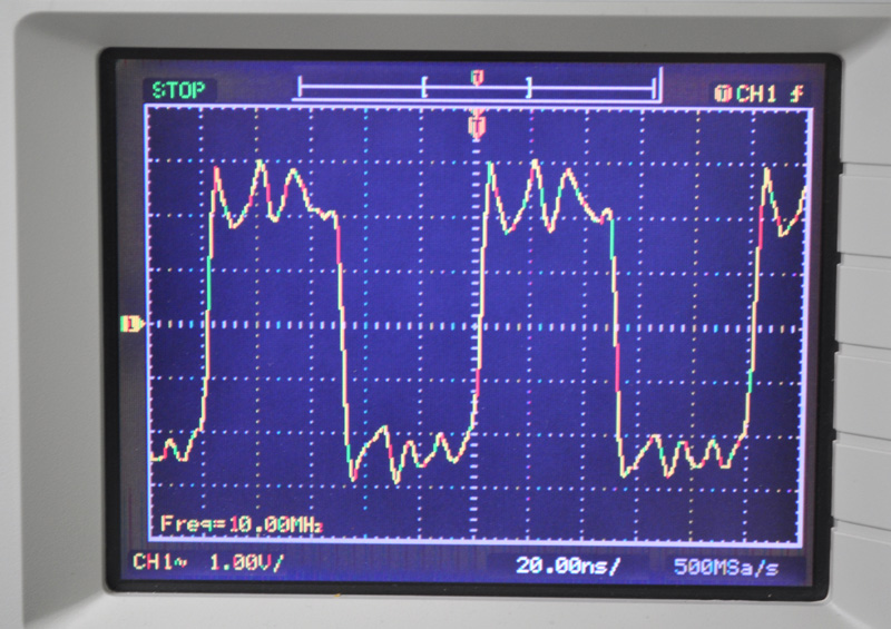

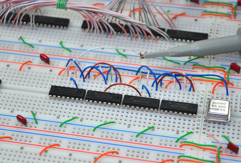

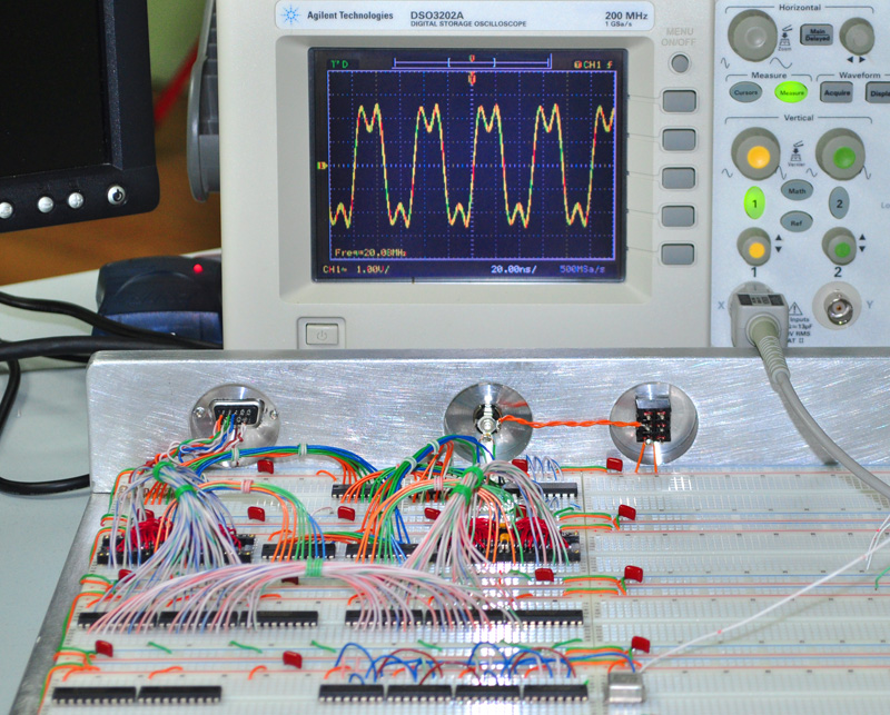

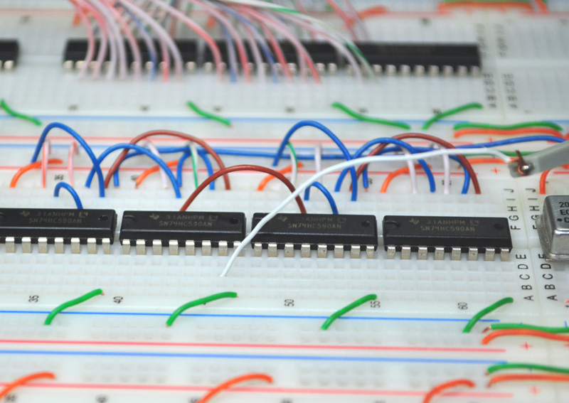

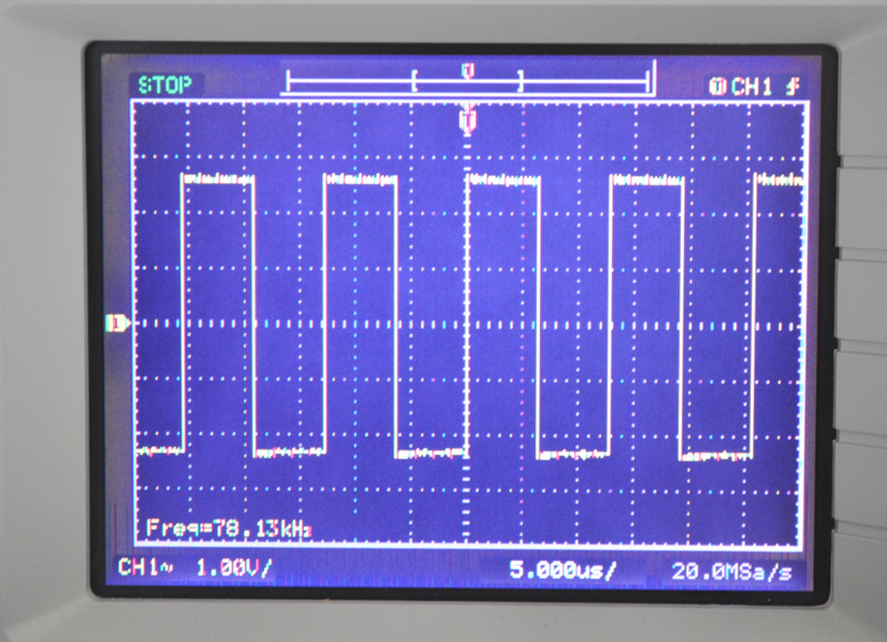

Hooked up the address counters for cascaded operation and probed the board to test the clock signal.
There are 2 counters for each address - X and Y, which are 9 bits each.
Main clock running at 20 MHz.
Probing bit 0 of the X address counter.

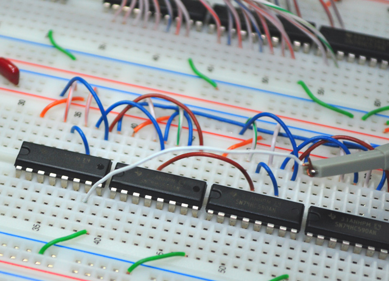

Each bit divides the clock by 2. Bit 0 results in 10MHz.
Probing bit 7 of the X address counter.
20 MHz divided by 256 equals 78.125 KHz

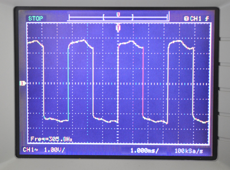

Probing the 15th bit of the cascaded counter pair.
20 Mhz divided by 65536 equals 305.176 Hz.
Seems the address counters are ready to go.

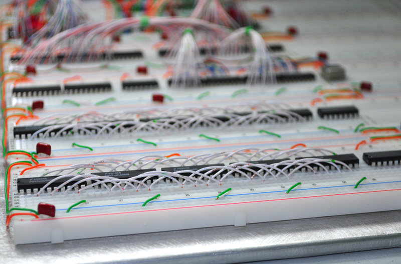

Added the connecting wires to chain both rows of 74HC688 comparators together...
There are 5 comparators for the horizontal sequence and 5 for the vertical sequence.
Comparators are wired for 9 bit operation by tricking the OE through an inverter.
The unwired chips to the right of each row are flip-flops, which will drive sync pulses and blanking periods.
That's all the time I have for this weekend. Should have random pixels by next week.
