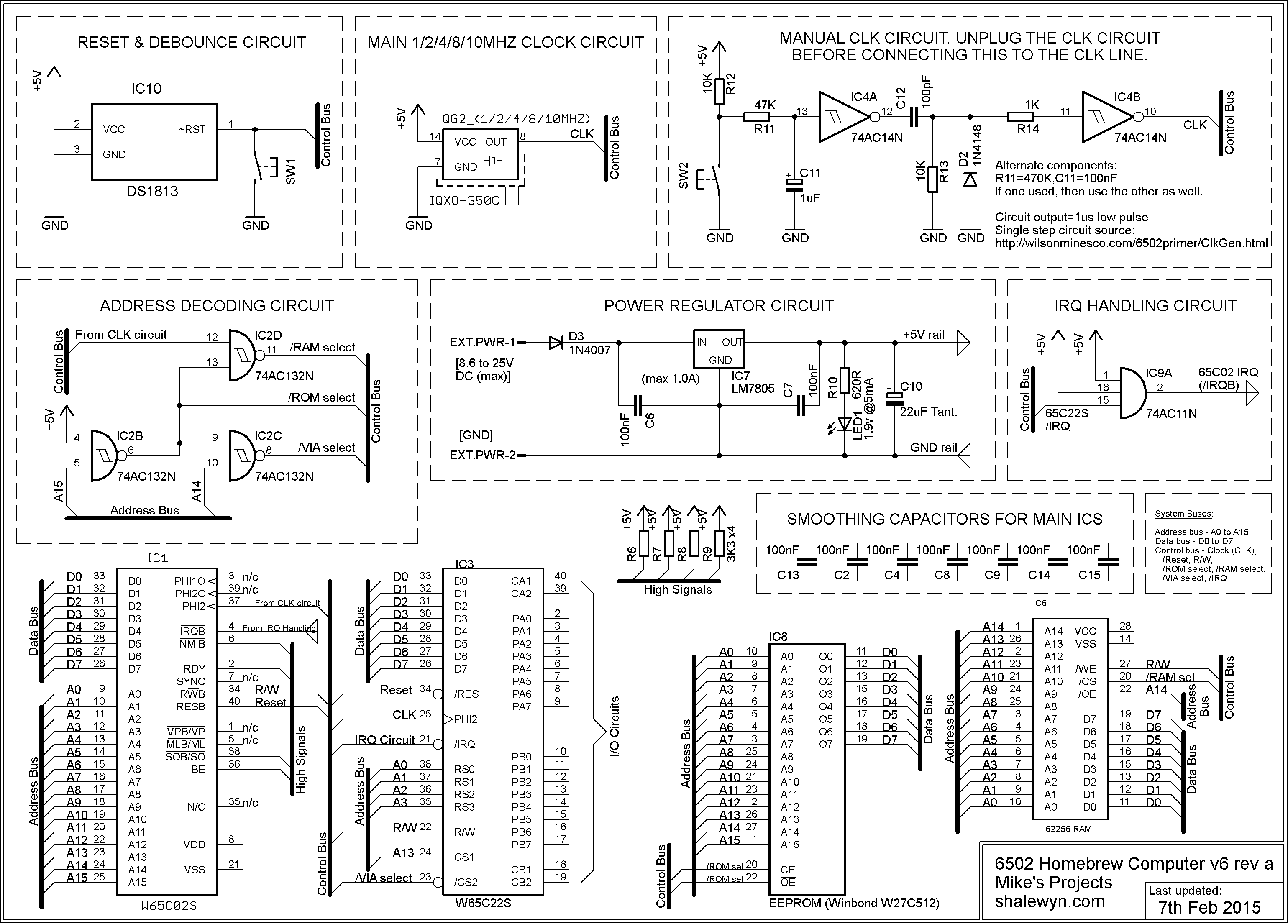

Thanks for the responses, guys.

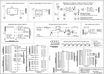

The circuit diagram is attached below.
Your 55ns SRAM is probably running right on the ragged edge, as it can only be reliably read or written during Ø2 high. Also, EPROMs tend to generate significant transients on Vcc during chip enable, so you may need to pay closer attention to bypassing in that area.
It seemed to be the case with the 70ns Hitachi I had fitted as it could barely cope with 8MHz. I replaced it with a Toshiba 70ns one which allowed for 10MHz. As that seems to work, I thought that putting in a 55ns one would allow for another 2MHz up to 12MHz.
However, it could be the lack of star ground plane on the project if everyone else is not having issues at 12MHz with these speed devices. I do have 100nF decouping caps on the VDD-GND pin on every other device. I'll put more on just to be sure.
With regard to the clock: My oscilloscope is a 25MHz Owon so will only give me a stable wave form up to 2-2.5MHz so it's hard to check as I don't know if what I'm seeing is right.
How should the distribution of the clock be set up? Mine's a bit haphazard as I ran out of space coming off of the oscillator can.

Looking at your schematic, I see you have the CAN oscillator driving the CPU, the 65C22 and the decode logic. On my 2-board board setup, I use the Phase 2 clock output from the CPU (pin 39) to drive everything else, the CAN oscillator only drives the CPU directly. You might want to try swapping that over as it decreases the load on the main clock. Also, I use a 74HC00 to take the CLK and R/W lines to generate Phase 2 qualified memory Read and Write lines which go to both the RAM and EEPROM (I have code that allows programming the EEPROM insitu).

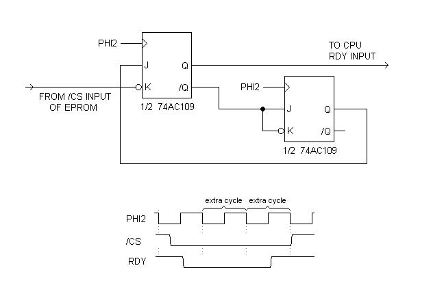

The ROM-to-RAM copy approach has some interesting advantages. But sometimes we want to "just make the darn EPROM work"! -- using the simplest means possible. :?
Generating wait states:
simple wait-state generator.gif (4 KiB) Viewed 11392 times
The circuit above generates a one-cycle-long wait state when the EPROM is accessed. (For WDC, it's best to add a series resistor -- see below.) One wait state may not sound like much; but, when you're pushing the CPU close to its maximum clock rate, adding one wait-state roughly triples the time available for the EPROM to respond! Here's why. At high clock rates tADS and tDSR delays (which each consume a fixed number of nanoseconds) end up accounting for about 50% of all the nanoseconds in a clock cycle. (65xx timing is graphically explained in the Visual Guide to 65xx CPU Timing).
The access time remaining for memory to do its job works out to roughly 50% of the nanoseconds in one clock cycle. Adding a one-cycle-long wait state changes this figure from 50% to 150%. (The tADS and tDSU delays don't get applied again when a wait-state cycle is inserted.) Stated another way, if the cycle time is 100 ns, say, then adding a one-cyle-long wait state increases the available memory access time by 100 ns.
ETA: There's an implicit assumption. The circuit only works if /CS goes low before the rise of Ø2 -- which is normally the case. BDD touches on this in the following post. Also: using the both halves of the '109, two wait states can be provided (see circuit below). The extra access time thus provided will be 200% of one cycle. The total access time will be about 5 times what's available using no wait states.
double-wait-state generator.gif (4.32 KiB) Viewed 11379 times

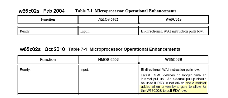

Further edit: in contrast to Rockwell and other suppliers, WDC makes the RDY pin bi-directional. A WDC 'C02 or '816 will pull its own RDY pin low as a result of executing a WAI instruction. This can result in excessive current flow if the RDY pin is driven high by external logic at the same time.
One solution is to use an Open-Collector or Open-Drain gate to drive RDY (as shown in the upper diagram in image below) but this limits the ability for RDY to quickly return high. It's better to use an ordinary gate and simply include a series resistor to limit current flow (lower diagram).
WDC's datasheet was revised to include a comment about the series resistor (as well as a comment about pullup resistors).
Unfortunately WDC doesn't suggest a value for the series resistor, so let's look at that question. Too low a value means increased dissipation, and the risk that a valid logic-low voltage won't be achieved. OTOH too high a value will produce unacceptable delay re the RC of the gate and resistor driving the capacitance of the RDY input. I myself would use a series resistor of around 470 ohms -- a rather low value, but IMO not so low as to prevent a valid logic-low voltage from being achieved. In another thread Garth suggests putting a small (~22 pF) capacitor in parallel with the resistor, which allows use of a much higher resistance but of course increases the component count slightly.
bi-directional RDY re WDC 02 and 816.gif (9.15 KiB) Viewed 11244 times

Something I noted is that it appears that you are gating the SRAM chip select with Ø2. That is generally not good practice. The problem as it stands is that the SRAM will not respond to chip select until sometime after Ø2 has gone high, which will set a hard limit on performance. It's better to select the SRAM (and ROM) as soon as a valid address appears on the bus, which is early during Ø2 low, and then gate /OE or /WE on the rise of Ø2. That way, all of the Ø2 high period is available to read or write.
Also, many SRAMs respond faster to /OE and /WE than to /CS. So the procedure I recommend (and use in POC) is to assert /CS as soon as the address is valid and then assert /OE or /WE only when Ø2 rises. As an example, the SRAM I'm using in POC V1.1 is guaranteed to respond to /CS in 12ns or less. If /CS is already asserted and /OE is then asserted, the SRAM will drive the data bus in 6ns or less. If /OE is already asserted and /CS is used to gate the device the elapsed time until the SRAM starts driving D0-D7 is 12ns.
I also saw a mention of the using the clock outputs of the 65C02 to drive all the other devices that need to know about the clock, and only driving the 65C02 from the Ø2 clock generator. Here's what WDC has to say about it:
  • 3.8 Phase 2 In (PHI2), Phase 2 Out (PHI2O) and Phase 1 Out (PHI1O)
    Phase 2 In (PHI2) is the system clock input to the microprocessor internal clock. During the low power Standby Mode, PHI2 can be held in either high or low state to preserve the contents of internal registers since the microprocessor is a fully static design. The Phase 2 Out (PHI2O) signal is generated from PHI2. Phase 1 Out (PHI1O) is the inverted PHI2 signal. An external oscillator is recommended for driving PHI2 and used for the main system clock. All production test timing is based on PHI2. PHI2O and PHI1O were used in older systems for system timing and internal oscillators when an external crystal was used.
In other words, WDC does not recommend the use of PHIO1 and PHIO2 in new designs. You should also consider the fact that PHI1O and PHI2O lag Ø2 by an amount that is not specified.
