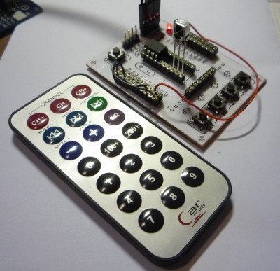

If it isn't off-topic, may I ask if anyone has tried using an infrared remote control as a keypad for a system project? This little HX1838 Remote uses one of the NEC IR protocols and currently sells for $1.69 USD on eBay (including shipping to USA);
I'd like to try using something like this as the keypad on a 65SC04 demo board design (see one of my board layout candidates below). The NEC protocol timing is based on ~562.5 microsecond intervals. Does anyone foresee any problems trying to implement receive code for this on a 1-MHz system?
Thanks in advance...
Regards, Mike
