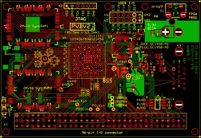

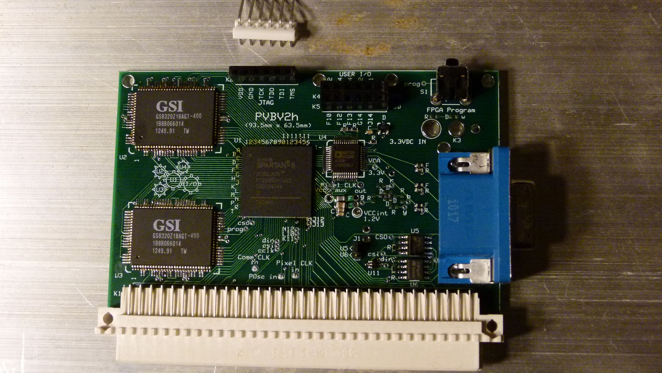

Update: Pic

I finished soldering in everything on top and bottom except the SyncRAM bypass caps.
Checked for short from power to GND and one did exist. After visually inspecting everything I decided to apply power to see where the smoke would come out, in order to save time. The top part of U3 (SyncRAM #2) let out a puff of smoke. After removing U3, the short was gone. After checking the PCB layout I did find where the Vdd & Vss were switched in 1 spot. I've absolutely no idea how that happened, but I'm happy that it's been resolved quickly. That would have been extremely difficult to track down.
I'm now attempting to get the old video project from PVB1 to pass synthesis with the new constraints and see if ISE recognizes the JTAG section.
PostPosted: Sun Jan 18, 2015 7:10 pm
Jeez, got 2 wires switched in JTAG! This board :oops:
ISE sees the FPGA and sees the SPI FLASH. It can program the FPGA very quickly direct, or it can program the 16Mbit SPI FLASH which is pretty slow. It verifies successfully using both methods, so this is good news at least. I can go on to experiment without having to pay for another set of boards.
I guess a reasonable goal would be to get the video working like it was on PVB1, although I'm done for a couple days I think. Time to start some seeds indoors for a summer crop.
Also, I don't think my SPI FLASH MUX circuit is going to work. I'll have to investigate multiboot from SPI FLASH. I've read of problems a couple years ago on the Xilinx forums. Maybe they have it sorted out now.
PostPosted: Mon Jan 19, 2015 9:44 pm
I couldn't keep away, I realized all I had left was to finish the .ucf constraint file for the oscillator input from the DS1085L...
Got the video working after abit of a struggle. First the board was being fed 5VDC, not the intended 3.3VDC. All the IC's seemed to tolerate this out of spec power supply voltage. At one point I'm sure the board was powered for over a minute. Obviously I don't recommend this.... Hmmm, now that I have it working, I will do another test with 5VDC and see what the video output looks like!
So after this voltage problem was corrected (long story), I got a very wavy and noisy picture. I figured it was either that I just semi-destroyed the IC's, or my bad bypassing scheme for the FPGA, or it was the source of the original clock which was the DS1085L. I was using the default output of 24.29MHz from the DS1085L and then used a PLL in the FPGA to achieve 149MHz for the project, 148.5 is necessary for 1080p standard which is what I'm aiming for. After wiring in a 100MHz can oscillator for the main FPGA clock, all noise and 'waviness' disappeared and I now see what I saw in PVB1. Success! I'm working on PVBV2i now and will order it soon.

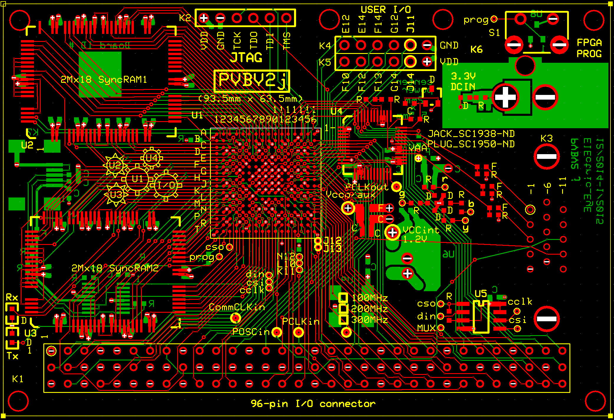

PVBV2.j is in the 'chute'!...
I knew the first run (PVBV2.h) would be screwed up in some way, somehow, no matter how cautious I tried to be. So I had a very itchy 'trigger finger' to send the design off for manufacture more quickly than other designs I've done.
However, I'm confident the errors have been boiled out now, and in about a week it's time to start having fun again.
I'll explain more about the board's expected capabilities soon with the USB mini port and USER I/O connector.

The mini USB connector (K7) on PVBV2.j should be able to connect to a modern PC through the FTDI230X as a slave device in order to receive data from a terminal program. I've done it before successfully at over 1Mbit/sec, although it was with an MCP2200. They also have Win drivers. I decided to try to expand my horizons since the FTDI IC has been highly regarded.
Also, the user I/O connectors (K4,K5), can easily be made to interface from the FPGA to an I/O Device with 8 signals, 2 clocks, power and ground. I plan to use it, initially, for a 6-pos mini din PS/2 Keyboard Interface. I will show how.

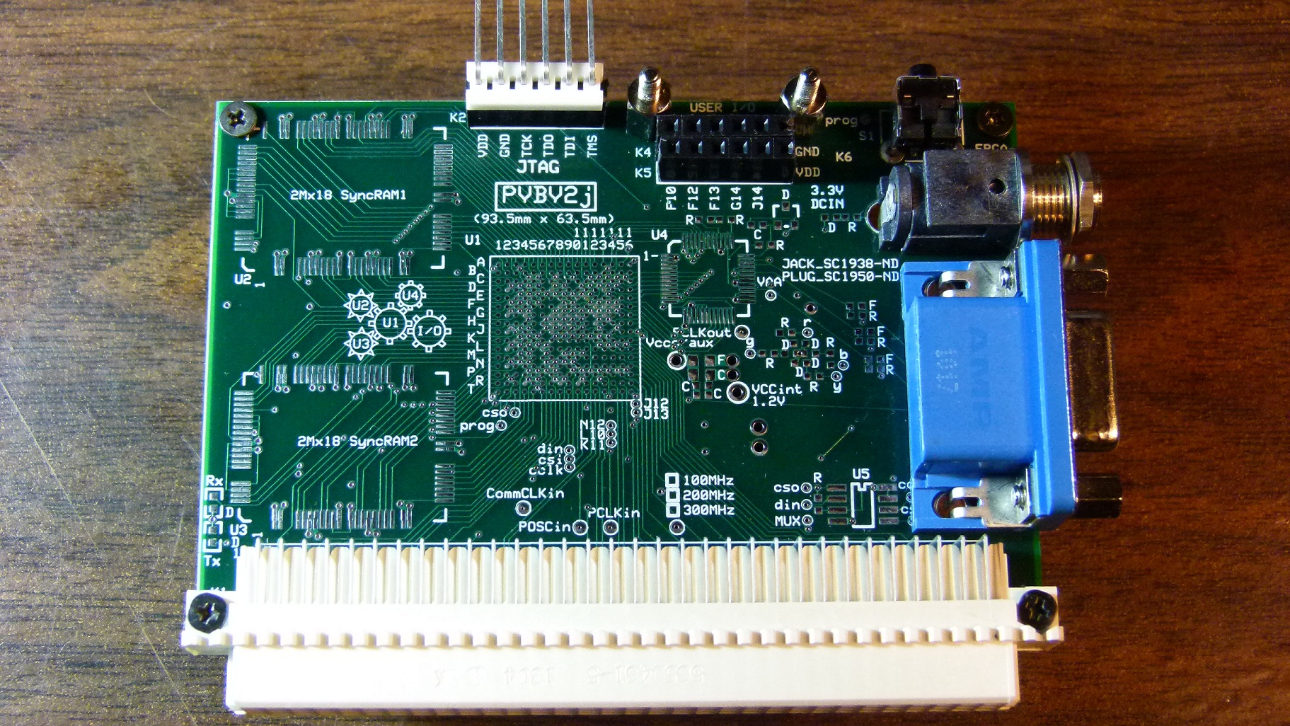

No soldering yet. Just getting a feel for the placement.
