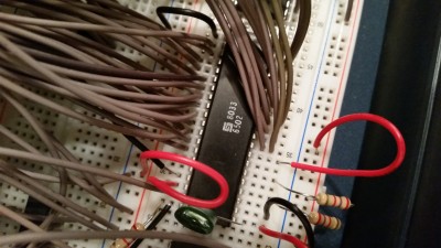

I am wanting to build a small setup, but I am needing to confirm if this 6502 is legit. Thanks!
PostPosted: Wed Nov 26, 2014 7:58 am
Posts: 8546
Yep, a Synertek SYP6502 made in the 33rd week of 1980.
