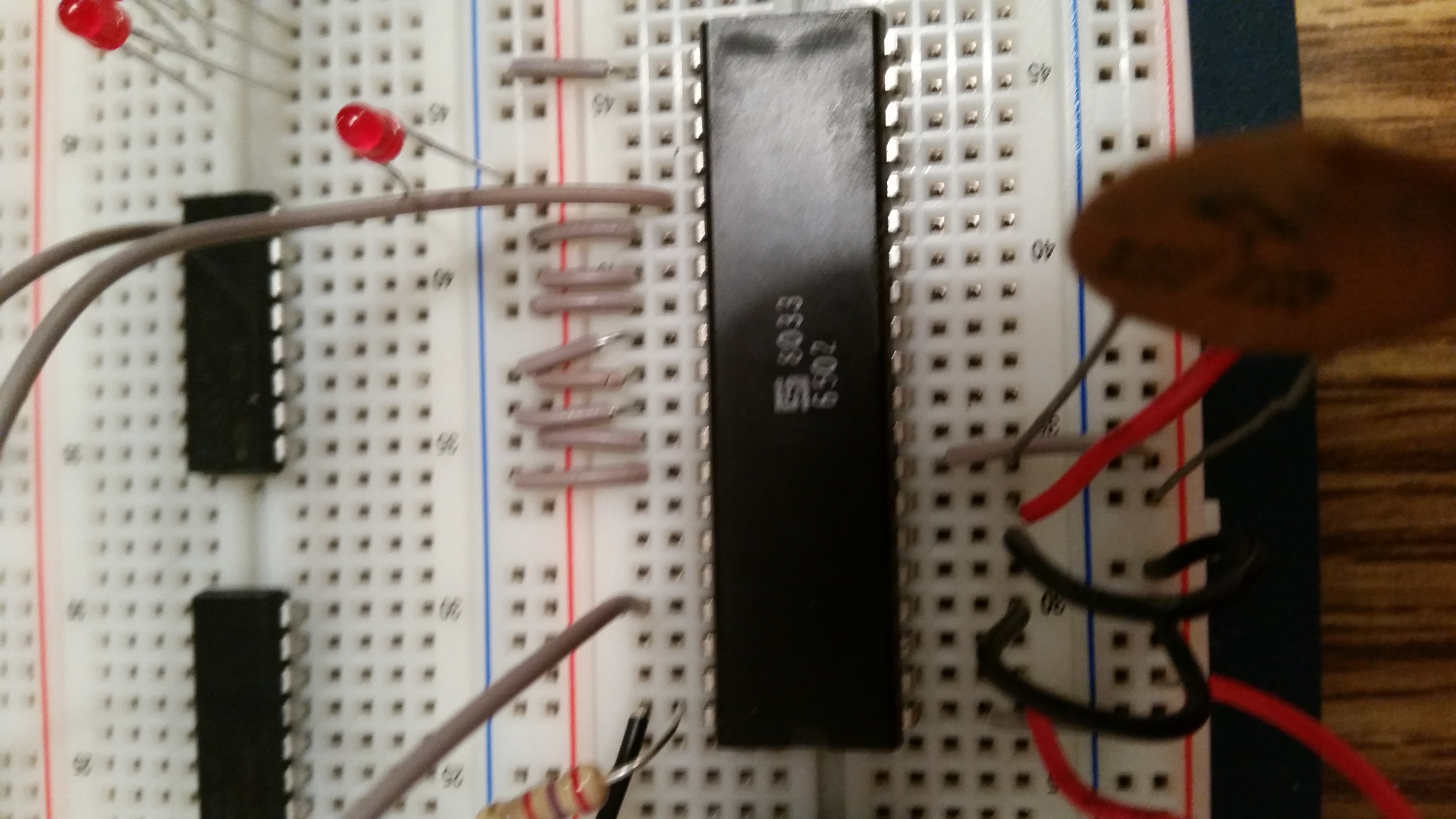

Hello. Is this a 6502?
Greetings,
I am wanting to build a small setup, but I am needing to confirm if this 6502 is legit. Thanks!

Re: Hello. Is this a 6502?
Yep, a Synertek SYP6502 made in the 33rd week of 1980.

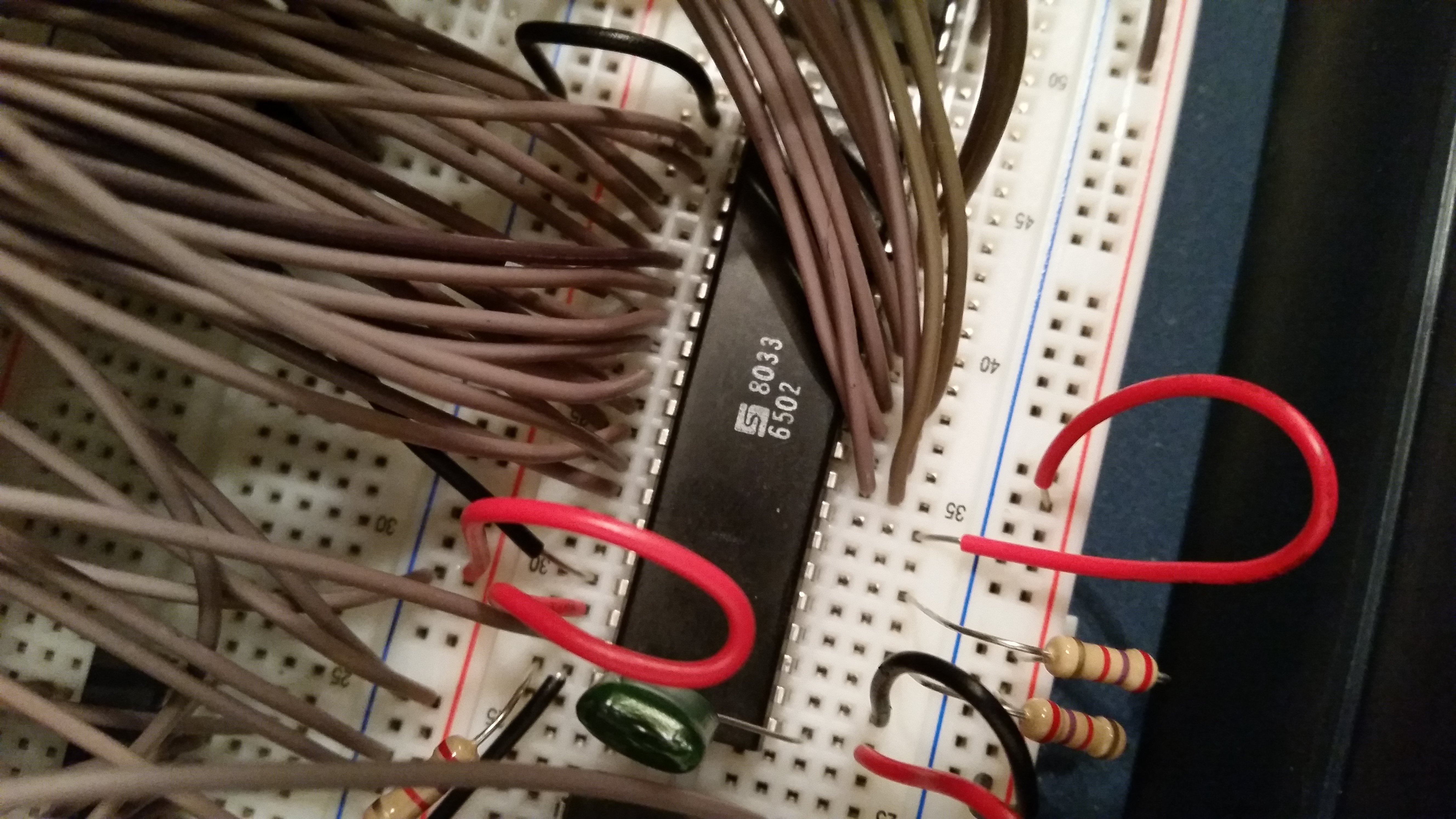

Ok. So to try to get this up and running, I am setting it for the NOP code. It comes on, the lights toed to the address bus are randomized and then it cuts off. Same result when I remove the clock. Any ideas?
Do you have resistors in series with the LEDs? Without them, the processor and other things on the buses won't be able to pull up high enough for a valid "1," because a red LED is kind of like a 1.7V zener diode. Put about a 1K resistor in series. Also follow the troubleshooting process on that page of the 6502 primer, at http://wilsonminesco.com/6502primer/debug.html . Do you have a clean reset signal? Valid clock signal, at the expected frequency? Are address and data lines toggling, and going high enough and low enough to be valid 1's and 0's? What's the power supply voltage at the power and ground pins of each IC? How's the power supply current? Is IRQ\ or NMI\ going down unexpectedly?

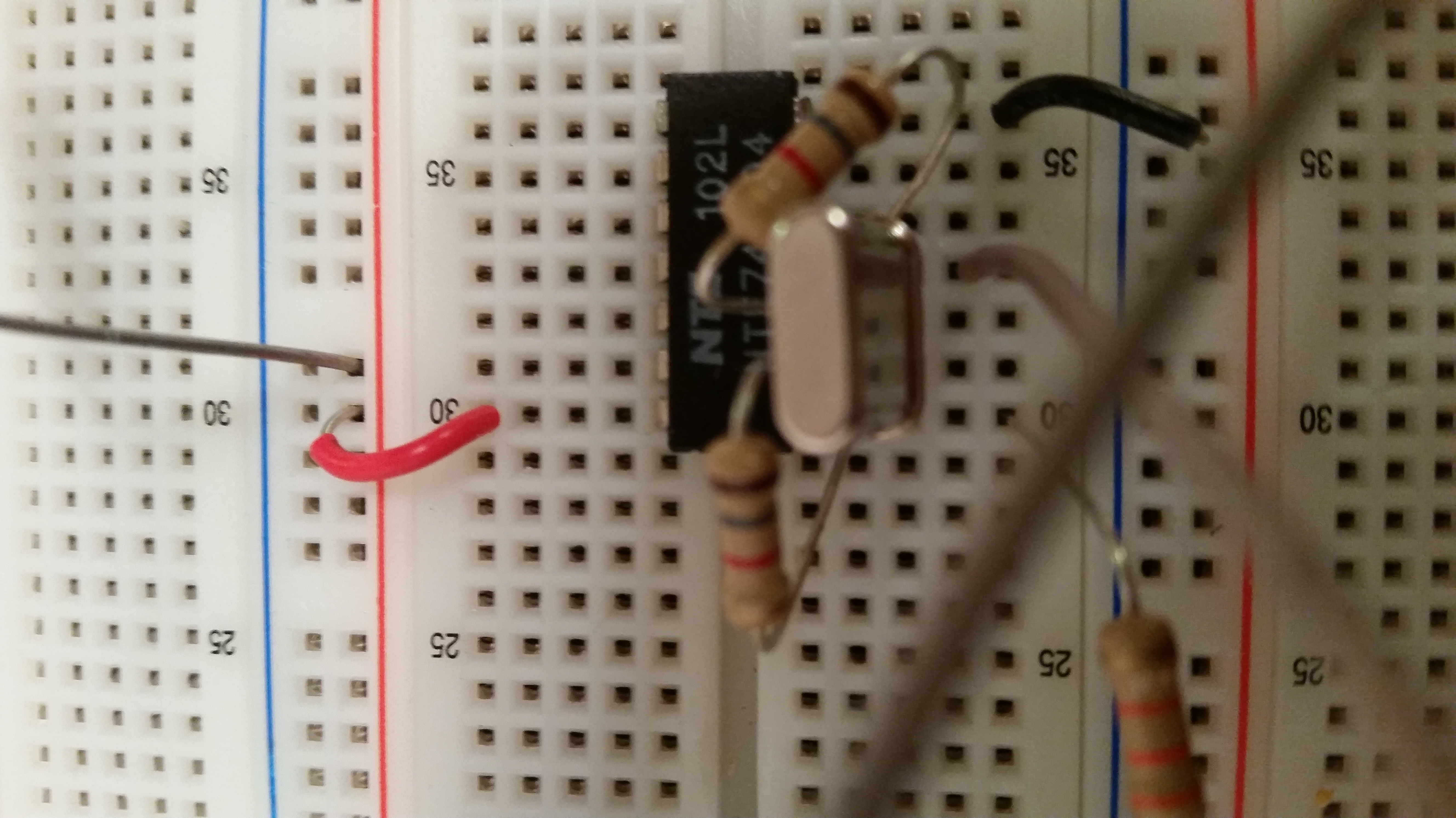

I have a 330ohm in series with the led. And 3.17k for NMI and IRQ. With a logic circuit I built on the top of the board I am not getting a clean high or low on 4 and 6. My clock signal should be clean, but I wont jave access to a scope until Dec 8th. Its clocked at 2MHz with a 7404 and a 1.8 across 1 and 2, 3 and 4, with the crystal going across 1 and 4. I have a 330k going from pin 1 to ground. For my reser I have a 2.7k on 40 to vcc, and a line going to my trigger, with a 10microF cap to ground, and othe side of the switch to ground.
I removed all the leds and just put on off A15. And not getting anything.
My power is 4AAAs going through a 7805.
It does sound primarily like a clock problem. The reset circuit, not being debounced, is not adequate, but is probably not what's keeping it from toggling the address lines. The 7805 takes about 1.5V minimum, so if you're starting with 6V from the batteries if they're pretty new, you'll only get 4.5V out of the 7805, which is below spec. for the processor but probably not low enough to keep address lines from toggling.

Is 2MHz too high since my chip is non-suffixed?
If it had an "A" on the end, it would mean it passed the tests to be sold as 2MHz. Since it does not have any letters after its name
, it means it did not pass for 2MHz or more. Might it run at all at 2MHz? Maybe, if the other parts are fast enough, meaning it would need help from the supporting parts being able to run on decreased timing margins; but you're also running it below the specified power supply voltage of 4.75V-5.25V, one of whose effects will be to further slow it down.
