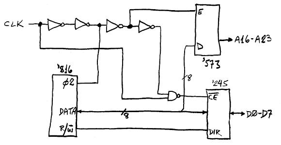

Jeff, yes, I keep thinking about the next-generation workbench computer, and I would like to try the DDD adjustable delay lines to get the best performance. As for your musing on page 1,
Stated another way, the dead time is zero even before a margin is subtracted for variability in logic and tri-state delays. Of course the variability might trend in your favor, creating a dead time. But it equally might trend the other way and create bus contention. I'm not aware of any really good solution for this
something to this effect might do it, if I didn't get too hurried and mess up (not showing any adjustable delay lines):

Nice, Garth -- I like how the duration of the 245's enable time is curtailed by the NAND pulse-shrinking circuit. That gives a bit of dead time to serve as a timing cushion and prevent bus contention between the 816 and the '245. But, as you know, a too-generous cushion will cause you to fall short of the 816's true performance potential, and that's where the variable delays come in. (I realize your diagram omits the variable delays units.)

The diagram was just to show the idea. Since there's no minimum prop. delay spec., it would be hard to know what you'll end up with unless you can measure with nanosecond resolution and plug in different ICs until you find the one that gives the delay you want. It will vary some with temperature, but not enough to cause problems in this case.
