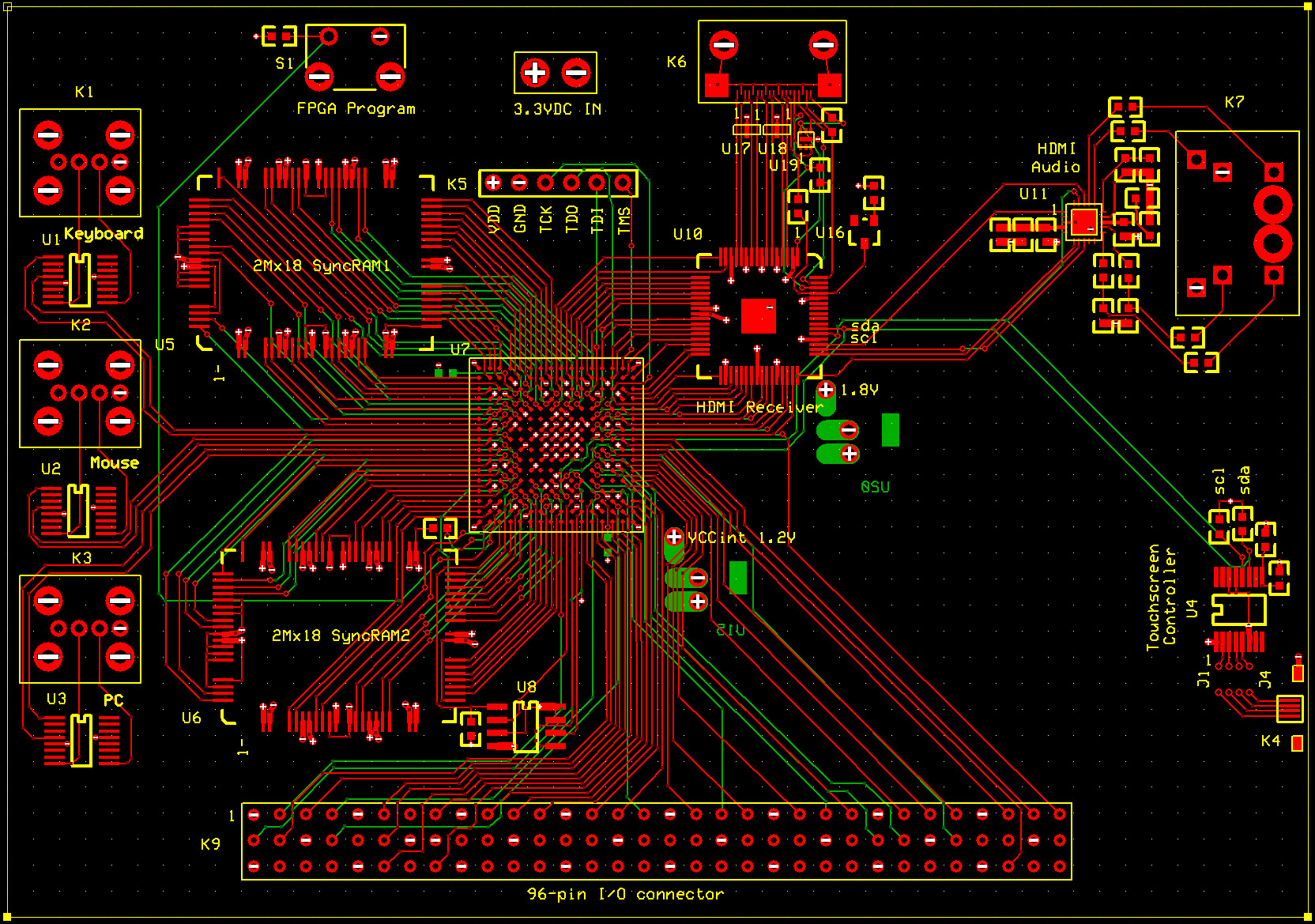

HDMI Receiver wiring almost complete. The HDMI connector wiring is a little hairy, I'll need to review the circuit description again to see if I actually need everything. I was working strictly from the Analog schematics.
Running out of spare pins, only 33 left.
Bottom pic shows the internal power planes for the 1.2V and 1.8V core voltages needed for the FPGA and Receiver on the 3.3V layer.

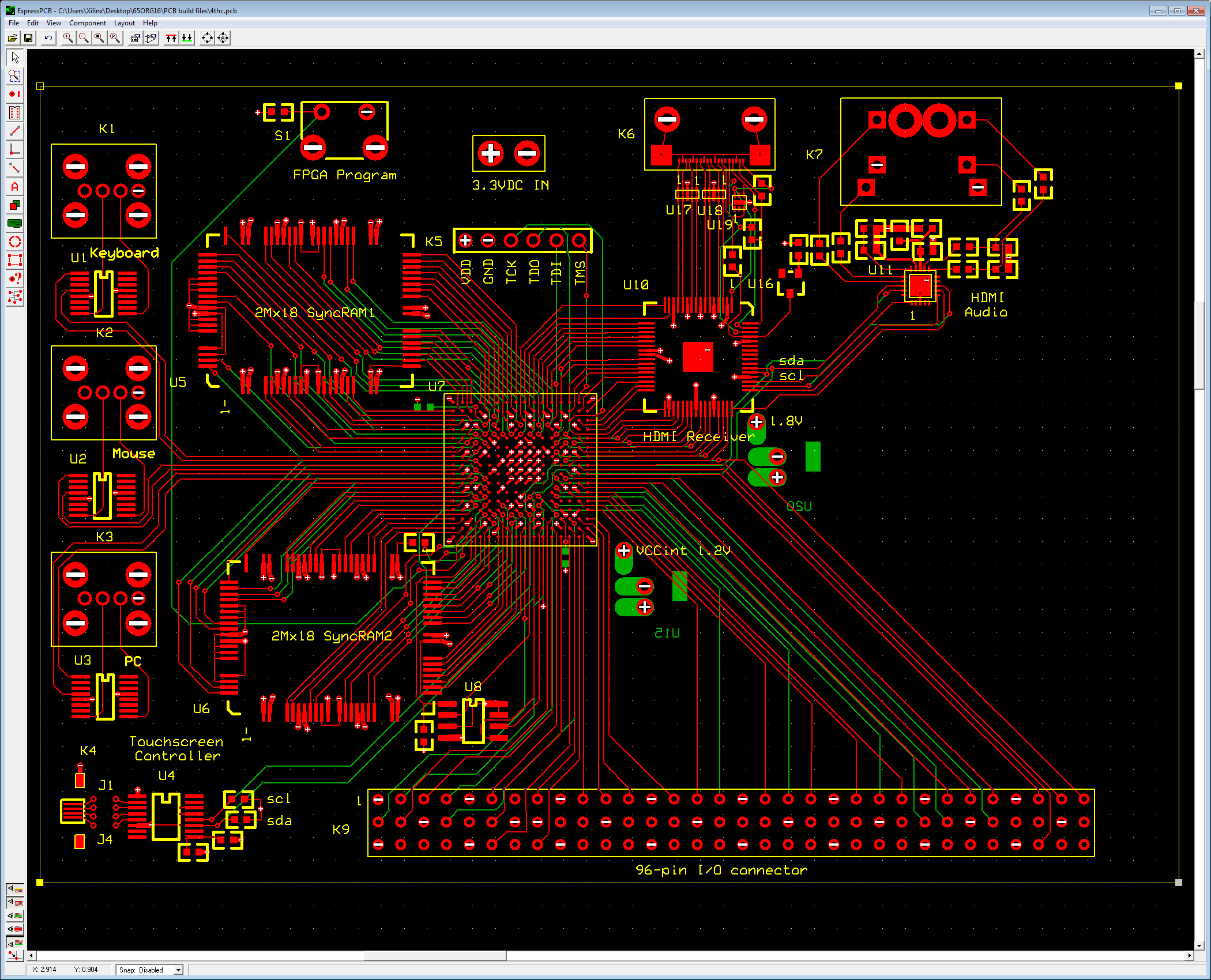

This is how I'll be posting snapshots in the future. Higher quality so every detail is seen. I use SnagIt on extended window preference. It's a few more steps to save a pic, but the end result is worth the effort.
SyncRAM1 now is much closer to the FPGA just like SyncRAM2.
Also, you can see the SDA/SCL I2C lines snaking their way from the FPGA to the Touchscreen Controller, HDMI Receiver and Audio Codec. That's abit daring and we shall see if it works.

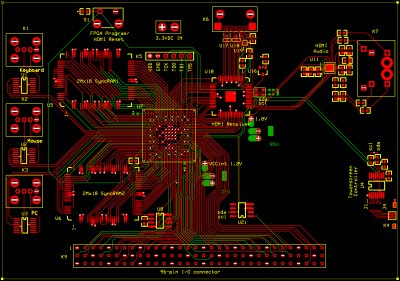

Very close to preliminary finish. All the pins are used up so I can't experiment with the wireless transceivers or SD card.
The board size has shrunk from 6"x3.5" to 5"x3.5", now the 3rd saved iteration.
Still need to finish up some extraneous pins from the HDMI audio IC and HDMI receiver.
Will probably move the HDMI audio section to the right side of the board away from the HDMI connector.
Also, the touchscreen controller will be moved to the right side and I'll try to center the main connector.
Need to add lands for bypass cap's.
Overall, I am happy with the progress of the past 2 weeks.
The very next thing I need to do is rewire the clock pins on the SyncRAMs so that they go to an FPGA NCLK or PCLK pin.

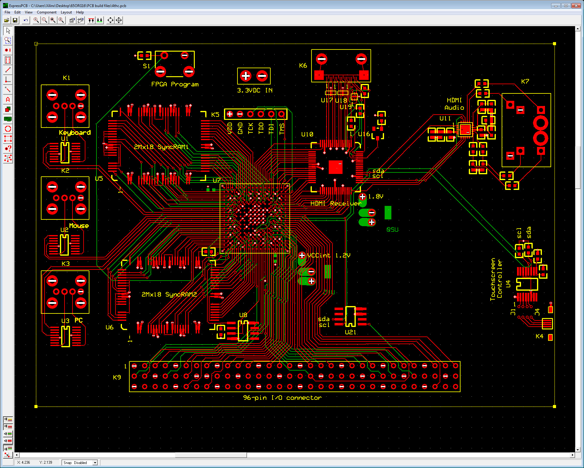

The IC/connector placement is solidified. Still need to get those P_GCLK & N_GCLK pins in order...

Unless you are working to provide clock deskewing for your clock distribution, you do not need to use a global clock pin to drive the clocks to your SyncRAMs. You may want to read over the application note that I've attached. It describes a way to use a DCM to remove the skew between the active edge of an external input clock source and the active edge of that clock at an external device such as your SyncRAMs. Appropriate deskew of your external clock distribution networks can allow you to operate closer to the theoretical limits of your devices. It can also be applied to the internal clock distribution networks in order to allow higher internal operating frequencies.
The attached application note is primarily targeted to the Spartan 3/3A families, but the techniques described are equally applicable to the Spartan 6 family. The Spartan 6 family also supports dynamic control of the input delays for each I/O pin. This is how the parts implement the SDRAM interfaces, which require adjustment of the input delays of each data path.
I try to avoid using the techniques described in the attached application note, but I think you may need to consider their application because of your ambitious performance goals for your new project. I have applied the techniques described on several designs, but in more recent personal/hobby designs, I've just opted to go for lower performance in order to avoid applying the techniques described.

No plans for deskewing, but I've often had the need to implement a DDR FF for a global clock net going off of the FPGA. I had thought this was only possible through a global clock pin?

I was able to work one more trace out from the FPGA, I think this will be it though...
Currently, the main clock which feeds the FPGA is the pixel clock generated by a PLL inside of the ADV7611 HDMI Receiver from an external 28.636 MHz crystal which I have yet to add.
To take the most advantage of this 1 extra FPGA pin, I thought of adding another IC to the I2C bus. It's a programmable frequency synthesizer in the form of an 8-pin DS1085L. It has a limitation of a max frequency of 66MHz, but not so much a limitation since it can generate thousands of frequencies starting at 4.1kHz. Together with the Spartan 6' own BASE_PLL / ADV_PLL, this will make for a very flexible frequency generator. Also, when programming the DS1085L to change frequencies, there are no 'runt' pulses that could lock-up some pieces of hardware.
The output of the DS1085L will go back to the FPGA on this K1 Controller board and also to pin 50 on the K9 connector so it will be available to the other PVBs to add flexibility.
