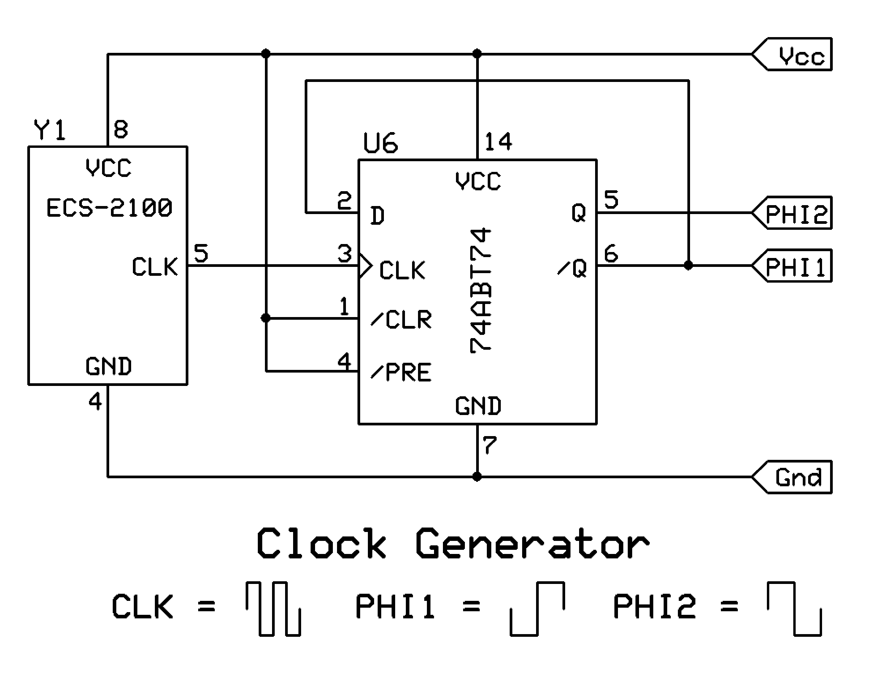

In order to interface to a development board, I need to be able to route the 816 bus off the board unfortunately.
In which case, I suggest you look at using drivers for the address bus (74AC541, for example, two required) and a transceiver (74AC245) for the data bus. The drivers and transceiver will help to mitigate the effects of bus loading. Note that everything should be on the "downstream" side of the drivers and transceiver to avoid inadvertent signal skew. Bus termination will likely be necessary to control ringing, an area where you may have to experiment to achieve satisfactory results. Thevenin termination may suffice if the aggregate bus length isn't too great.
You will also need a latch for capturing the bank address (74ABT573 or 74AC573, the former is the faster part) and a two-phase clock generator to control the latch and transceiver output-enables. See attached clock generator schematic, as well as bus logic example—
ABx and
DBx connections on the drivers, latch and transceiver are connected to the MPU's address and data bus pins, respectively.
Note that use of the clock to determine when the transceiver should be active doesn't automatically meet the requirement of not reading or writing during Ø2 low. That is accomplished by qualifying
RWB with Ø2. Such qualification is not necessary with the W65C21x, W65C22x and W65C51x, and
should not be applied—connect
RWB of these devices directly to
RWB on the 65C816.

File comment: Two-Phase Clock Generator
