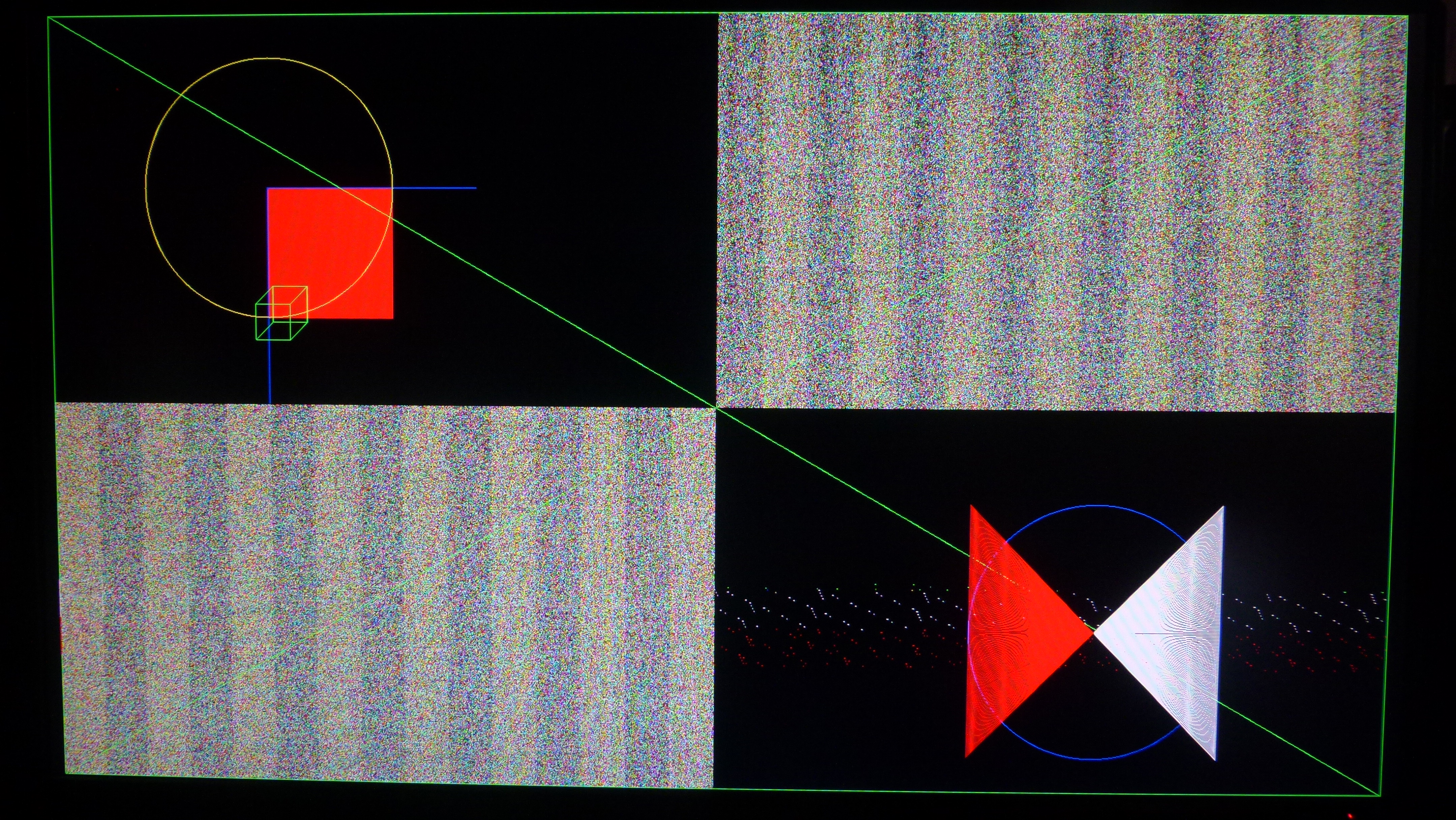

PostPosted: Wed Jan 29, 2014 4:44 pm
Now I have 4 PVB's outputting the same video.
With the pixels so small and each board adding noise in the form of maybe a 1/4 pixel, it becomes obvious now that this noise is going to be the enemy at this high resolution. I'll add in all the .1uF bypass caps on every board now and report back.
Here's a pic. Still extraneous data being written to the SyncRAM which is most visible in the bottom right. The noise I speak of is most noticeable in the red triangle. It almost appears solid red. Hopefully bypass caps will fix this.
PostPosted: Tue Feb 04, 2014 7:49 pm
The extraneous pixel problem has been fixed. It was a hardware timing problem with the SyncRAM R/W signal, it was late by one cycle. The hunt for the problem revealed to me that I could remove a state from the line plotter as well. This is a full cycle, so it effectively doubles the plotting time of the hardware state machine....
Strange that it only reared it's head when I plotted consecutive lines:

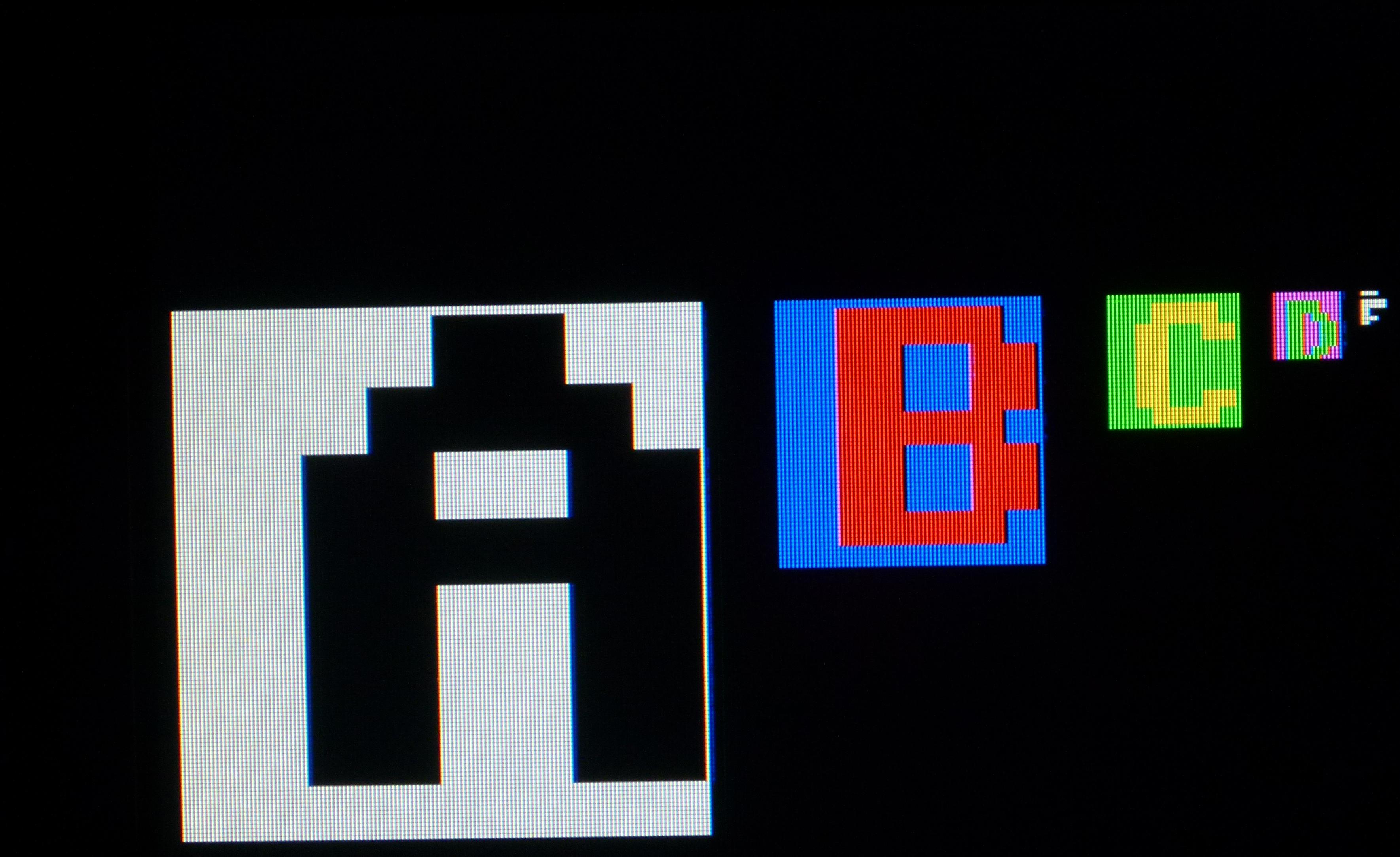

PostPosted: Wed Feb 12, 2014 1:48 pm
Got the copy/paste working, but reading the SyncRAM was only successful at 1/4 speed of the pixel clock, i.e. ~37MHz. It is a state machine that does back-to-back Read/Writes, 2 cycles per operation. 1 cycle to set up the address first, the second cycle to read or write the data as according to the data sheet.
If a write is successful at 74MHz and not a read, I suspect the FPGA data-in lines need to be delayed by an amount less than 1 cycle. I will have to investigate on delaying the IOBs on the FPGA.
In this pic, the upper left has a white triangle which was done by a single step radar sweep of the line generator. (The other triangles are double stepped). An upper portion of that is copied/pasted to another region of the screen. The second 50x50 pixel copy/paste is from the center of the upper left circle. It has been copied to the bottom right of the screen.
The purple circle fill is not successful by plotting concentric circles of decreasing radii...
As far as what is next in 1920x1080 mode, I think a hardware text plotter is in order after I get the Read/Write working @ 74MHz.
I don't think sprites will be possible as 98% of the RAM is used for the screen. However, 1 more mode is possible with 2 FPGA PROMs available. That will be in another thread later.

I almost broke the machine. I decided to stop progress for today and save. I should've saved my first success...
I had success with 128x128, 64x64, 32x32, 16x16, but the original 8x8 I have a problem melding with the current logic. I'll work on it, also a left/right alignment issue...
The camera cooperated with me today for a close-up of pixels, looks like some noise maybe, not visible to the naked eye.
You're idea of a pointer, like for use with a hardware mouse pointer, shouldn't be too difficult using the blockRAM.
Currently, I'm saving the blockRAM for use when I have a hardware ellipse plotter. Then the vector line drawing and real 3d animation begins.
File comment: 8x8 not working yet on 1920x1080, left corner

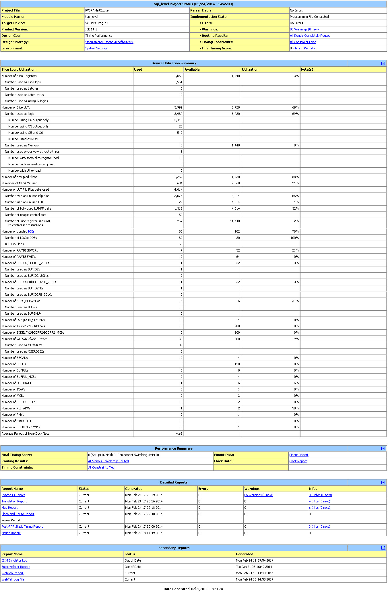

Some of the device usage seems to have gone down:
PostPosted: Mon Feb 24, 2014 11:50 pm
Alright!
Got several problems fixed now on 1 PVB.
Today I fixed the Verilog character plot code so it will plot 5 different sizes, x & y the same. Not too interested in using up even more resources for different x's & y's (i.e. 16x8, I pursued it for awhile).
So the character plotter can now plot 8x8, 16x16, 32x32, 64x64 and 128x128.
Also, I was able to increase the speed of the part of the module which plots circles/lines/fill/blit/plot pixel to 74MHz. Major success! :lol: :lol:
Camera not as cooperative as the other day.
Char plotter plots characters of different sizes/colors/background colors.
Blit copies and pastes to a different portion of the screen.
White circle of radius 200 scrolls left to right.
Snapshot!
File comment: Updated resource usage.
File comment: Character plots, copy/paste and scrolling horizontal circle
