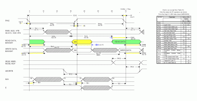

On the topic (or should I say off-topic :D ) of '816 timing, I agree the WDC timing spec is conservative. Also not terribly easy to comprehend!
Allow me to re-post (from this thread) my own edited version of Figure 4-1 from the '816 Data Sheet (Sept 2010 version). To put all the various delays in perspective I squeezed and stretched things so that the diagram is now approximately to scale along the horizontal axis. 5V operation is assumed.
[Edit: fix image so it will enlarge]
BTW, I now have an 18 × 24 version of that on my office wall. :lol:

According to the '816 data sheet timing specifications, there's only 30ns guaranteed for tACC on a 14MHz '816. tADS can be as high as 30ns and tBAS can be as high as 33ns, eating up nearly the entire phase-1 time. The read data setup time tDSR (the amount of time data has to be ready before the fall of phase 2) is specified to be 10ns max. Glue logic further eats into the time budget. Fortunately, actual parts are usually much faster than the specifications say, and you're probably also not running things at the upper temperature extreme where they're the slowest. Otherwise, 55ns SRAM would not stand a chance of running on an '816 at 14.7MHz, according to the specs.
You should not put too much faith in timing information in datasheets. If timing is tight, you should measure.
In my case, by logic analysis I found that, even though address valid should come close to phi2, it actually comes shortly after phi1. Bank address (via the databus) same thing. However, for the 816, the inevitable latching of the bank address consumes some of the timing budget, and makes it tight depending on the SRAM's address decoding strategy.
It is always safe to go with the datasheet, but there is often far more performance that can be squeezed out beyond what the datasheet guarantees. Without measuring, it is impossible to know how much. It won't be worse than the data sheet says though.
How much actual delay (in ns) did you find, compared to the datasheet? It would be nice to find out that the margin between the datasheet and the reality is huge.
On the '816, the bank address byte is specified (the reality might be different) to come out at about the same time the 16 bits of the address bus do; but the latch will take a few ns of propagation delay. It is a transparent latch though, meaning that the bank byte can still come through long before the rising edge of phase 2. It doesn't wait for the edge.
True. But it should be interesting to know that 55 nS SRAM is borderline at 14.7 MHz. Extrapolate from that.
55ns just means that it's guaranteed not to be any slower than 55ns. It will probably be faster, even at the high temperature extreme and the low end of the voltage range (4.75V?). Bring it down to room temperature and up to 5V, and it's definitely faster than 55ns.
