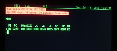

POC V1.1 achieved 300 days of uptime in the early AM hours. :)
File comment: 300 days of uptime.

For those keeping track, Dec 10 will be the year date. Let's home for stable power through then.
 Post subject: Re: POC Computer
PostPosted: Mon Oct 07, 2013 12:38 am
Posts: 8404
Funny you mention that. The power supply that runs POC is plugged into the 1.4 KVA UPS that keeps our two servers going. Unless a protracted outage (>1 hour) occurs, loss of power isn't likely. If anything, me doing something boneheaded and crashing the unit is a more likely scenario.

I've been wanting to make some changes to some of the BIOS primitives that would compact the code and make it run a bit faster, but held off on doing so in order to see how far I could push the uptime. I decided to bring the uptime saga to an end, as I also wanted to change a SCSI primitive function in a way that would/might allow me do an ISL from tape. So I decided to burn a new ROM and try it out.
POC V1.1 had reached 306 days, 13 hours and 21 minutes at the time of shutdown. :(

I figured that 306 days demonstrated that hardware stability isn't an issue. Making it a full year would be something to crow about, but trying to do so was impeding progress.
