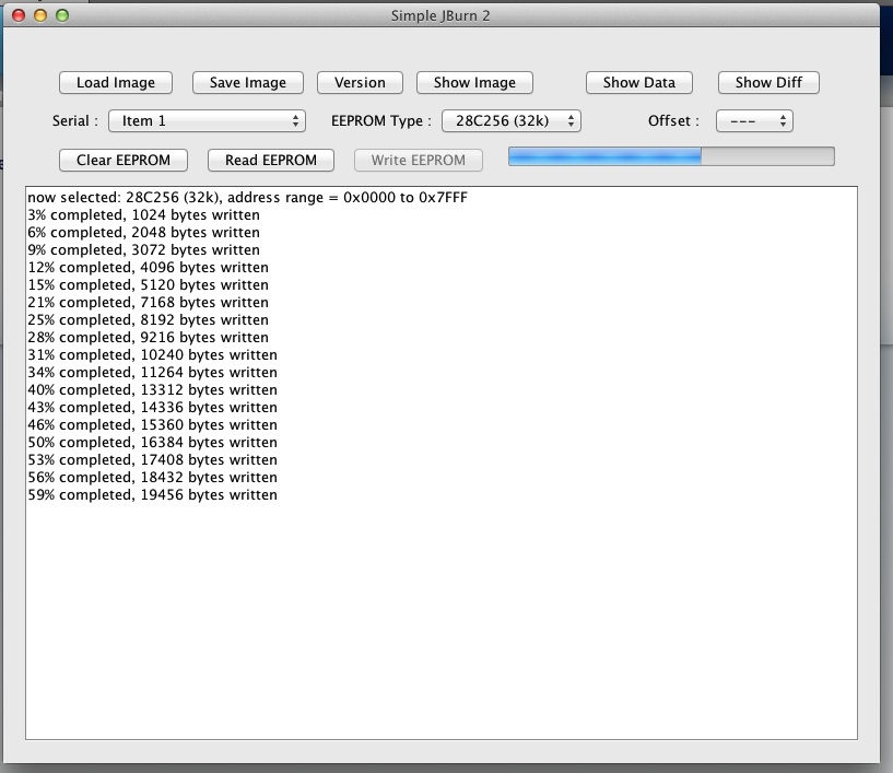

I'm working on a new version of the java GUI tool. This time with cleaner code base and "tadaa..." a progressbar. Some parts are already working, but there's still a lot of work to do. If there are additional feature requests, then this is the perfect time to tell me that :-)

Ok, finally had a chance to try out the new version (sold another board, went to test it after assembling). I love the new version, but.. The DIFF feature doesn't work. Freaked me out at first. Said there were quite a few bytes mismatched. Then I realized that when I click DIFF, nothing happens on the Arduino. Loaded the old version, loaded the same image file, hit DIFF and the Arduino lit up for a few seconds, then confirmed that the hardware worked, and the new version did in fact write the correct data. :)
Simple fix, I imagine. Thanks for the excellent work on the new app.
PostPosted: Thu Jul 18, 2013 7:12 am
Posts: 183
OK, I changed the semantics. Sorry for that. In the new version you have to load an rom image and you also have to load the data from an eeprom. after that you can make the diff. In the old version of the software a "diff" has always initiated a load of the eeprom data.
Both versions have their advantages, but I can change it to the old semantics.

OK, I attached an updated version of the software to this post. This one works like the first version of the JBurn utility and reads the content of an eeprom every time the "diff" button is hit.
I'm currently thinking about changing the JTextArea field of the GUI to a JTextPane. Then it would be possible to use colors and I could provide a visual diff of both images. Would this be an interesting option?
