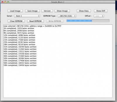

That's a shame the status will take so much work to implement. I was thinking something simple like, I hit the Write to EEProm button, it puts "Programming" in the text console, and then after each 1K chunk gets sent to the Arduino buffer, it adds a "*" after the word programming, would that be easy enough to implement? Just a quick call to another function that can write that there? I never did get along with Java programming myself..
Thanks for the work on it!
Re: 28Cxxx EEPROM Programmer
The problem with showing the progress is, that I put the "write eeprom" code directly into the event-handler function. That means, that the GUI cannot be updated while the function is executed. There is a progress every 1k written to the eeprom for a long time in the tool, but the output is only showing up in the TextArea after the function returns.
As I started with the JBurn tool it was a quick hack for testing, so I never thought about things like this. I will try to create some kind of progress dialog that has an own thread for showing information during the write process.
I'm working on a new version of the java GUI tool. This time with cleaner code base and "tadaa..." a progressbar. Some parts are already working, but there's still a lot of work to do. If there are additional feature requests, then this is the perfect time to tell me that
Mario.
Mario.
Ok, ready for beta testing. The tool still needs the RXTX library installed separately.
Please report bugs and feature requests.
Mario.

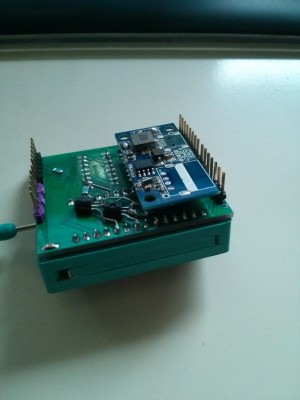

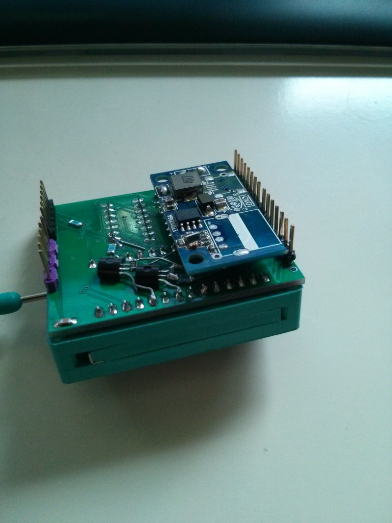

Thanks you guys for the hard work!
I got a board from UnaClocker a few days ago. My old TOP2049 died, but the best part is I can finally program in Linux!
With a few transistors and a boost supply I've added the ability to program SST27SF512 and W27E512 chips. I happen to have a bunch of these chips already. It should also do 27C512 but I haven't tested that. If I could get the source for the latest JBurn I can post a diff of the changes I've made, along with the Arduino sketch for anyone that is interested. I have it working with the old java program right now.
With the bps at 115200 it takes 12 seconds to program, not bad! Is there a reason it was set to 57600 before?
If there is some interest I could also update the schematic with my changes.
