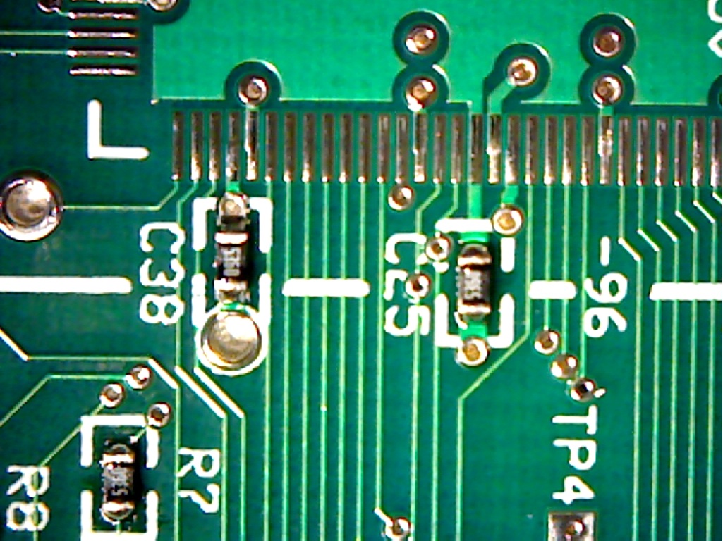

Using a fresh board from an old 6502SoC design, I needed to test soldering in some 0603 536ohm resisitors. For solder paste, I'm using ChipQuick part # SMD291AX10.
The first run wasn't very successful, as I attempted to use their fine tip dispenser.
You can see some before and after pics using the USB scope.

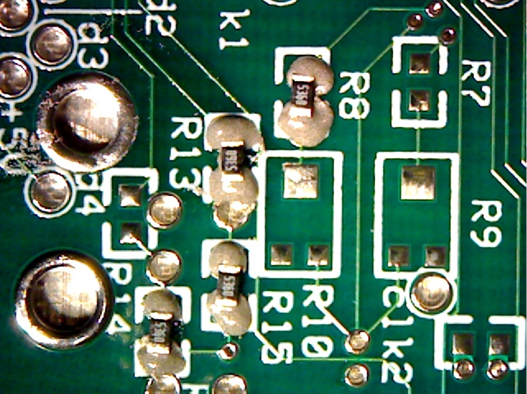

PostPosted: Sun Jan 11, 2015 8:59 pm
Now with my 'special' needle dispenser, I have a much better result.
I didn't think to do a before pic, but it is about 1/3 of the solder paste in the above 'Before' pic.
I hardly put anything down but it still looks like a tad much!
I can say I am absolutely amazed at how the parts centered themselves due to the solder reaching its melting point and the surface tension of the liquid solder. :lol:
