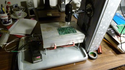

Well, I was unable to learn the Eagle PCB payout program in any reasonable amount of time, so I gave up on this idea. But I still pursue mount a 256-pin 1mm BGA Xilinx Spartan 6 LX25 device.
I have purchased the USB microscope mentioned earlier. Note the megapixel count has gone up from 2 or 3? up to 5MP.
I placed it about 2 inches above the hotplate during heating up to 265degC. I was expecting fogging or melting or something, but no such bad luck.
A neodymium magnet was placed behind the non-slip covering, that's what's keeping it on the metal cookie box. I would like to make a wooden jig tomorrow so the camera doesn't move in relation to the hotplate.
As it is now, this is what I'm working with. The 2nd Al alloy plate was placed on top so I could do a quick pic, since the bottom plate was still up to temp.
I just plugged the PID controller real quick to make it look live.
