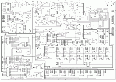

OK, I still find it difficult to navigate all the files listed on that site. But I did a google search of the site and found this text file. It says "this SCH is valid for the 3008 to 3032. It is just a matter of placing the right 'jumpers' and RAM-ICs."
I have not reproduced the entire text file here, but the author, Ruud Baltissen, also says, "You may copy the schematics for NON-commercial use. I hope you enjoy it. If you use it, just give me at least some credit like "Stolen from Ruud :D "

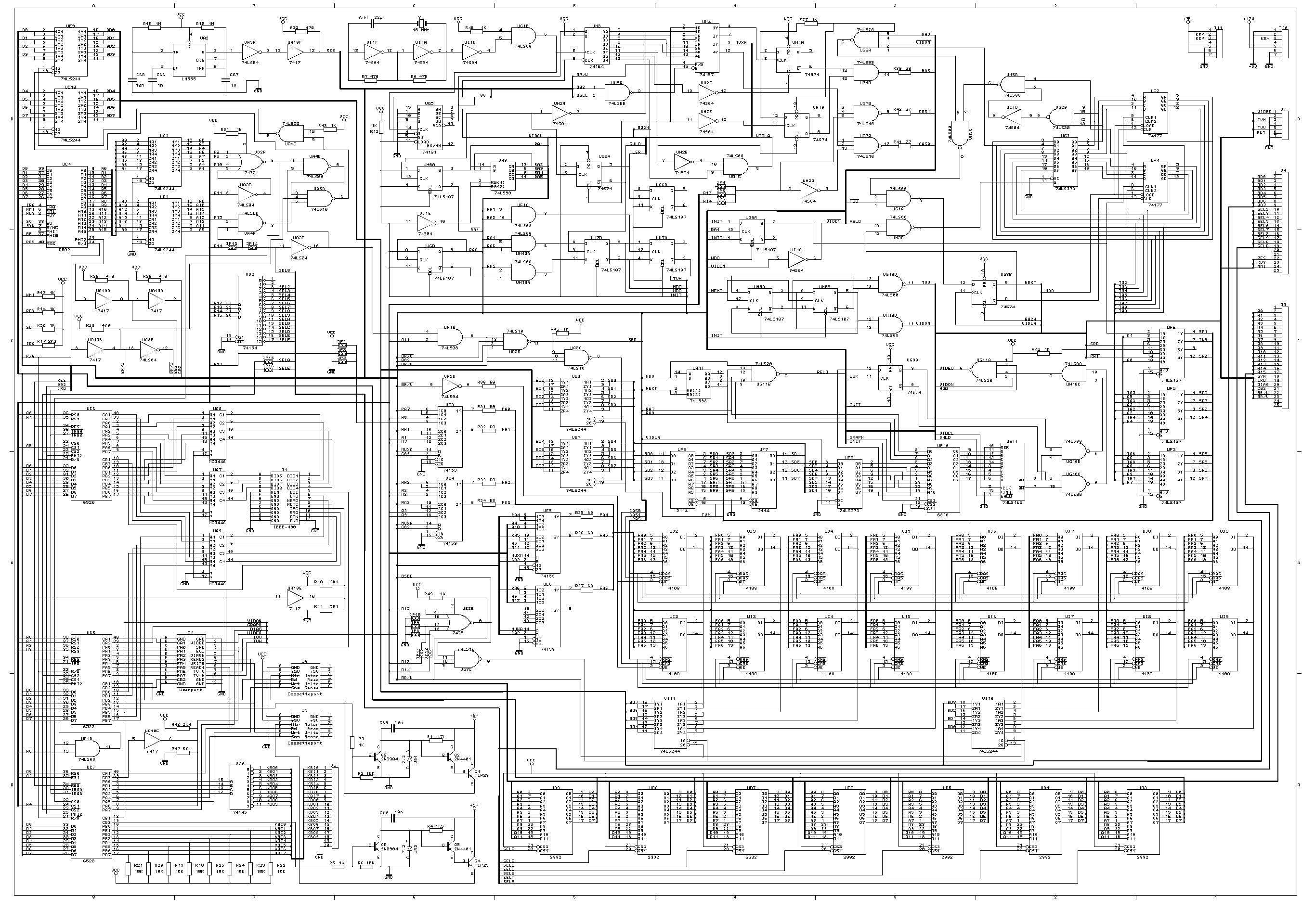

The accompanying schematic is http://www.zimmers.net/anonftp/pub/cbm/ ... e/3008.gif The image is rotated 90 degrees, so I'm posting a normal version below.
Assuming this matches your 3032, then you may connect a reset pushbutton from ground to the 10 nf capacitor on pin 2 of the 555 timer IC. BTW, is your multimeter a digital type, or analog (with an actual needle and semi-circular scale)?

----EDIT: I put the reset switch; it seems that somebody in the past did the trick, since there was evidence of solder on C68 capacitor. Well, it didn't help. Then screen remains black even with the reset button. At least we have one information more: the reset doesn't makes the garbage screen appear again.
