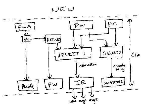

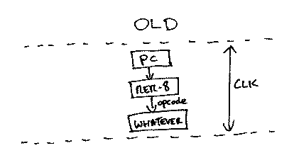

It's a good point, Garth. But, honestly, for this thread I kind of dread the idea of any more explaining! I've gotten a little bit burned out. Maybe that's partly due to reliance on English, which isn't especially well suited to the topic. Short of actual HDL, what's the alternative? If there's to be any further explanation, maybe it'd be worth considering a graphical presentation of the pipeline -- something in the form of the (nonsense) diagram below :?:
How about this. The registers are : PWA, PW, IR. Rest self explanatory. 'Whatever' is whatever Arlet decodes and stores based on the opcode.
Oh, and PW and PWA are sometimes not updated, depending on what part of the 64 incoming bits is copied to IR. I.e. that is not shown here.
Old situation.
Old situation.
New situation.
New situation.
