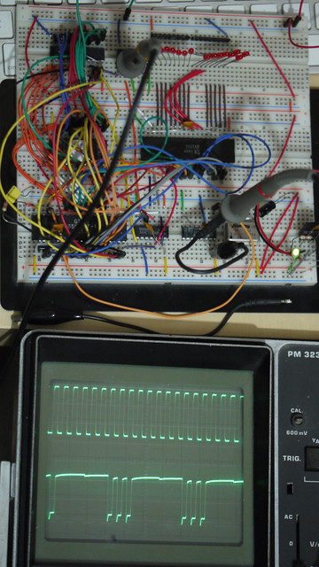

The idea of making a (6502-based) computer on my own dates back as far as 1986 or so, although it never materialized. Lately it came back and developed into a very ambitious project... but the sensible way was to begin with something much simpler and (hopefully) develop fron that.

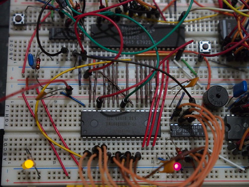

So, in late 2012 I decided to build a pretty simple 6502 device on a breadboard -- with the excuse of teching my students about the underpinnings of a computer! Dubbed SDd (Sistema de Desarrollo didáctico, which is Spanish for "Didactic Development System"), it only used 13 out of 16 address lines (for less cluttered cabling!) and extremely minimalistic decoding, resulting on 2 KB RAM, up to 4 KB EPROM and a 6522 VIA in between (mirrored lots of times!).
Other than that, nothing fancy: originally it had a row of LEDs connected to the VIA's ports (later it had a buzzer on PB7) and a 2 MHz oscillator can connected thru a 4040 divider, in order to select the speed from very slow to overclocking attempts. Here's a picture of it... being diagnosed :?
It went thru several revisions (read: repairs) and even RAMless for a while... but even in such a limited configuration, it could do things like flashing LEDs sequentially or even play the riff from Smoke on The Water! Obviously, I've been learning a lot thru all these "revisions"...
After cleaning up the wiring (once again) I was able to mount the SRAM chip again, and do more useful tasks, like testing SRAM chips of types unsupported by my tester -- all thru the VIA ports, not connected to the regular busses!

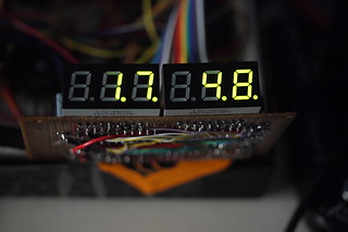

or even running a pretty accurate digital clock, here with the help of a bus sniffer I made, which shows in Hex the bits at the VIA ports (or wherever I connect its 16 data lines) -- just a matter of putting the time in BCD at the ports:

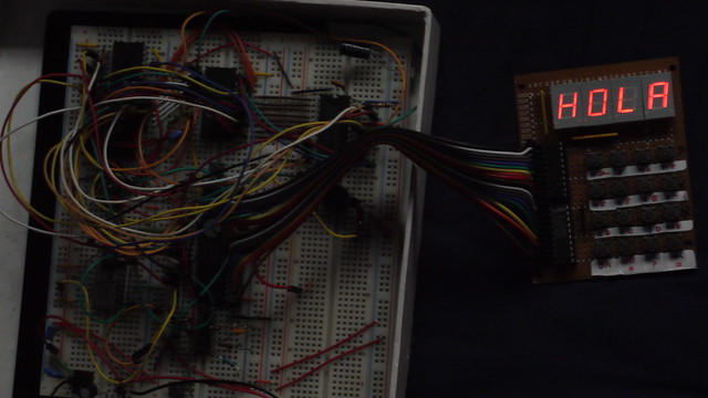

But the final intent of this device wasn't executing ad hoc firmware, but being the first machine to run minimOS, my Operating System in the making -- more about that in a separate thread :D Anyway, I was in need of a more human interface device, so I made (again on didactic purposes) a LED Keypad for some I/O capability. Once again, one of those HD44780-based LCD modules would have been much easier... and cheaper, but this way my students could see multiplexing and debouncing in action :wink: In fact, debugging its driver has been the most time-consuming task of my system's development, so far :| But it works, and here's a pic (deliberately dark to emphasize the displays) of my whole system (computer + LED keypad) saying hello to the world:
you can type numbers on the keypad and actually see them appear (and scroll!) on the displays... :D

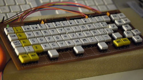

On the peripheral side, there are some things to do... Besides the already mentioned LED-keypad and bus sniffer:
  • A real ASCII keyboard... with integrated 20x4 LCD module. I know, it's pretty easy interfacing to a PS/2 keyboard, and much cheaper... but I wanted to do my own 8)

Nice job. Be careful with those scope probes though. I recommend putting a small wire in the breadboard, and clipping the probes on them, so you don't accidentally bump into the probes and bend the tips.
