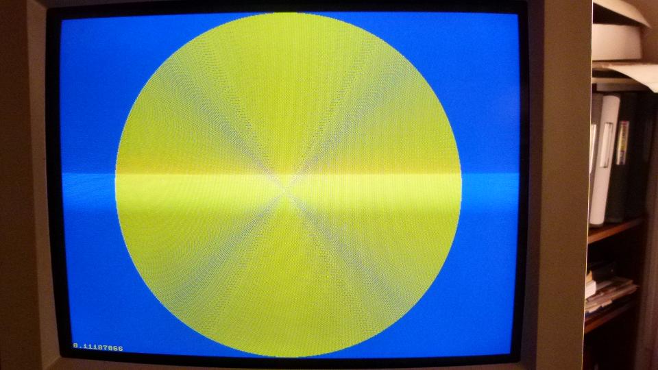

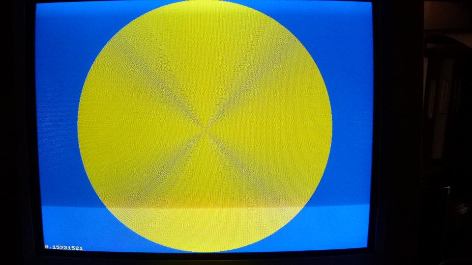

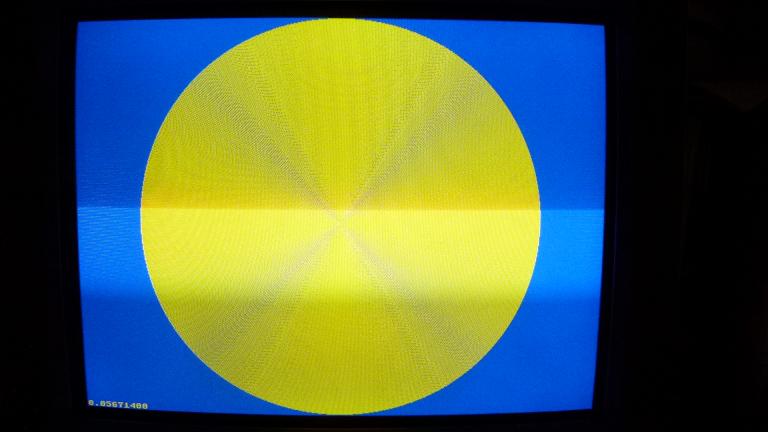

Here are the speed comparisons for the Concentric circle fill (239 circles), showing the speed of the original code on top, the use of 4 65O16.b accumulators in the middle, then 6 accumulators plus some help from Arlet in the final optimization of the software. The number of cycles can be seen to the lower left of each pic.
File comment: Original 65c02 code ported to 65O16.b
File comment: Code utilizing 4 65Org16.b accumulators
File comment: Optimized 65Org16.b code utilizing 6 accumulators

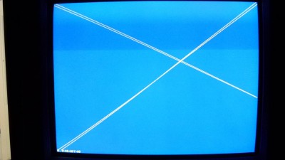

PostPosted: Wed Apr 03, 2013 8:27 pm

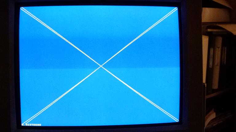

I'm pretty confident it's working. In this pic I plotted 4 lines with the 4 different possible slopes:
1) (5,0) to (635,480)
2) (640,475) to (0,5)
3) (635,0) to (5,480)
4) (0,475) to (640,5)
It's pretty slow though... Time for optimizations!

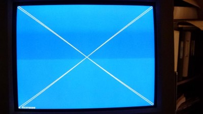

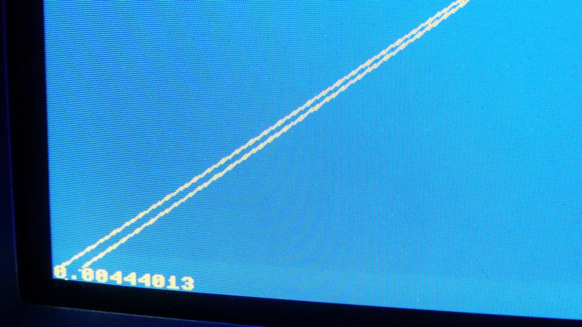

Ok, finally had a chance to plug your code in...
First, As65 has an issue with 'bcc loop1' on line 48, loop1 is undefined. I assumed it was 'bcc loop2' and went forward with testing the speed with the same 4 lines as before with 32+million cycles, whew that's alot!
Looks like DX and DY are skewed for the first 2 lines: (5,0) to (635,480) & (640,475) to (0,5). However the speed is way down to 4+million cycles.
EDIT:I had found 1 'BRA' opcode that the .b core doesn't have but As65 will translate it to a $0080 opcode value, which is undefined. I just now saw a second one and changed them to a 'JMP'. Retesting...
The first 2 lines are still skewed. Now for the lines with the coordinates that have been plotted correctly, they are "sloppier" although cycles for the routine are way down to 444013.
Since I modified your code, I should paste an update so we are on the same page.
Line16.b.asm [4.68 KiB]
Downloaded 47 times
File comment: Anamolies, but good speed. Correct coordinate plotting.
File comment: Coordinate plotting error for (5,0) to (635,480) & (640,475) to (0,5).
PostPosted: Fri Apr 05, 2013 12:23 pm
Posts: 1738
Location: Sacramento, CA
The BCC loop1 was correct. I somehow erased the loop1 label. It has been added back. That should fix the skewed lines. The sloppy lines might be a byproduct of my optimization. There are two sections with comments " dx,dy optimization." Try commenting these sections out to see if the sloppiness goes away. Cycles will increase again, but I have another possible option to fix that.
Two questions about the .b core.
1) Can you do branching (bcc, bne, etc) beyond 128 bytes now?
I have several places where there is this type of code:
bne label1
jmp label 2
label1 next opcode
because label 2 was just beyond the +/- 128 byte window.
2) Does the BIT command now place bit15 and bit14 in the N an V flags?
If the optimizations are causing the sloppieness, I might be able to use the BIT command to improve it.
Will await your further tests.
Daryl
