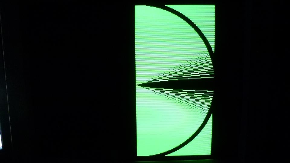

I tried the fill circle by reducing the radius but it leaves holes scattered. My 320x240 display modified the circle routine to draw horizontal lines from top to bottom, using the endpoints calculated by the original circle routine. It runs fast and leaves no holes. I do not have 65c02 code for it but its not hard to figure out.
Daryl
PostPosted: Fri Mar 15, 2013 2:43 am
8BIT wrote:
I tried the fill circle by reducing the radius but it leaves holes scattered...Daryl
Yes, this is what I would've expected too. We have several algorithms donated now. Might be good to check them all out. I just checked out Lee's since I have it in my system already. But you can see also where there should have been some vertical tracing at the very right edge, but there is nothing. And this error eats its way to the center, but the rest seems ok.
Just in case I made an error in the code, I post it... Been a long day at work, but this is some good motivating stuff!

If I understand you correctly, drawing something like a radar sweep? I have line drawing routines that work relatively well, but I think you will still end up with holes.
If you look closely at my circle routine, you see that it only calculates points over a 45 degree arc. It then just uses the mirror image to calculate the other 7 arcs that complete the circle.
x = 0-45 - calculated
x1 = 90 - x
x2 = 90 + x
x3 = 180 - x
x4 = 180 + x
x5 = 270 - x
x6 = 270 + x
x7 = 360 - x
By choosing two of the end points in pairs, you just draw a horizontal line which is much faster than a sloped line.
x1 to x2
x to x3
x4 to x7
x5 to x6
This can also be done with vertical lines equally fast.
Hope this helps.
