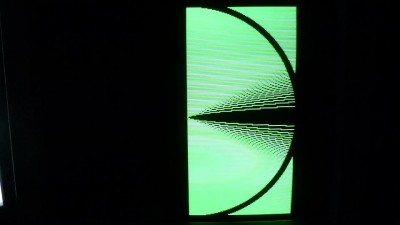

I tried the fill circle by reducing the radius but it leaves holes scattered. My 320x240 display modified the circle routine to draw horizontal lines from top to bottom, using the endpoints calculated by the original circle routine. It runs fast and leaves no holes. I do not have 65c02 code for it but its not hard to figure out.
Daryl
PostPosted: Fri Mar 15, 2013 2:43 am
8BIT wrote:
I tried the fill circle by reducing the radius but it leaves holes scattered...Daryl
Yes, this is what I would've expected too. We have several algorithms donated now. Might be good to check them all out. I just checked out Lee's since I have it in my system already. But you can see also where there should have been some vertical tracing at the very right edge, but there is nothing. And this error eats its way to the center, but the rest seems ok.
Just in case I made an error in the code, I post it... Been a long day at work, but this is some good motivating stuff!

PostPosted: Fri Mar 15, 2013 10:34 am
Maybe a better way would be to draw lines from the center to the circumference.
Daryl you wouldn't happen to have Bresenham line algorithm would you?
EDIT: Sorry, I missed this part of your post originally:
8BIT wrote:
...using the endpoints calculated by the original circle routine...
Daryl

If I understand you correctly, drawing something like a radar sweep? I have line drawing routines that work relatively well, but I think you will still end up with holes.
If you look closely at my circle routine, you see that it only calculates points over a 45 degree arc. It then just uses the mirror image to calculate the other 7 arcs that complete the circle.
x = 0-45 - calculated
x1 = 90 - x
x2 = 90 + x
x3 = 180 - x
x4 = 180 + x
x5 = 270 - x
x6 = 270 + x
x7 = 360 - x
By choosing two of the end points in pairs, you just draw a horizontal line which is much faster than a sloped line.
x1 to x2
x to x3
x4 to x7
x5 to x6
This can also be done with vertical lines equally fast.
Hope this helps.

Guess I should explain the method for the line drawing routine. I thought this up myself about 30 years ago but doubt that it's an original idea.
First set it up so you increment from x1 to x2, swapping the two points if needed.
You calculate the difference between x1 and x2, store it in dx. Do the same for y1 and y2 stored in dy.
Test for vertical or horizontal lines, and move to optimized code for either.
Now test to see if you will increment or decrement y and point to the proper code section.
Create new variables ix and iy and set to zero. Now, simply add dx to ix and if it carries, inc x1. Then add dy to iy and if it carries, increment y1 (or decrement based in the test above). Plot the new x1,y1 point only when x1 or y1 change.
Keep adding dx to ix and dy to iy until x1 reaches x2.
The loop cycles more times but since there is no multiplication or division, it runs quite fast.
Daryl
PostPosted: Fri Mar 15, 2013 2:32 pm
Awesome. That's all I need is the code. I can work with that and adapt it. Again, thanks a million!
