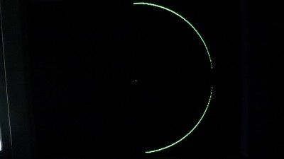

Ugh, not so easy to convert 6502 programs to 65Org16!
I successfully converted Lee's Square routine made for the 6502.
But I have a headache from trying to convert his SquareRoot routine.
EDIT: Ohhh, I found a fast routine here I'll try to convert! It works in MK's assembler/debugger, but there is no remainder, so testing sqrt(13)=3.6 = 3. Not even rounded off.
Yes I'm going for circles, but I need some code now! I can't afford weeks of figuring that stuff out. I never learned C.
I already have the Square routine, all I need is the SQRT and I'll have something I hope.
Maybe I will have to take some time converting Bresenham line algorithm to assembly. After these 2 algorithms, circle and line, the sky is the limit.
I just now realized (even after I was celebrating! ) I had to reset the origin after plotting each and every pixel! WOOOO!
EDIT: It's still not 100% because I was expecting a 1/2 circle on the right side only, but I may learn from the mistake!

EDIT: Tightened up the assembly code, same result except for the center pixel.
